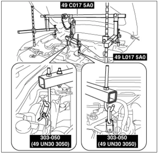

We have all the parts to do it apart from the stupidly expensive engine support tool Mazda says to use in the instructions on how to do the fix

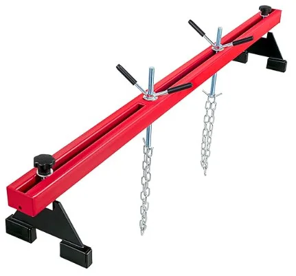

I'm wondering if anyone else has used an alternative to that support tool .. something like this (we would need to get this shipped to Canada from UK)
Laser Tools 8749 Deluxe Engine Support Beam 500kg
For something like this would cost around $500 CAD compared to the $5000+ for the official Mazda tool

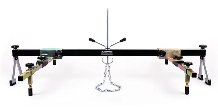

Or this one .. more pricey
https://www.ecstuning.com/b-schwabe...ansverse-engine-support-bar/009595sch01a~sch/

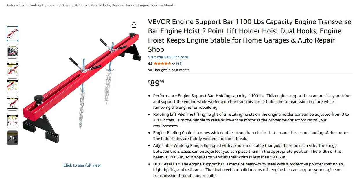

There are cheaper ones on Amazon like this
VEVOR Engine Support Bar 1100 Lbs Capacity Engine Transverse Bar Engine Hoist 2 Point Lift Holder Hoist Dual Hooks, Engine Hoist Keeps Engine Stable for Home Garages & Auto Repair Shop : Amazon.ca: Automotive

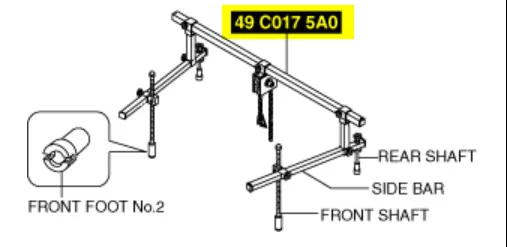

I saw this mentioned on other sites in regards to the extra legs on the official tool "The Mazda fixture has legs up front to prevent movement and also additional support" .. so I'm concerned the cheapy two leg version wouldn't work so well.
