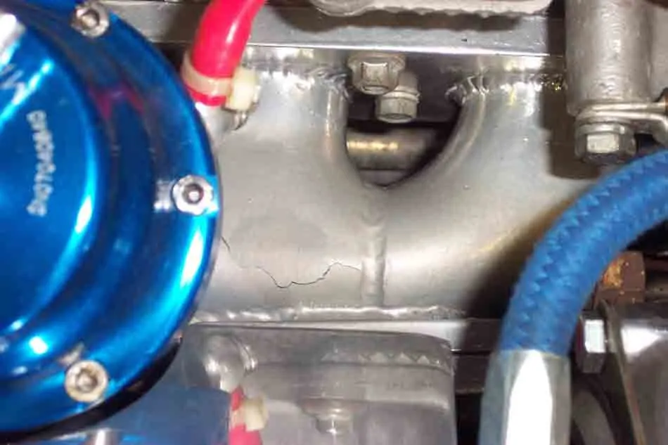

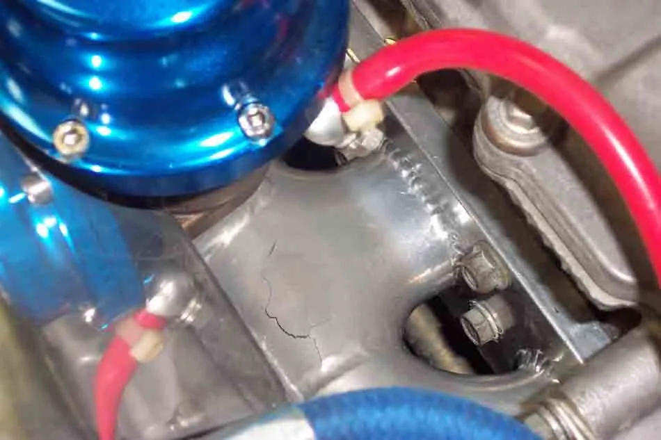

any 1st gen sleeper owners having issue with the ceramic coating on the mani flaking off? i talk to beau about it and he said it shouldn't have and it's garaunteed so send it back and he'll have ut redone...well i really can't do that i need the car and i can imagine that it will take a while....anyway, i was thinking of doing mani wrap but i've been reading that holding the heat in lile that is not such a good idea, especially on headers, any suggestions ideas...the mani looks like crap now....:(
I went to show a guy at work today my new installation. Opened up the hood and WTF??? Same thing is happening to me! (pissed)
it suckx....
It sure does. And what's a person gonna do? Like you, it's my daily driver. It's not like I can just park the car, take everything apart and send the mani off to get recoated. :mad:
well, i painted the area, not to bad...but i'm thinking i'll put header wrap around it until i can send it back, or even have a local coater do it...maybe beau will reimburse me??? what are you going to do?
Well I bought this kit from another board member, not directly from MAM so I guess I'm stuck with it, whatever I do. Strange thing though. The guy I bought it from said he put about 8000 km on it. I haven't even put on 1000 and this happens.
I'll live with it for now and see what there is locally for recoating. Major PITA tho'. What did you use for paint? You got any pics of the cracking and then after you painted?

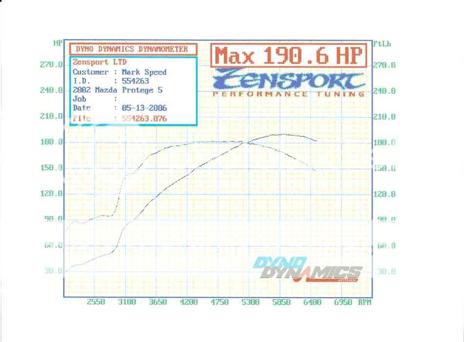

Well I got the temp thing sorted out, it was just a calibration issue thank god. I was also experiencing some severe bucking, particularly in the lower gears when I really matted the throttle. We have since sorted this out also and here are my latest dyno results... :)

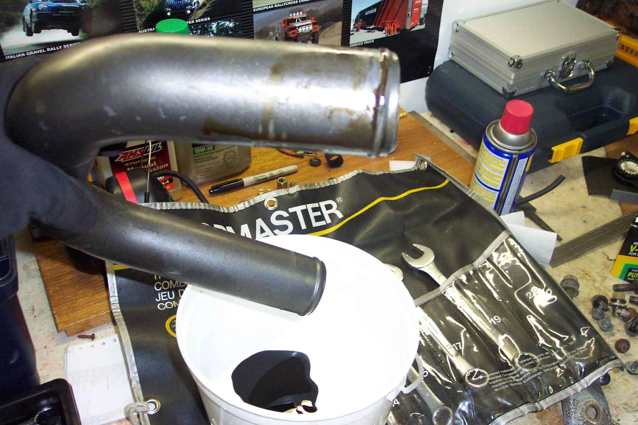

Went for a cruise out to the West Coast of the island and back yesterday. No problems at all except for the car didn't really seem to have the punch under boost that it has had earlier. I attributed it to the hot weather. (It hit 34 celcius yesterday) Got home, parked the car and everything seemed fine. Got up to go to work this morning, pulled the car out of the garage and then went back in to get the garbage and that's when I saw it. A puddle of oil on the floor. I'm like WTF??? I go back out and shut off the car, open the hood and there is oil on just about everything south of the valve cover gasket. The turbo itself looked clean, but there was oil on the oil return line, down-pipe/wastegate-pipe, block, transaxle etc. I pull the dip-stick and the oil was at the low/add mark. I'm thinking this is not good, but I quickly restart the car and drive it back into the garage. Now my mind is racing, what could this be, where is the oil coming from? I unplug the MAF and then disconnect the intake pipe from the turbo housing. The inside of the pipe is covered in oil and there is a little pool sitting in the bottom of the turbo inlet. Now I'm shittin', but I gotta go to work, so I call a cab and go. When I got home I disconnected the U-pipe on the passenger side of the intercooler and this is what I found. (See attached pics) Has anyone had this happen to them? I'm thinking that the seal is gone, leaking oil into the intake. Everytime the BOV released, it was spewing a spray of oil, which at highway speeds was being sprayed all over everything else in the engine compartment and underneath.

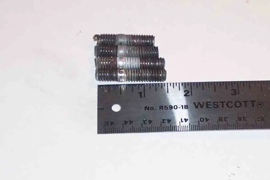

Okay so I have removed the turbo assembly from the downpipe/exhaust manifold and shipped it off to Kinetic Motorsport for repair. It sounds like I was getting too much oil to the turbo and the info I have been able to get is that all GT28RS turbo's should have a .040 oil restrictor in the supply fitting. I'll be making sure there is one in there now!
In the process of removing the turbo, one of the studs in the exhaust manifold wound out. I have never installed a stud before and need to know how to do it. Also, should I be putting loctite on it?
All help much appreciated.

I did some searching around and found out about the "2 nut" method for installing/removing studs. I took out the remaining 3 (two of which were loose anyway) and this is what I discovered, no consistency in length...?
I'm going to replace all 4 with the shortest length for ease of reinstallation.

just so you know, two of the studs are short on purpose. Because of the shape of the turbo, they can't be full length through two of the holes, because they will hit the turbine housing, and you'll never get a nut on.
