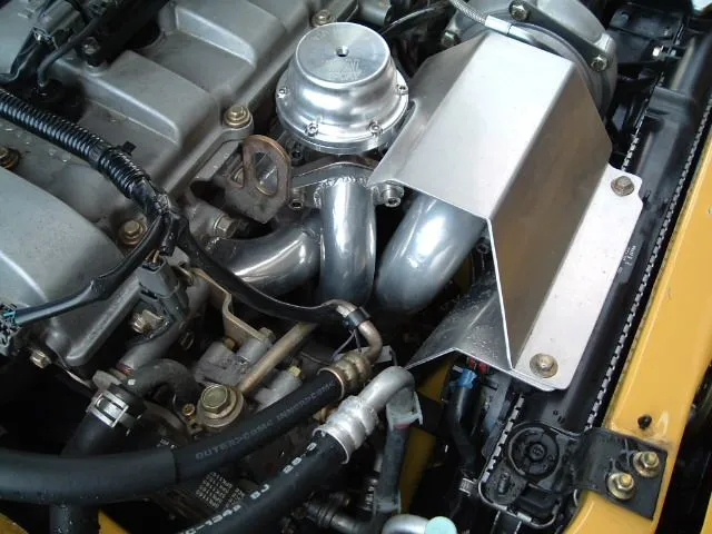

I do have another question though, regarding the heat shield. I thought I read somewhere that it is actually a two-piece shield. Is this correct? If so, does anyone have a pic of the lower section? I have the top piece.
Thanks
mspeedP5 said:
Well tomorrow is the big day! I'm driving the 2 1/2 hrs to ZENSPORT to get the car there for 9:00 am. I can hardly wait!
Thanks
You can see the lower shield here in this picture.

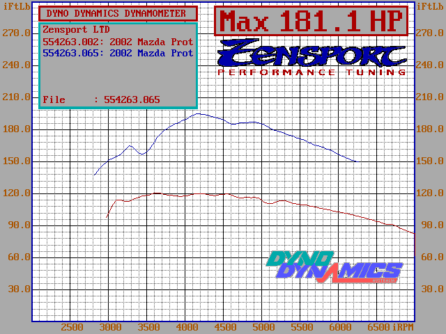

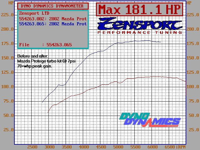

Dyno Results...
HP
TQ
Note: Baseline was done with Ractive 4-1 Header and Short Ram Intake.

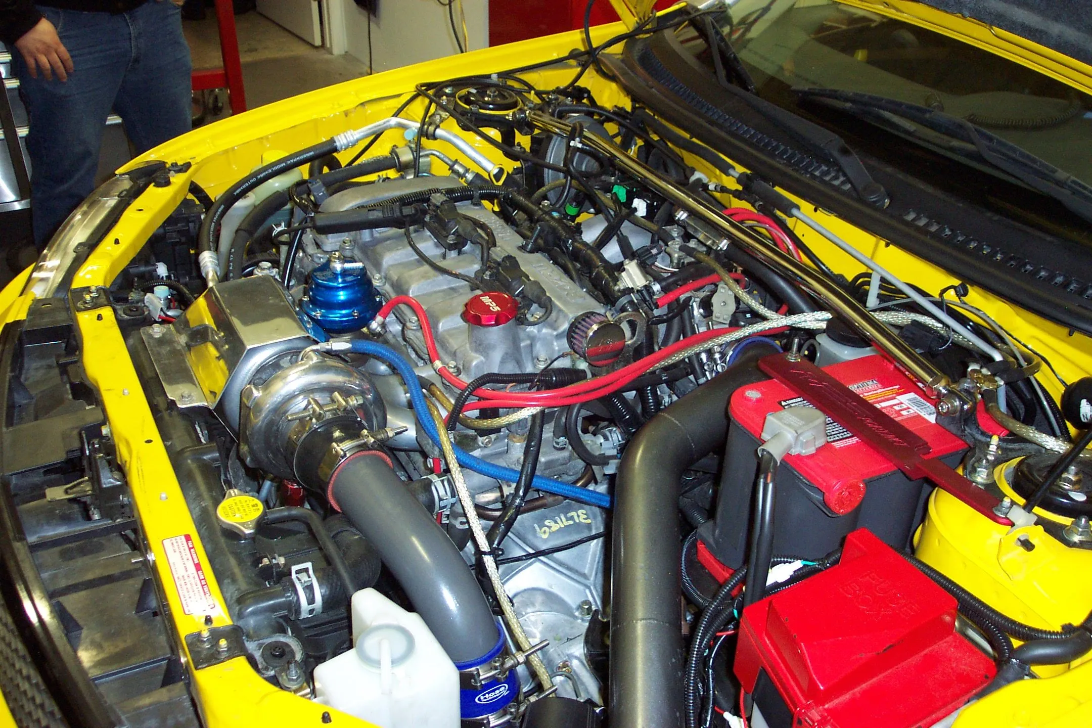

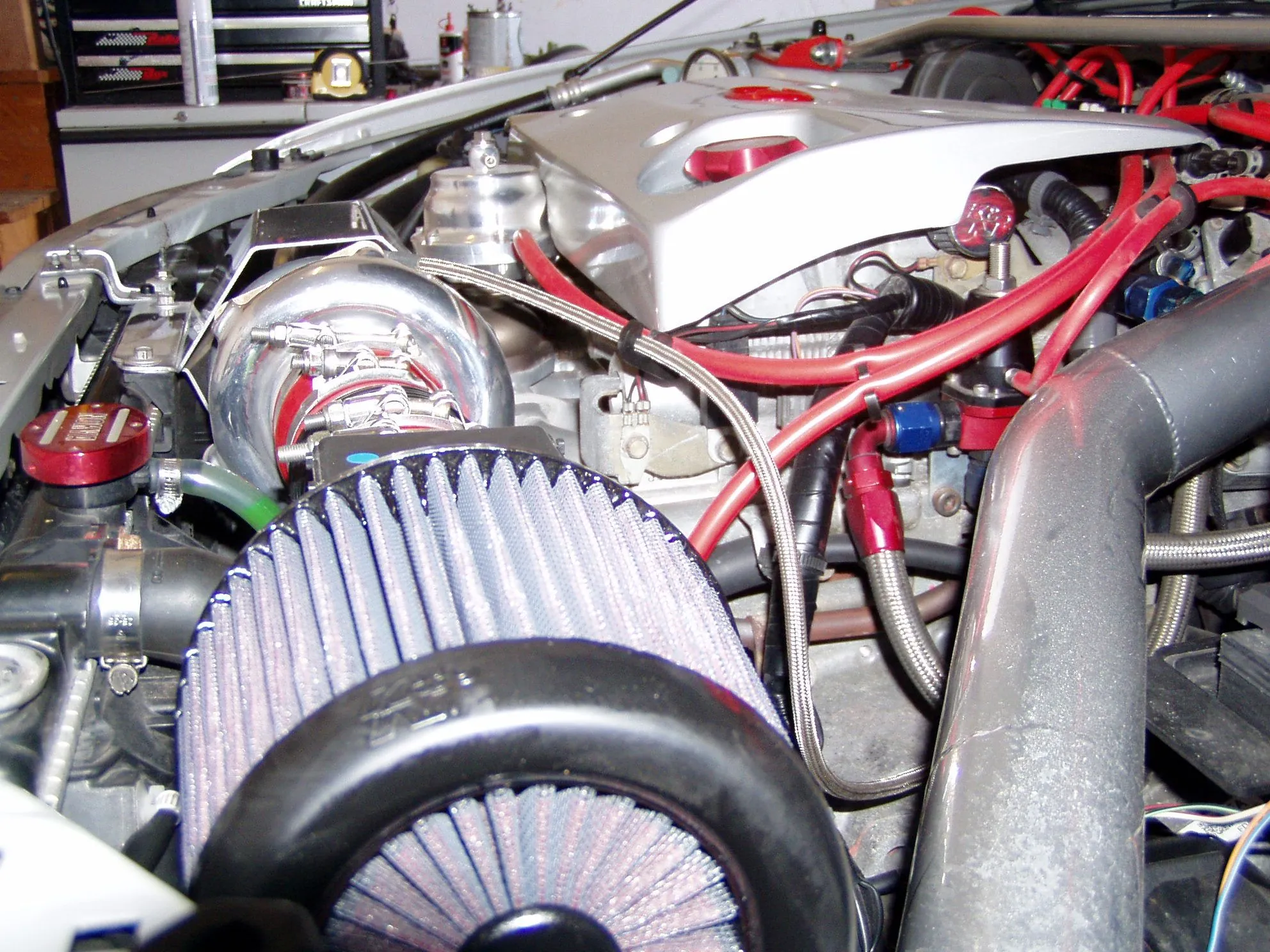

The finished product... (thumb) Another satisfied MAM customer (indirectly). :)
nice ......real nice...we should have a MAM sleeper turbo meet!! haha..
