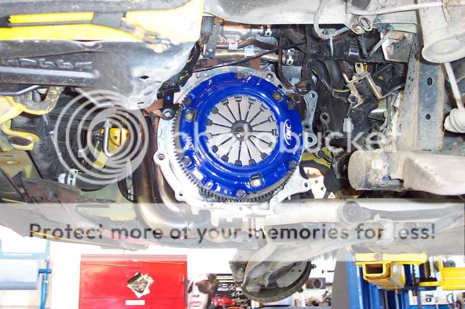

My SPEC Stage II+ and MSP transaxle went in today... :)
I'm happy with this clutch so far. It's much softer than what I expected to be a harsh engagement. Me likey! Tranny is a bit notchy but I'm putting some Amsoil MTF in so that will hopefully change.

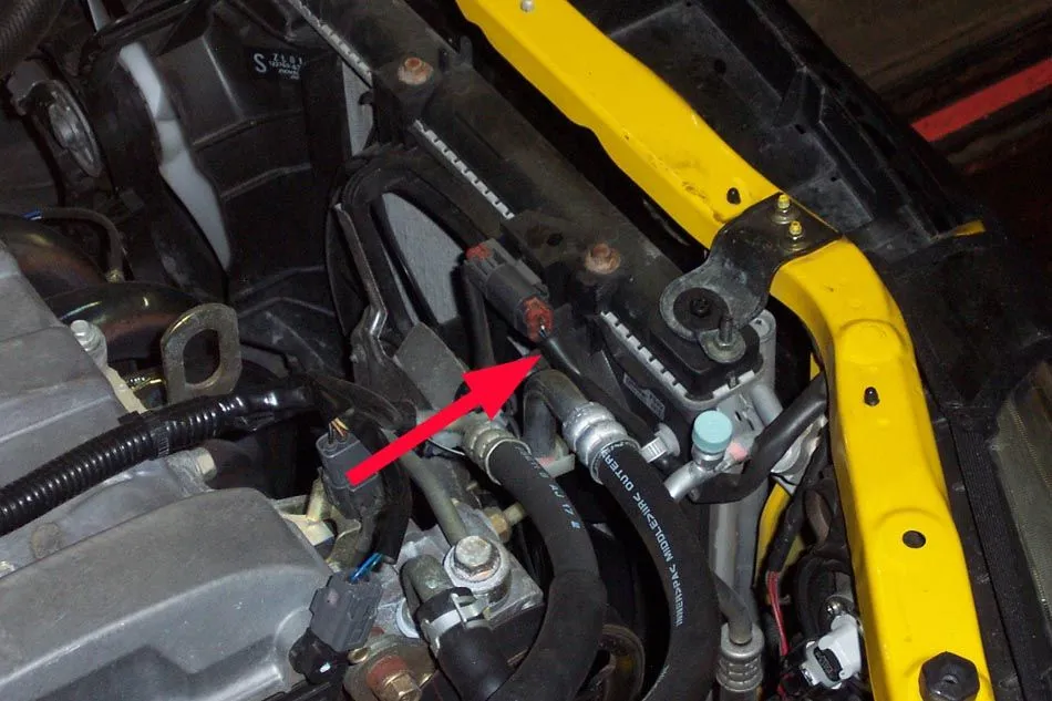

I've got this really nice 9" SPAL fan with the kit that has a connector plug on it. Where does this plug into? Or, does it have to be cut off and the wires spliced into something else? Can't find any detailed info on installing this piece.
Splice it into your AC cooling fan harness.
Okay, so just to be sure, would that be this?...

Okay thanks. Now I see that this car has two fans. Do I need to have two? Or is one sufficient, and if so, do you recommend mounting it on the passenger side, driver side or in the middle?

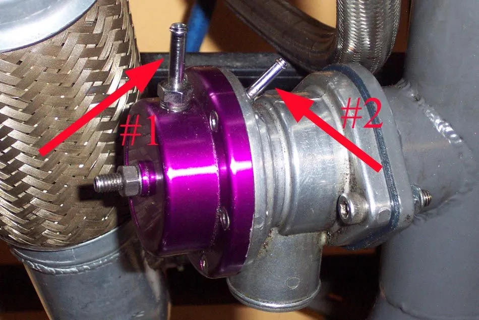

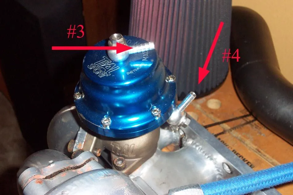

I have 2 hose barbs on both the BOV and WG. Where do these connect too? (I have numbered each one for reference in the pics attached). I know there are 3 ports on the Vacuum block. I have used one for my boost gauge...
We did not offer that type of BOV. Read the instructions on what the ports are for for it.As for the WG, the top port is used with a boost controler. The lower port is where the vaccum line needs to go.
