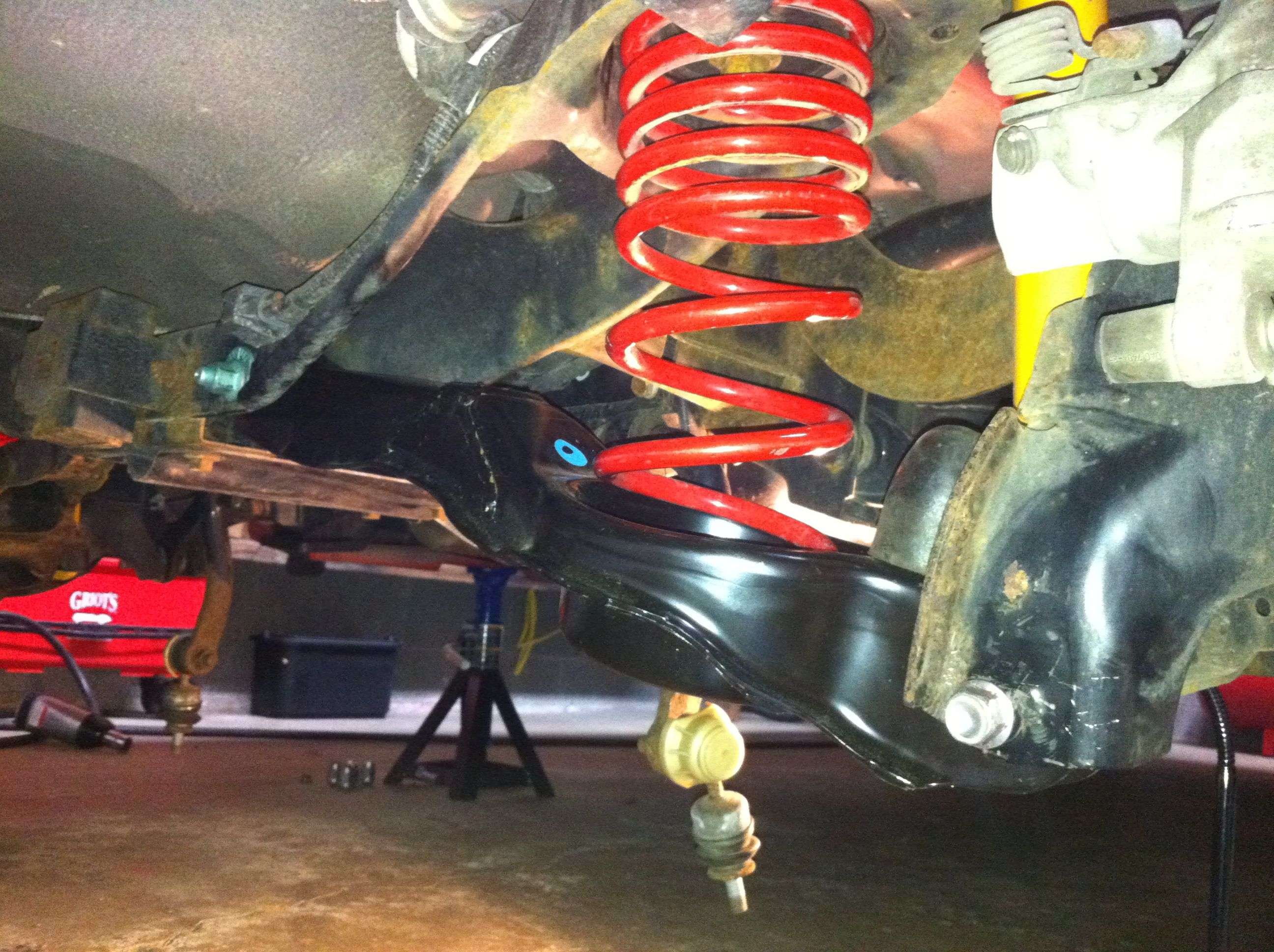

So I got the LCA completely off the car tonight...
Here are the pieces of the bolt/bushing/steel sleeve:
Looks to me like the bolt got bound up in the bushing/steel sleeve and from there it just stripped the threads on both the nut and the bolt.
And my f-ed LCA:
And the shiny new one all installed:
Just have to pick up a lock washer and nut to replace the nut that I had to grind off the other side of the LCA and I should be good to go.
