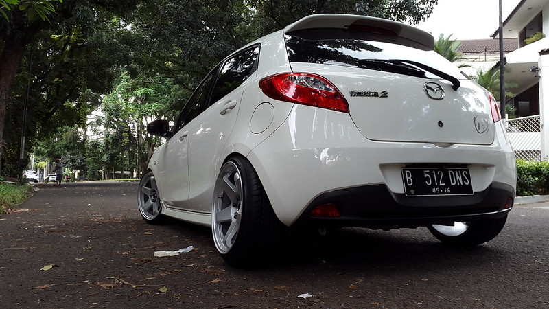

You mean these?
Sorry it's a little dark, but it's the only pic I had of the wheels stationary.

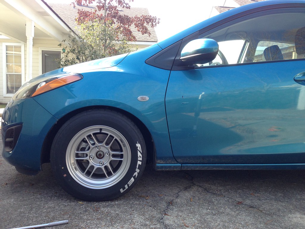

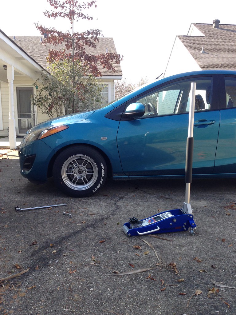

I was bored today so I put a wheel from my Miata setup on the 2.
Enkei RPF1 14x7 +19 on H&R lowering springs with 195/60/14 Falken Azenis R615K

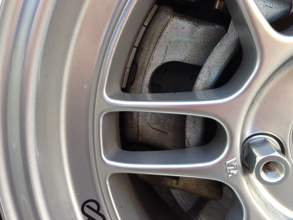

The wheel weights did not touch the brake calipers.
Excuse the filthy car.

That's the same sort of look I was planning for this summer. Different wheel, but similar offset (+32 last season, but looking at a 15mm bolt-on spacer). Looks great, and would look even better in gold.
That is an interesting look with that much rubber on the tire. Did you go out and drive it?
Derrick
I did not, Derrick. But I rolled the car around in my driveway and listened for scraping sounds lol.

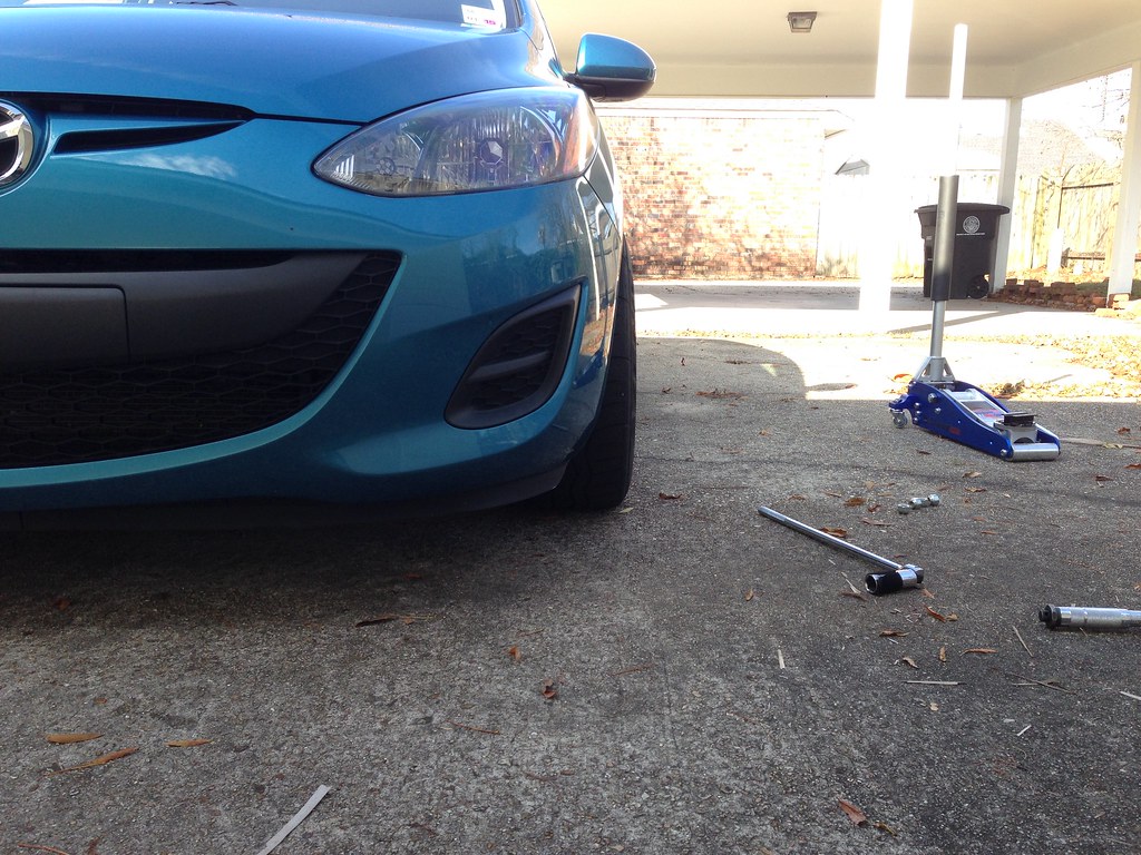

It was nice out today and I had to swap wheels so I figured I would see what my 6UL's look like on the 2. Even though I don't have tires yet for them. Need to order them soon though.
