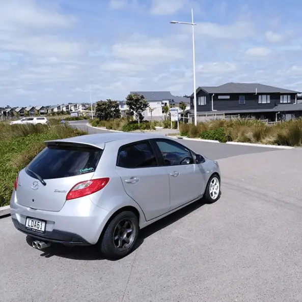

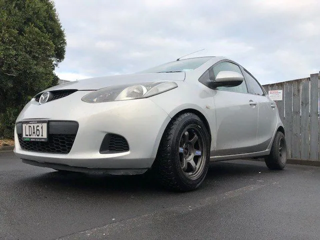

Hi guys, Im looking at a set of 16x8" 30+ running a 205/45/16 tyre.
Would this setup fit (without issues/scrubbing) on a lowered 2 DE?
The alloy is XXR 531.
Tyre is BRIDGESTONE POTENZA RE003
Thanks in advance.
Thanks in advance.
It's running on PEDDERS Sports Ryder springs and PEDDERS shocks.
The drop is about 30-40mm.

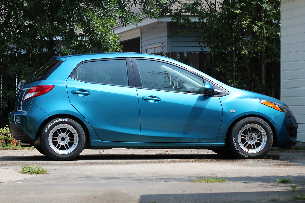

15x8 6ULs +36 offset, 205/50/R15 Dunlop Direzza Star Specs, and H&R springs. No rubbing at all.
15" O.Z. Racing MSW Type 85 Wheels

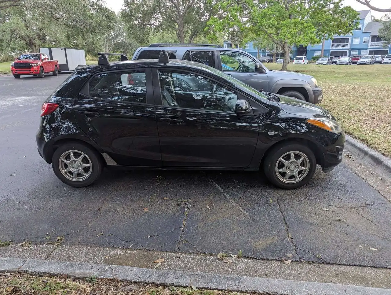

Got my Mazda2 a few weeks ago after my 94 Miata was totaled. Swapped the Miata M edition wheels over before I sell the Miata for parts. Spent too many hours polishing these up to let them go. Also they are only 10.5 lb each so the handling is nice and quick.
