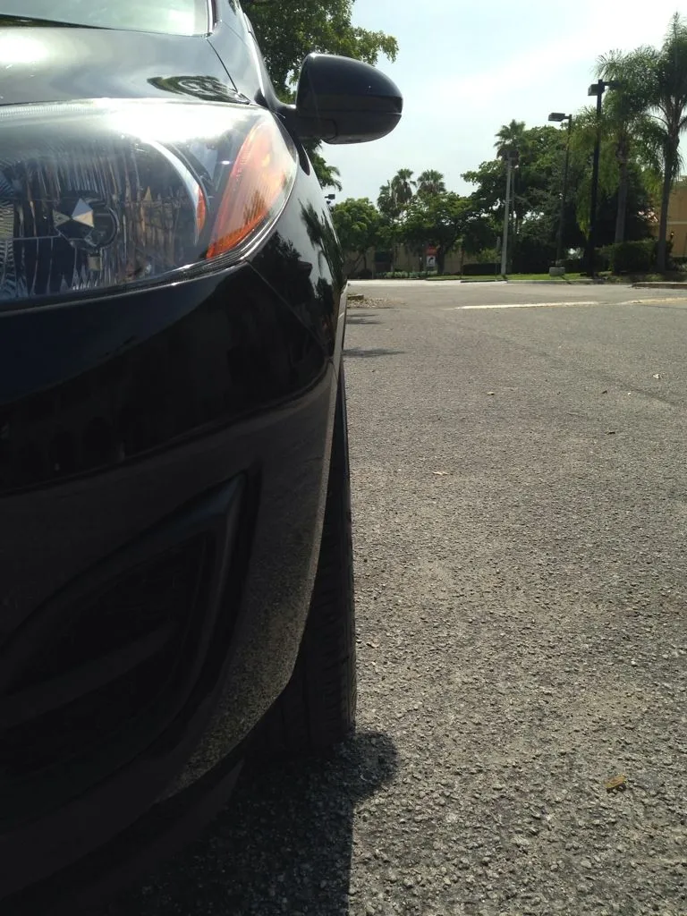

ImageUploadedByTapatalk1436105336.722637.jpg ImageUploadedByTapatalk1436105348.104215.jpg ImageUploadedByTapatalk1436105363.287429.jpg
Avid av-08 185-60-15
Getting rdy for 195 50. Dz102s

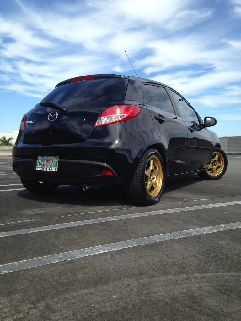

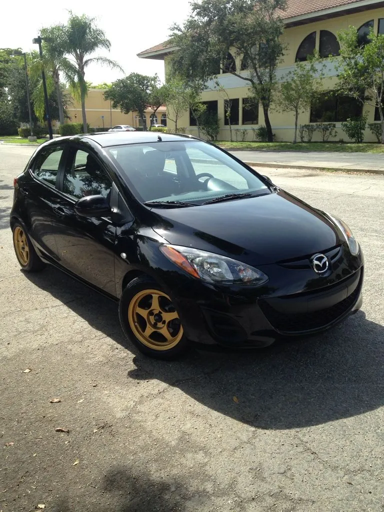

Mazda 2 / 2010
My new Setup October 2015
- Advan Racing RZ Replica (Graphite)
- 17"x8.0" ~ ET40
- 205/40/17 Maxxis
- Muteki SR48 black lug nuts
- H&R Spring
OLD SETUP --> SIGNATURE

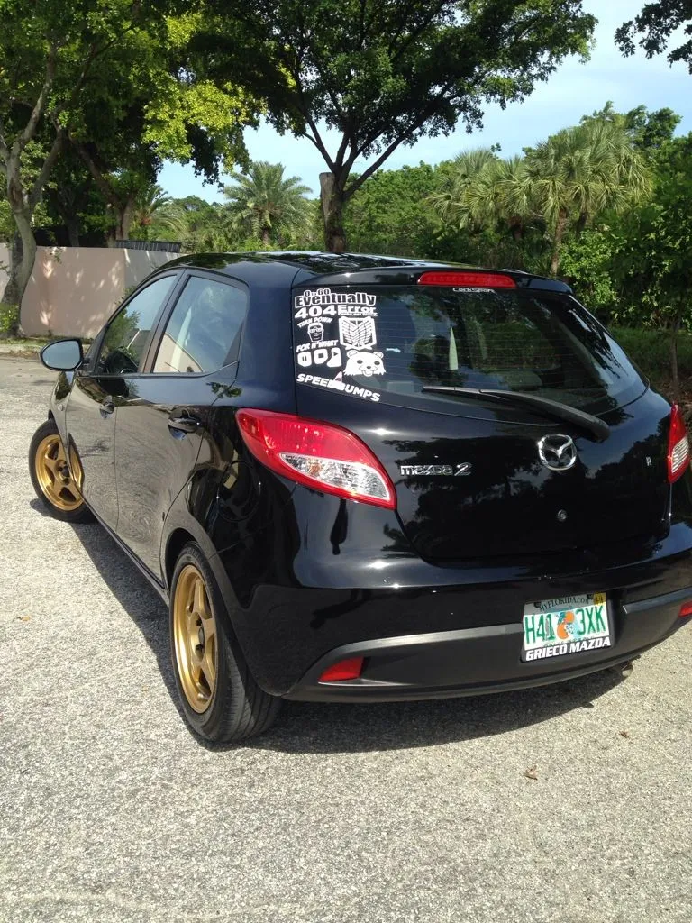

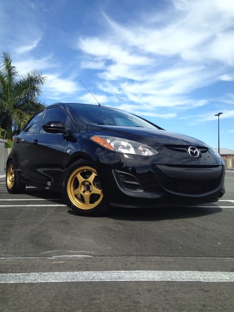

BigRaab
2012 Mazda2 sport

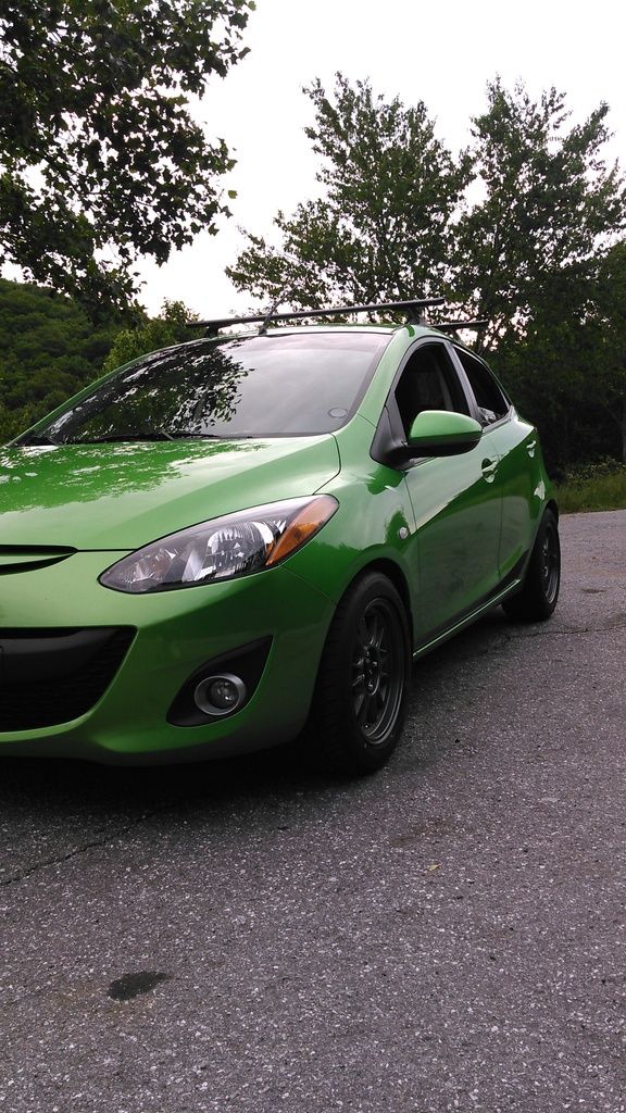

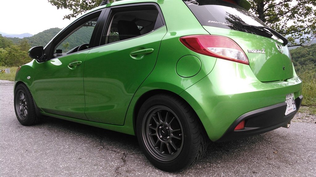

ImageUploadedByTapatalk1457282008.582769.jpg ImageUploadedByTapatalk1457282050.089489.jpg
205 50 r 15 Dunlop dz102 with Avid AV-8 wheels. 15x6.5 35 offset.
Wheels are crap but look great. Thinking of getting Rota Grids instead

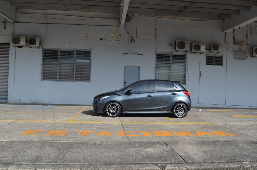

2012 Mazda 2 Touring SG 5MT
Hypergram 15x7.5 +35, neo-gen 205/50, ~-1.5 deg camber; color is matte grey, but looks more like gunmetal.
