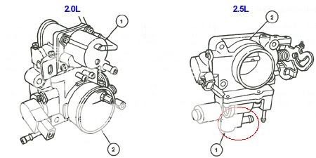

there is a thread over the the IAC system
http://www.performanceprobe.com/forum/showthread.php?t=2907

ahh yes I read that thread many times lol. The IAC has a vac port coming off the metal rails that tie the system together, thats how it was from the probe. I don't remember taking a hose off the port I have plugged though. I'm not sure what it is, but its seems to be unnecessary in my case...

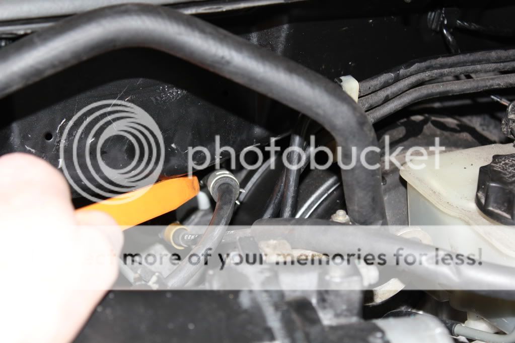

there is a vacuum port for the HVAC system, I believe that heat/cool knob is vacuum operated but controlled by a cable(s) from the knob. The port for it is right to the upper left of the brake booster in the engine bay. I'll grab a pic later...
you have to hook that port to the IAC otherwise you will have a bad idle

Tee - so you're saying there's a vacuum port somewhere by the brake master cylinder? I don't know where that is, nor have I messed with that at all. Any pics of it?

nope, no check valve, its just a straight line, I'm looking for an easy way to adapt the line with a 90 degree elbow to clear up a little more space
ta-da. I used a bright orange thing to point this time...

i dont have that on my car, what does it run to?
i have the hole in my firewall for that, but i just run my vac gauge line through there

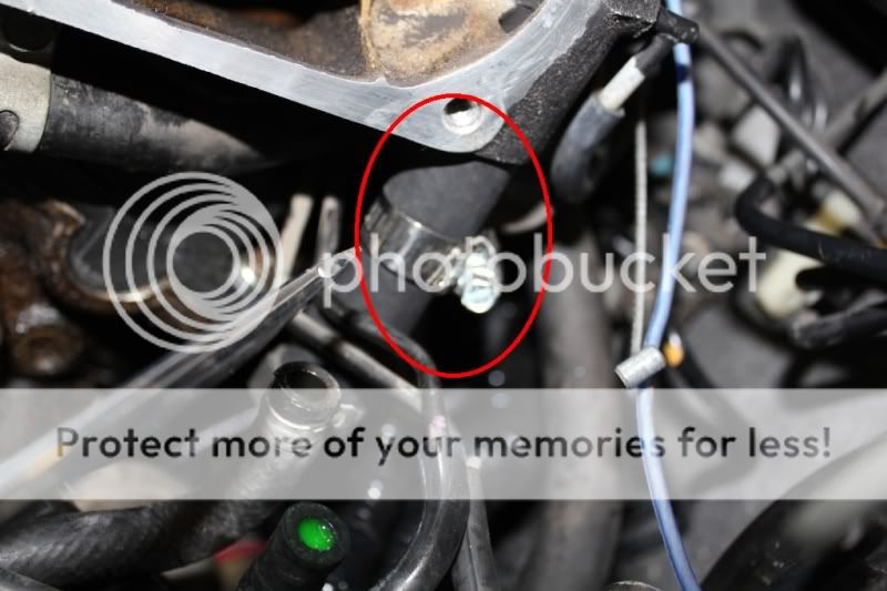

most sure this is tight otherwise you will hear a leak on the passenger side
hmm, maybe I'm wrong there then. That hissing won't go away, unless I cap the line. Its weird because the FS had a line to it...
where is that pic taken from? I think its under the manifold on the passenger side. Thats the 90 degree elbow that connects the rear valve cover to the vaccum system.

yep, it was under the IM on the rear passenger side
