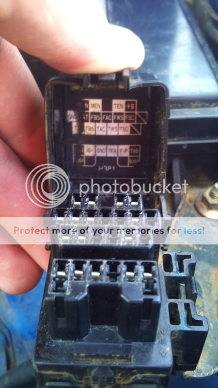

Check your timing run a jumper wire to TEN to GND
Test your timing
Jump ten to ground
Hook up timing light on cylinder 1 (back left [rear passenger])
Point to left side of the crankshaft pulley
Its suppose to be close to 10
If that is good they turn the car off and turn it to run without starting and with TEN grounded
loosen your tps and turn it till your fans turn on
then turn it the other way very very slowly till your fans turn off you want it to be right before the fans kick on and your TPS will be good

you can leave the wire in the TEN pin to GND pin and run your car its not suggested but if it wont start up like that then its timing or dist

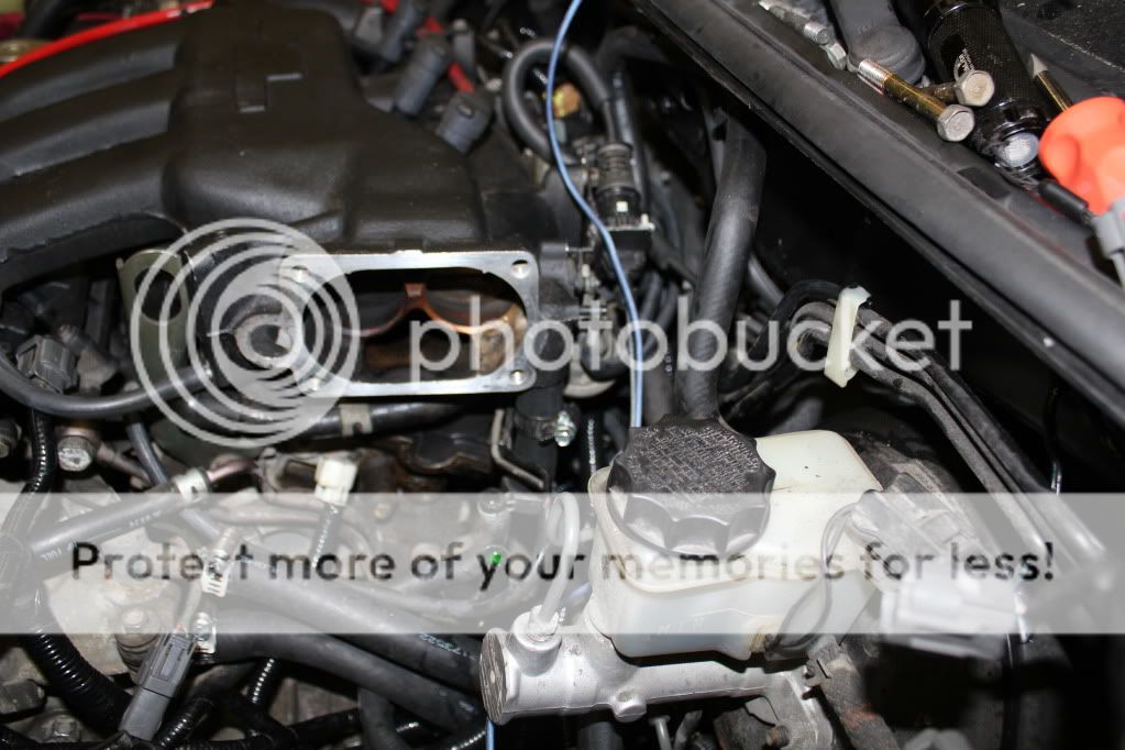

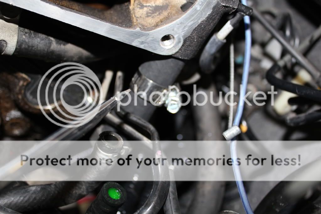

figured it out! My dad brought home a vacuum gauge, the engine wasn't holding any vacuum. Sooooo we looked around the engine for a leak... found a rather large one that vents right after the throttle plate. Plugged it up and it runs, not perfectly though, it has a bit of a rough idle. The HVAC system sounds like its leaking, I also had to re-seal the throttle body, as it was leaking.

Does anyone know what this massive vac port is for? pics for reference:
It's already capped in these photos, is the thing the screw driver is pointing at. It is right behind the throttle body, not shown on any vac diagram, mind you neither does the HVAC line..

I think that is PCV port
you are suppose to have a line run from the rear to your intake piping on the OBD1 I'm not sure about OBD2
did you plug your HVAC port on the back of your IM and I think there is a nipple hidden on your IM I would glance over everything really quick and see if you missed anything
yes the HVAC nipple's plugged in, I can hear it leaking in the car not from the engine bay... kinda odd.
Where would that plug to on the other side? I'll have to do more researching...
