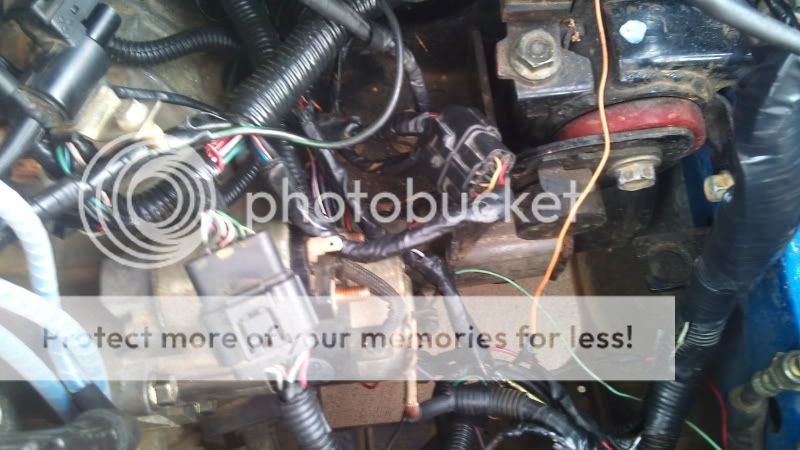

so the pinout out for this is as follows:
Grey/green Lightblue/yellow
Blue/Violet Orange/yellow
Green Green/pink
Orange/black Brown/green
White Dark Green
I've looked through all my resources and I can't even come close. Theres a similar color or two, but none that meet all in one plug. If you feel like taking a shot at figuring it out, be much appreciated.

Transmission maybe? Are you using a manual or auto harness for your motor?
I think he is using a manal harness, does it go to another connector in the front driver side of the engine
Ill be off in 3 1/2 hours ill check then, and sorry I forgot to check earlier
I was high on bleach, menthol, and miscellaneous aerosols when I was cleaning my starter
lol, careful dude that stuff's not too good for you. I was literally in the same state degreasing some of my parts....
I'm using a manual trans.. I just can't thnk of what it would be. not A/C, not headlights or wipers, as those go through the fuse panel area. Maybe like brake fluid or something... It's on the same run of wires as the rear O2 sensors, so near the tunnel/firewall. I can't remember unplugging it either lol.
i have one that runs from the back side of my engine to above my tranny, and it goes to another connector
Engine, it has alt, O2 and some other crap on it I believe
Hope that helps
thanks, I'll take a look again but I think those plugs are that pair that meet up in between the harness, this plug has no mate..

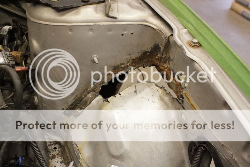

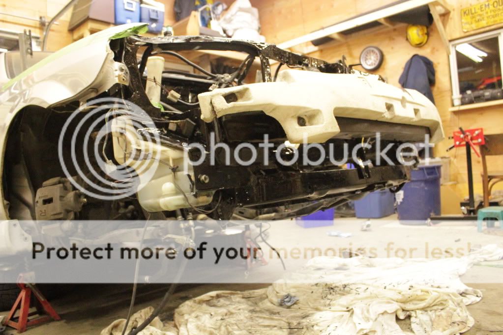

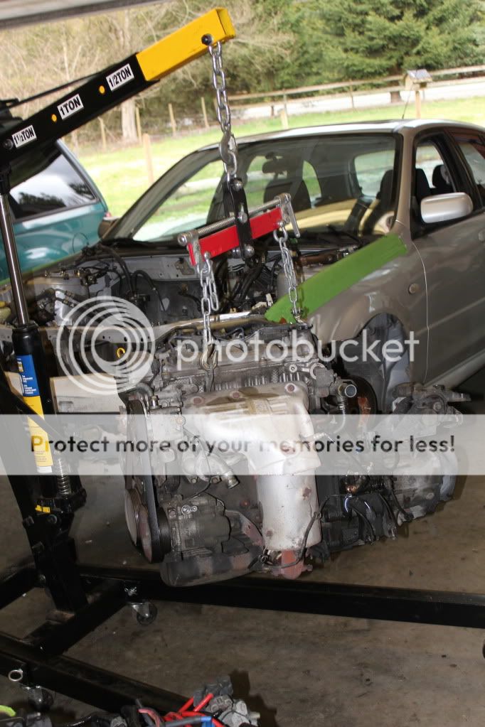

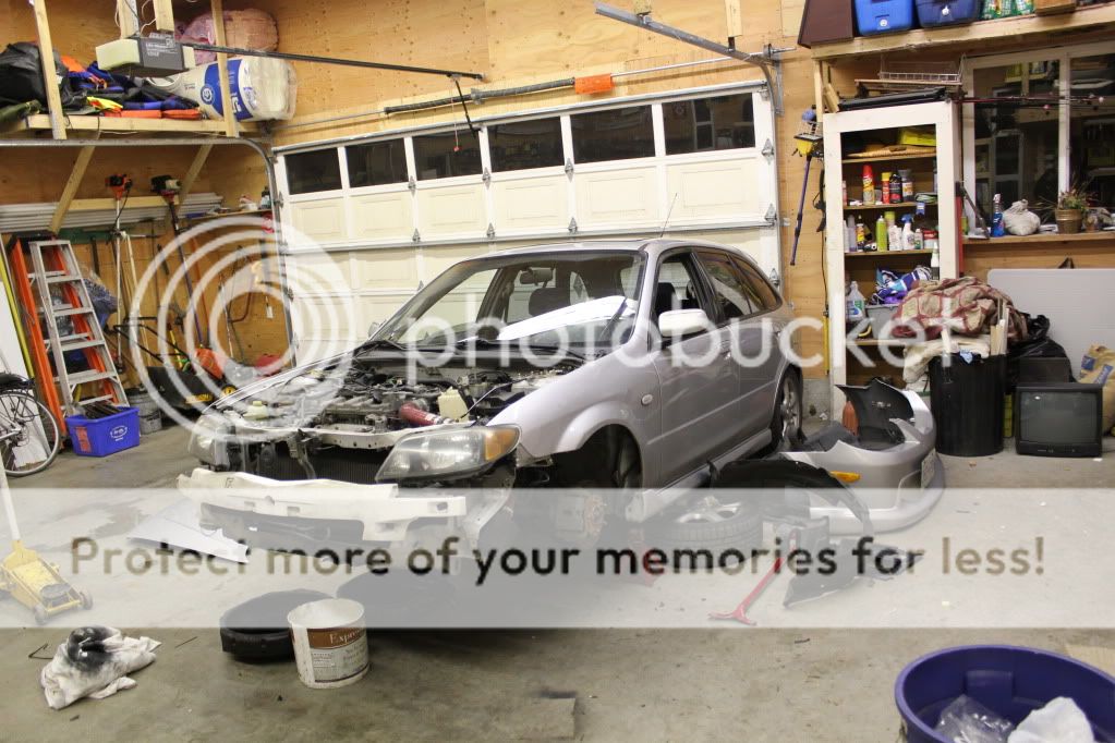

Old motors out, so is the bumper and about 80% of the engine bay. I had my buddy come over with his welder and we cut and filled in the strut towers where rust was taking over. Glad I did it because it was getting bad.

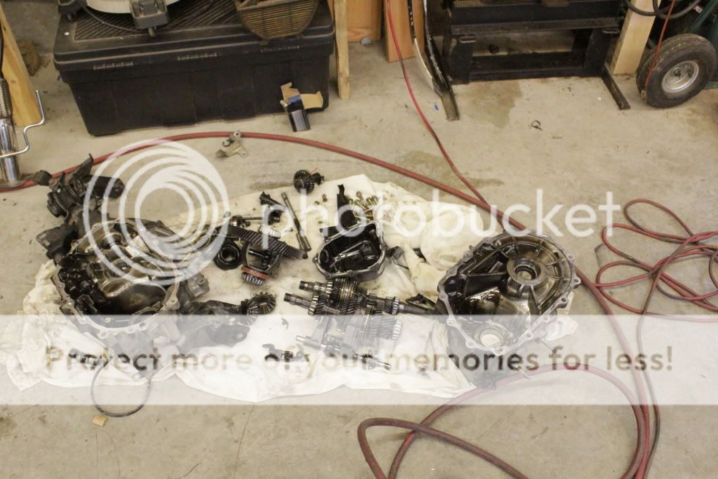

Tore apart old trans to get that shift linkage and the oil guide. Also swapped 5th gear, should give me lower revs on the highway. Looked high and low for the cause of that hum/rumble/vibration that plagued me before, theres a little bit of play in the diff bearings but nothing major that would cause it to be that bad. It only happened when I was going straight or left. Not a wheel bearing, checked those.
Had to modify the probe shift linkage to get it to fit.. The bolt holes had to be enlarged and the bushings flare had to be grinded off. Good to know for anybody doing the same thing.
My front motor mount was gone. Literally hanging on by a hair. So I went and got some window weld, filled the thing up and let it dry. I hope it holds long enough for me to buy another AWR mount...

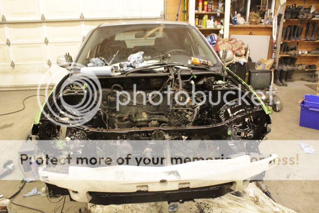

Coated the whole engine bay, was pretty thorough about it, I don't want to see any more rust starting.

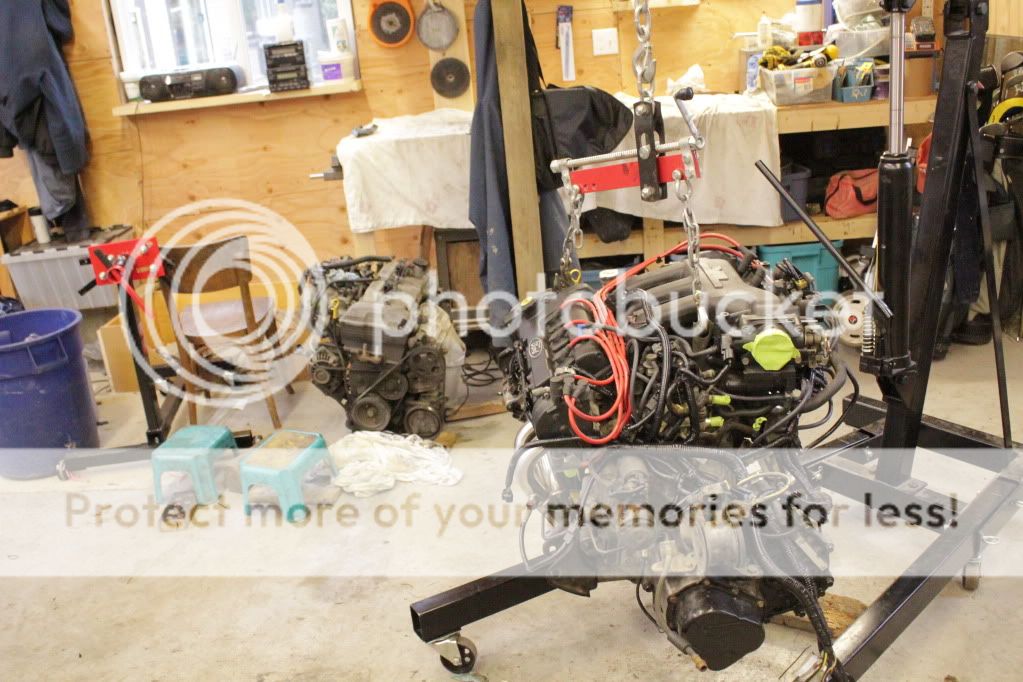

Other than that a couple small things to do and I'm ready to drop the motor in and get started hooking everything up. I see multiple trips to the parts store in my future.

looks great so far. I would suggest taking off the front fender( few bolts) and making sure to coat the rest of the wheel well metal. I know when i removed mine i found a few spots that needed fixing that i would not have seen without removing them. Plus it allows you to work around the engine bay easier and not worry about scratching your fenders.
too late lol. The undercoating looks around it, really I just don't have the time to do all that. And the bolts holding it on probably wont go on again nicely.
