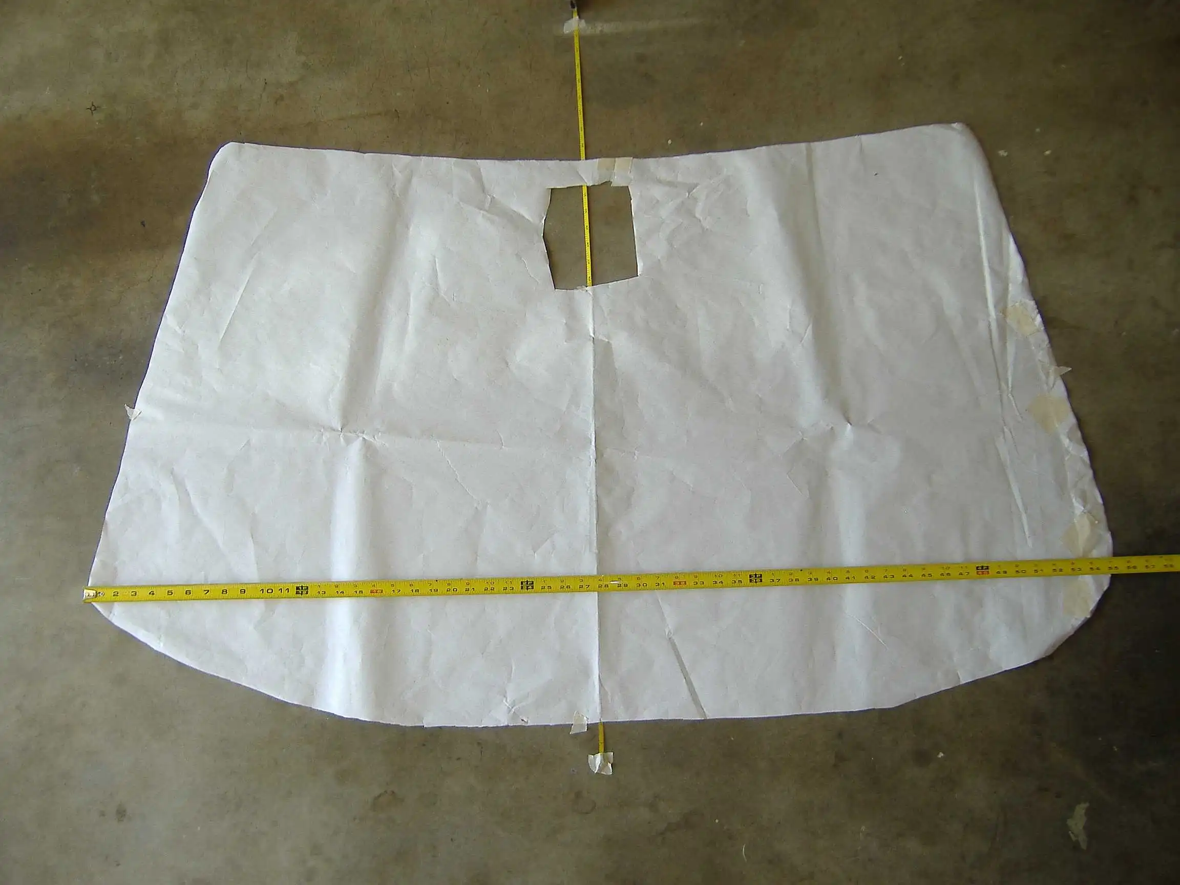

In the spirit of DIY, here is the Mark I sunshade, which only stays in place when held up with masking tape. Basically it's just a paper template showing roughly the shape of the inside of the windshield. Stay tuned for Mark II and Mark III.

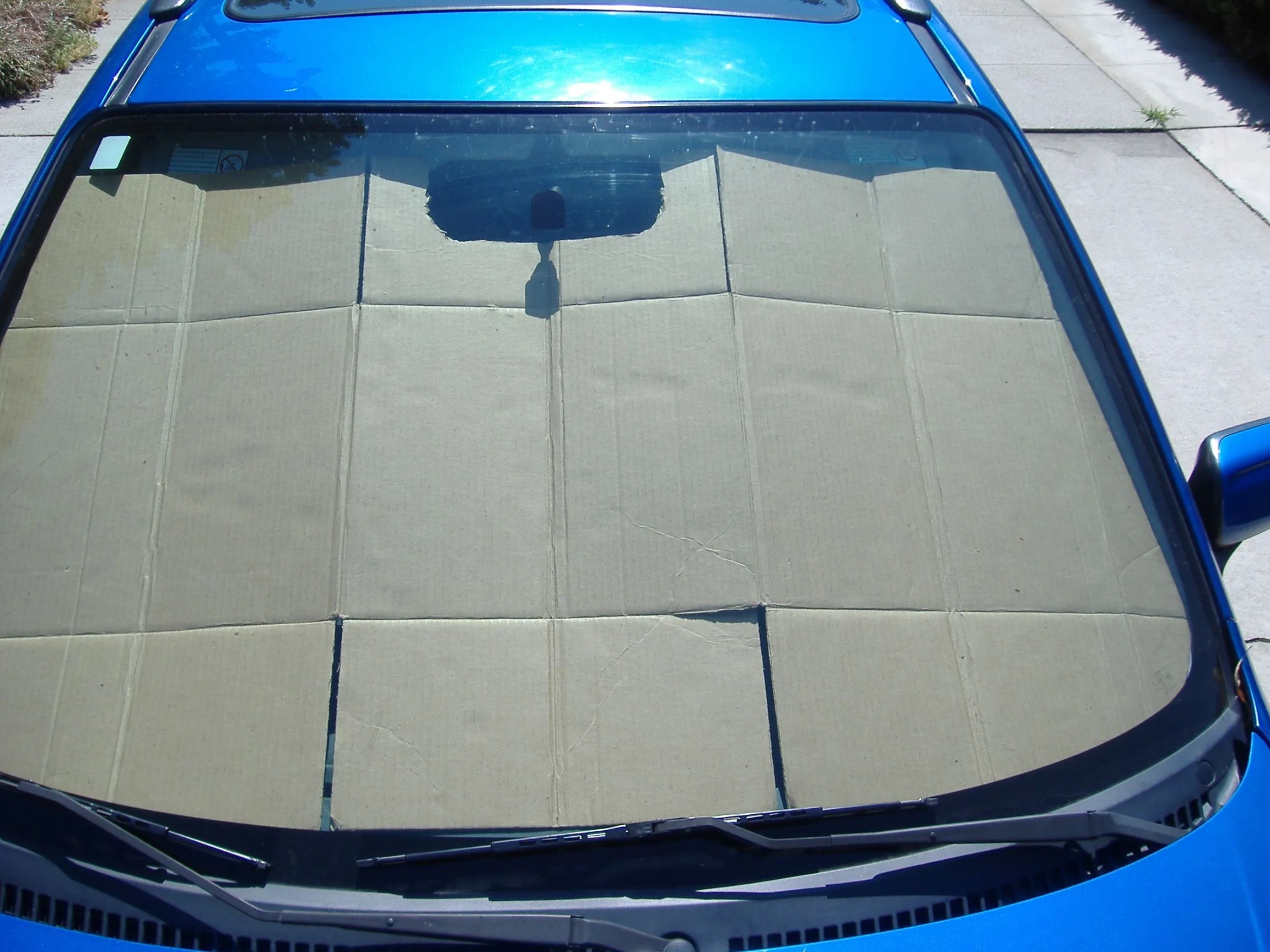

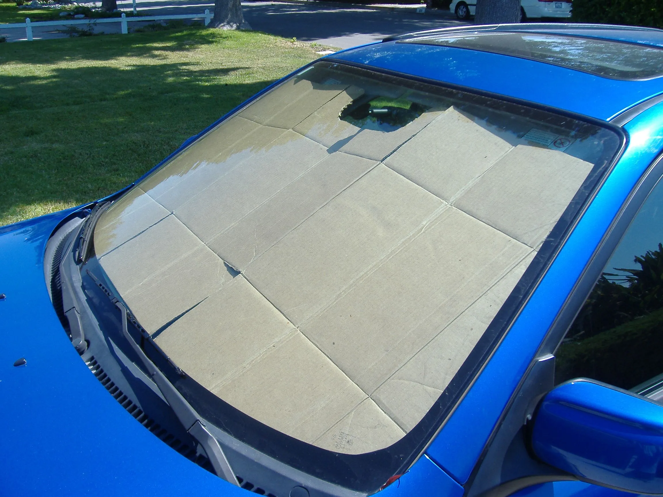

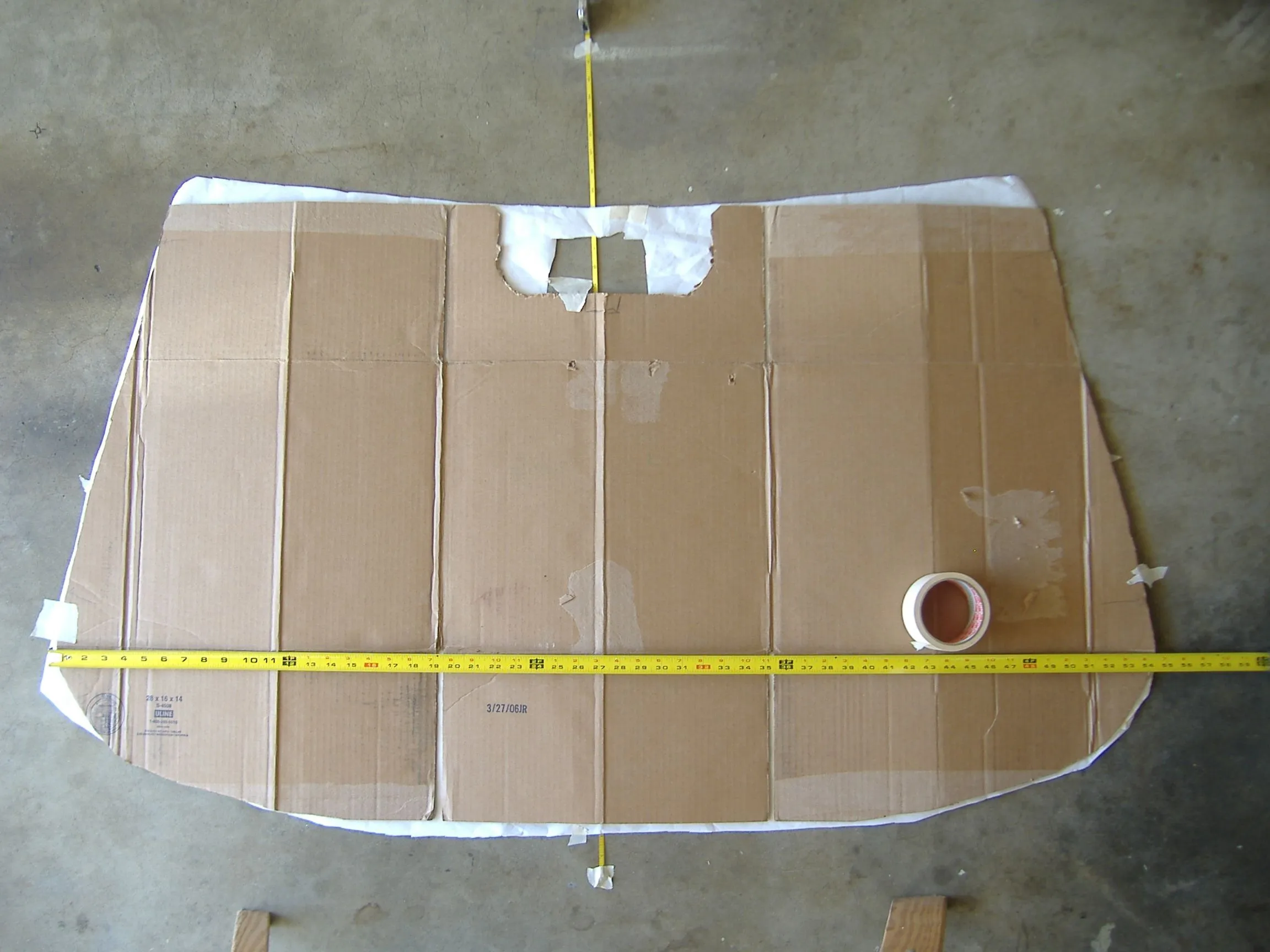

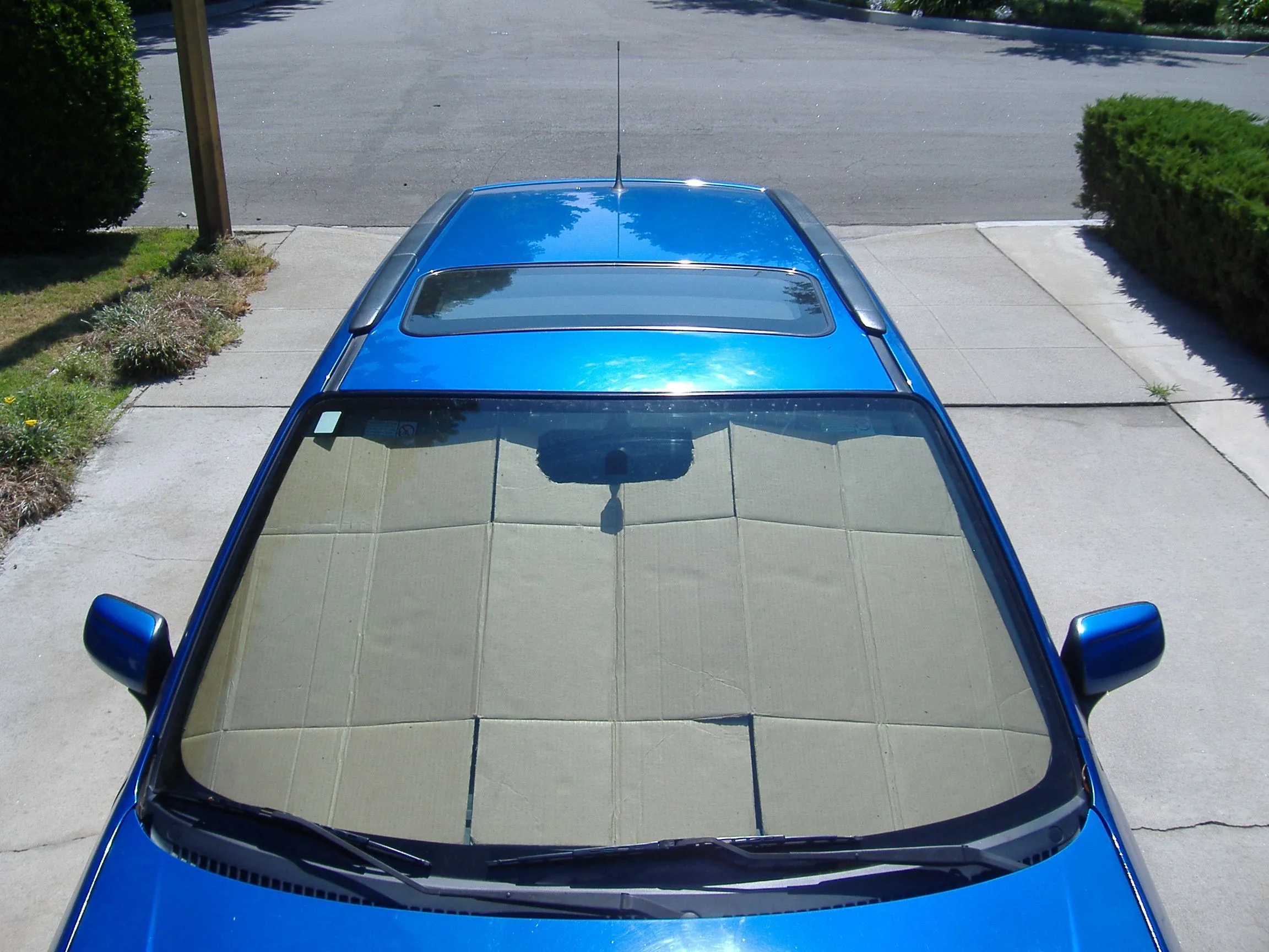

Here is the Mark II, made of the biggest cardboard box I could find, which unfortunately wasn't quite big enough. It tends to hang up on the vent that runs laterally across the front top of the dash, so to install it one must push a bit on the bottom to get it out of that groove. Other than that, and being a few inches too short, and of course, ugly as hell, it fits pretty well. To make the creases for the fold I bent it at 8" increments across a straight board and then smashed the edges by stepping on the cardboard with the heel of my foot. There is no picture but it folds up to about 1.5-2" thick. It insulates well but stinks a bit when hot, both are probably a function of the cardboard I used. Also the cardboard should have been white but at the time I couldn't find a white box that size.

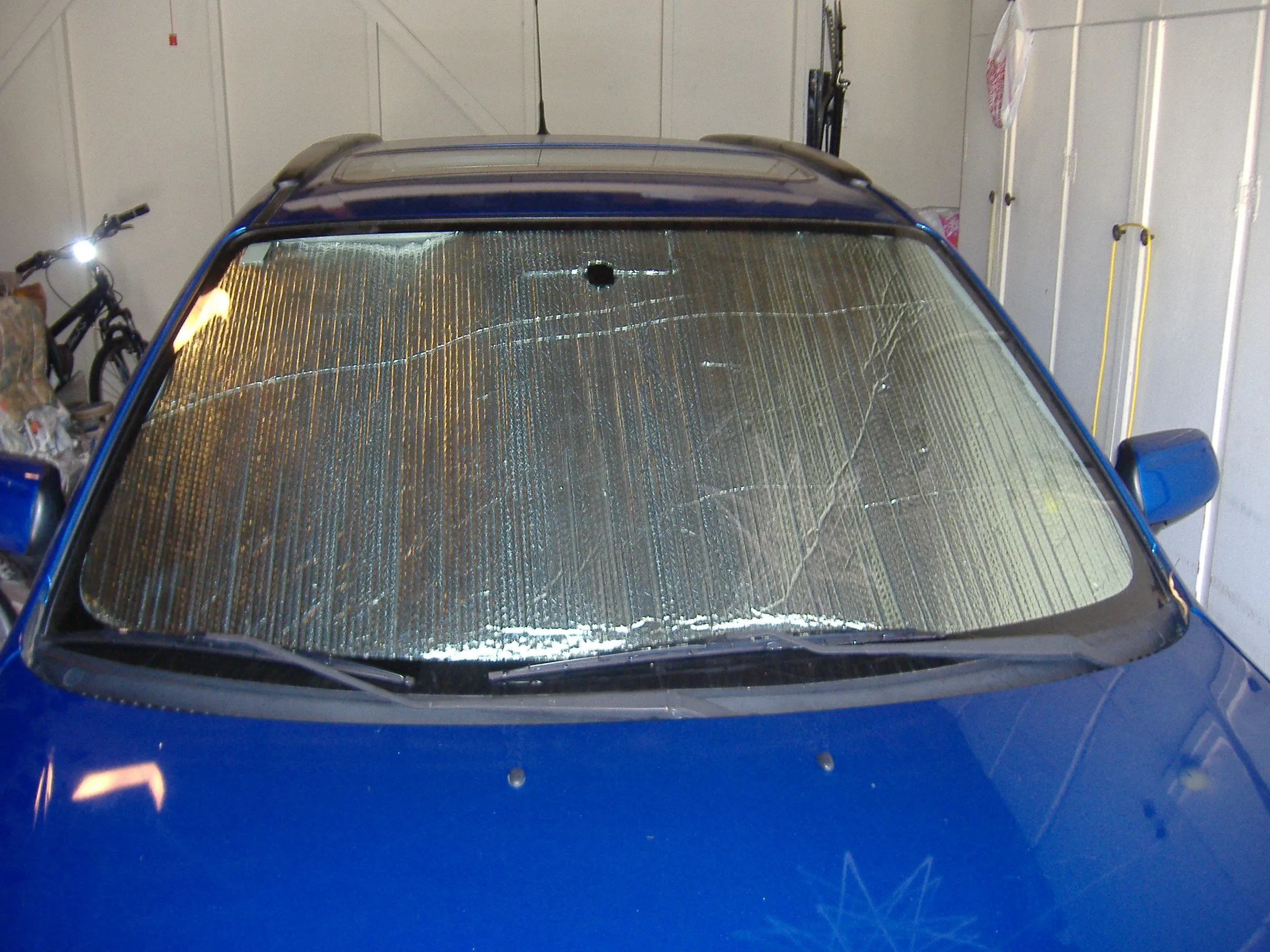

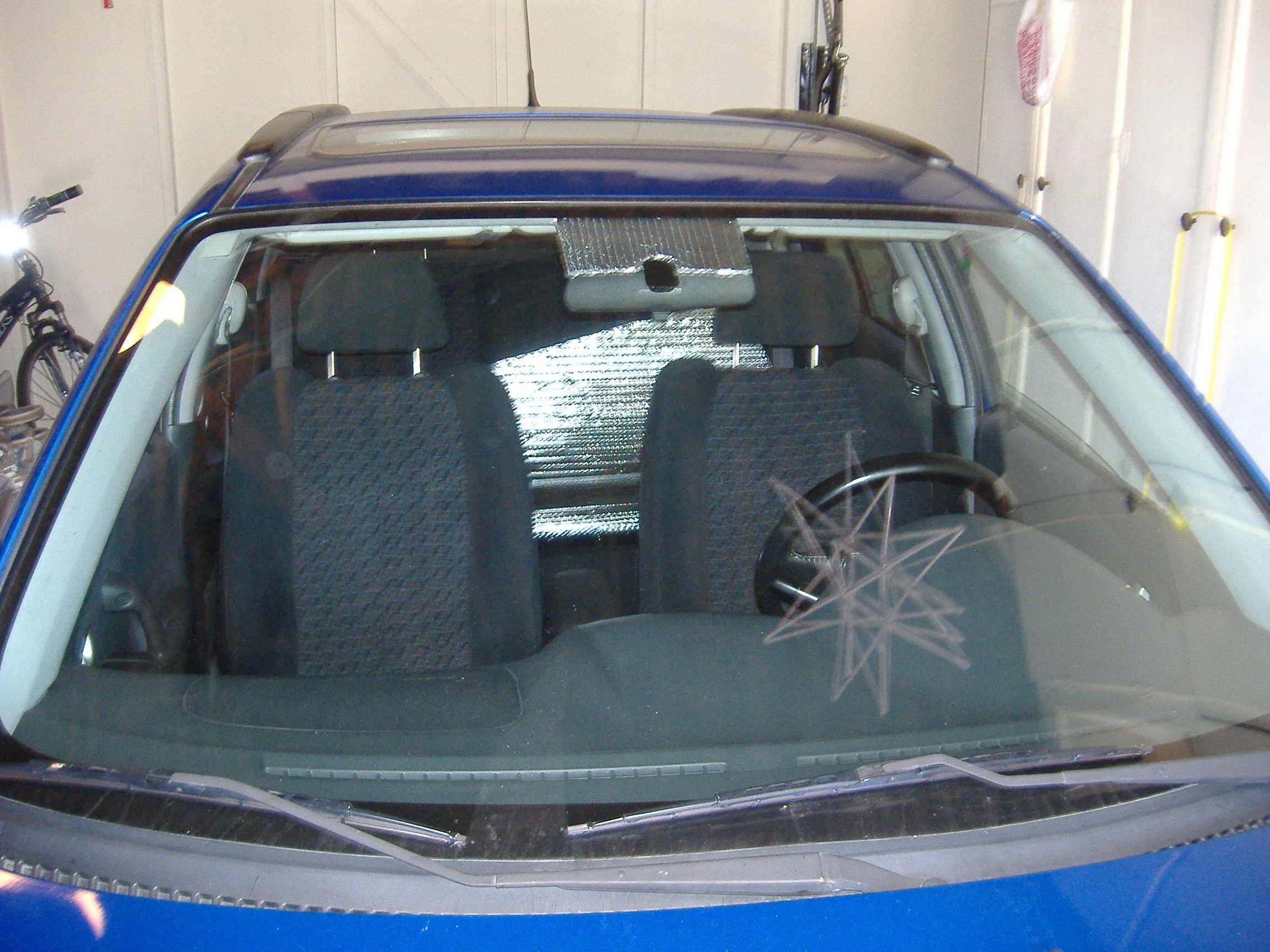

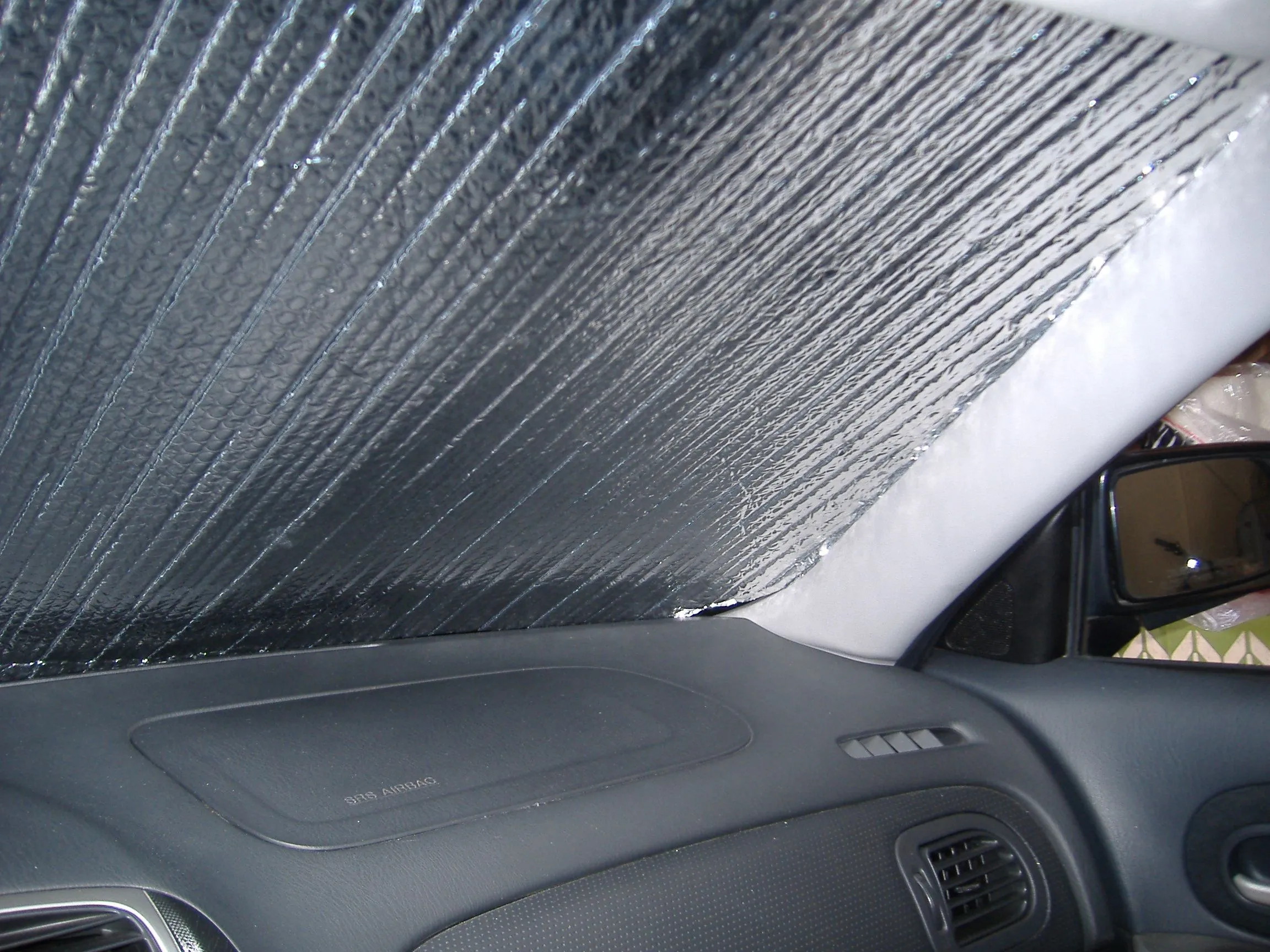

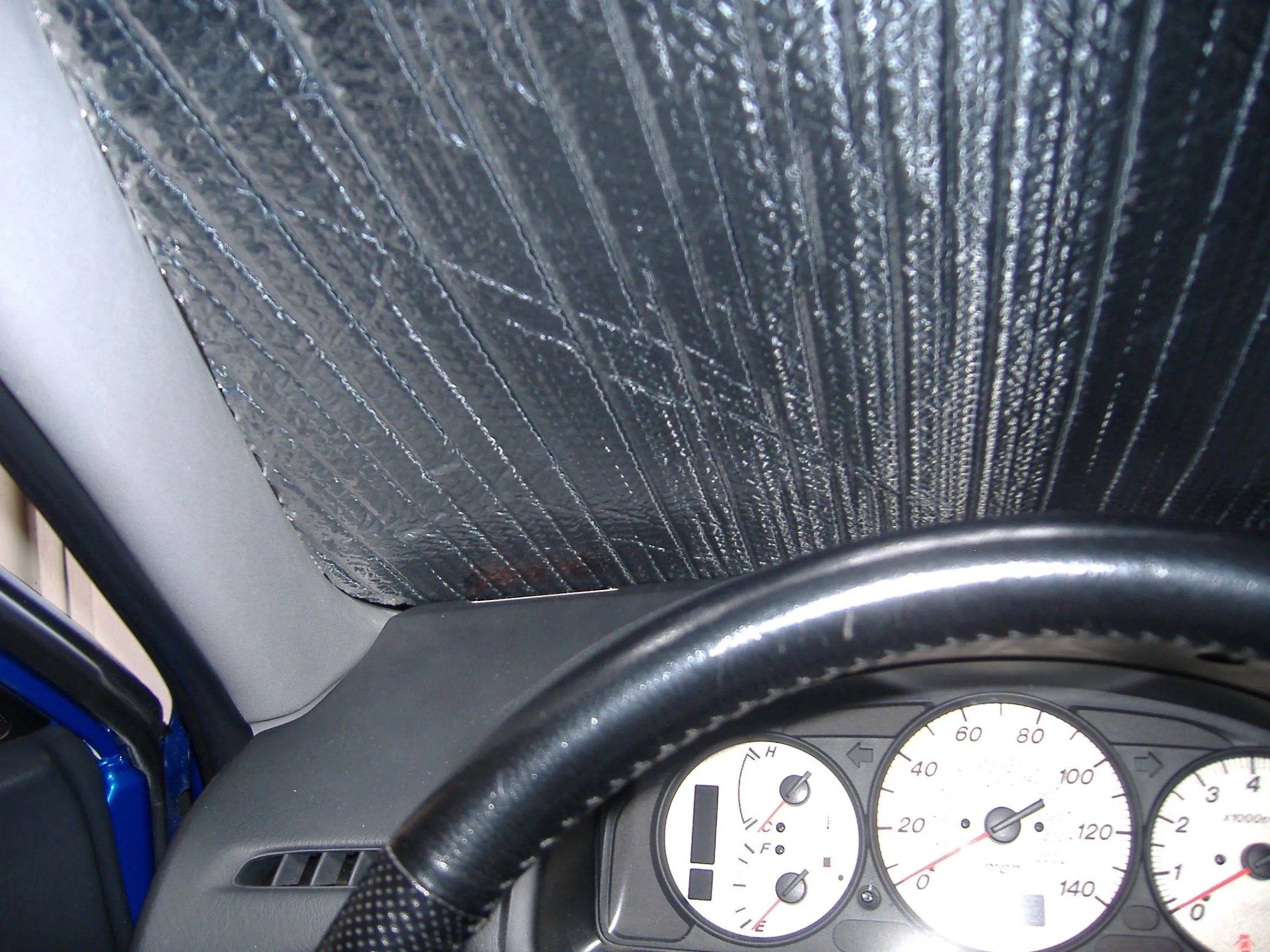

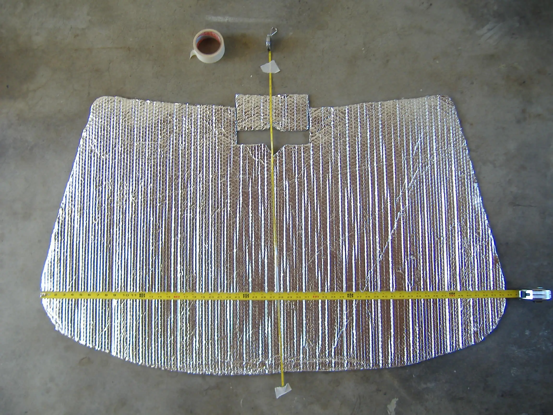

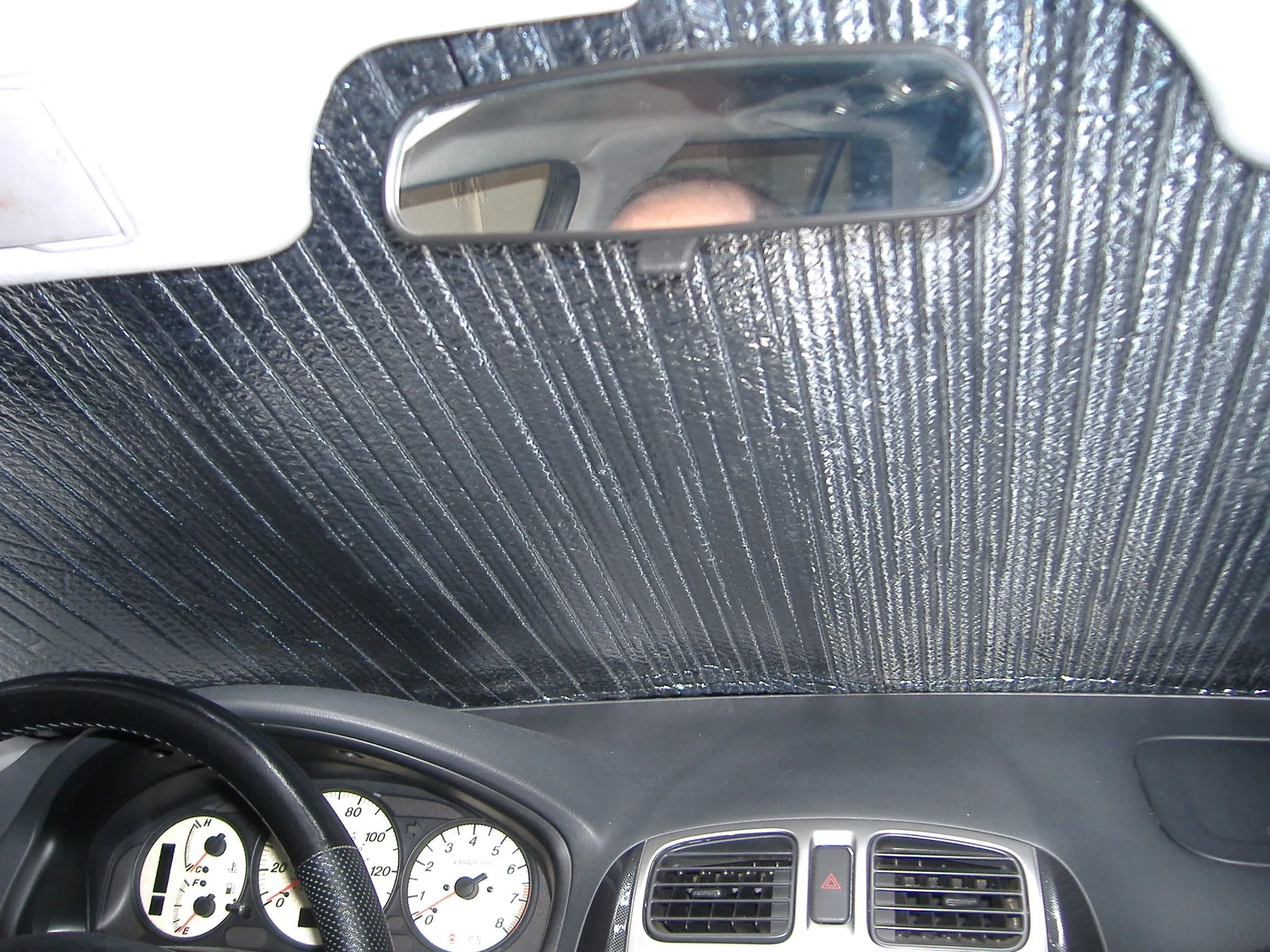

Here is the Mark III, made of several feet of 48" reflectix, which was purchased from Orchard Supply Hardware. Home Depot also sells it. The fit is great but right now I just keep it in a loose roll, so it takes up a lot of space. It might fold if I puncture the bubbles along the crease. Unfortunately it gets fairly hot on the inside, so apparently it doesn't insulate as well as reflectix advertises. There are no pictures of it in the sun because the reflection is just blinding. Note the little divot that goes above the rear view mirror (second attachment). Right now it fits by just being jammed in there. Unclear how long that will continue to work like that.
The creases in the material were present before I started work on it - the reflectix on the exposed end of the roll tends to take a beating in the hardware store.

One last picture of the Mark III showing the fit against the left pillar. Since the material is both fairly stiff and a little flexible it can be tucked in behind the pillars and it stays there. The 5' x 48" piece of reflectix cost around $10. It was the only thing that was purchased for this project.

Mark I took about an hour, the hard part with that was that the paper kept falling off the window and had to be held on with a lot of little loops of masking tape. I tried to trace the outside of the glass first but those dimensions didn't quite match the inside.
Mark II took about two hours, including tracing Mark I onto the cardboard, folding the carboard, and trimming it so that it would install. The cardboard was a pain to work with because it was so stiff it was hard to get it into a shape that would fit. It isn't easy to see but the sides are slightly concave where the window is straight because otherwise it wasn't possible to fit it in in front of the pillars as the "fan" expanded.
Mark III was really fast, about 30 minutes, just cut the reflectix to match Mark I and then trim the hole for the rear view mirror. Ok, to be fair, add 15 minutes more for buying the material from the hardware store. The combination of stiffness and flexibility is just about perfect for a sunshade so it's really easy to install and doesn't sag like the Axius Jumbo did.
