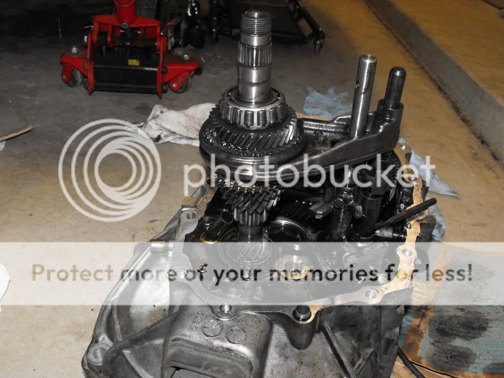

So I pulled the tranny last night, took about 3 hours, God I love impact tools :-). So tonight I will post pix of the inside once I pull the case.

Update.
I got the tranny apart and I found that the 3-4th gear shift fork is definitely broken. The rest of the tranny looks ok but I am going to by a lower mileage tranny from DiscoSpeed. The only issue is he has a nonLSD tranny. my question is.......

idk the names of the things lol but the gears are all on that shaft and dont come off. if you pull the whole rod out that the shift selectors are attatched to you can pull both gear sets out at the same time. then u just drop the lsd in.
what you do is there is a roll pin in there holding it. you can see the punch i was using to push it out.
once you pop that out it slides up and down freely although be careful because there is a metal ball and spring holding the bottom of that part. make sure you look at it before you do it. just pull everything out at once.

where exactly does that little spring and ball go btw. they fell out and i hve no clue where they go. i want to keep this tranny in case i want par gears later
on that main rod that holds the shift linkages theres that part down on the bottom that has like those bumps there should be this kinda circular thing there put the spring in and then put the pall and drop the rod down. its kinda tricky cause you have to get the ball on in the indent.
