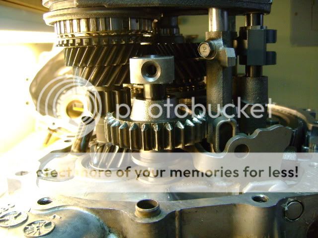

Glad to see you are doing it yourself. Not too bad, just watch that you put that idler hear and shaft back in correctly. I put it back together late at night, then turned the tranny over and it sounded "clangy." Waited till the next morning, broke it apart again and saw I had that idler gear on top of that lifter arm instead if it riding in the groove like it should.

well im not sure what the idler shaft is. All i know is how i took it apart......and im sure there was an easier way than what i did. any on have pix of what silver_slotege is talking about?

That's the one I was refering to. You can see the little channel on the bottom of the gear. That lifter arm rides inside it. Mine was sitting on top of that. Don't mean to cause any unnecessary concern, just pointing out my stupidity. Haha.

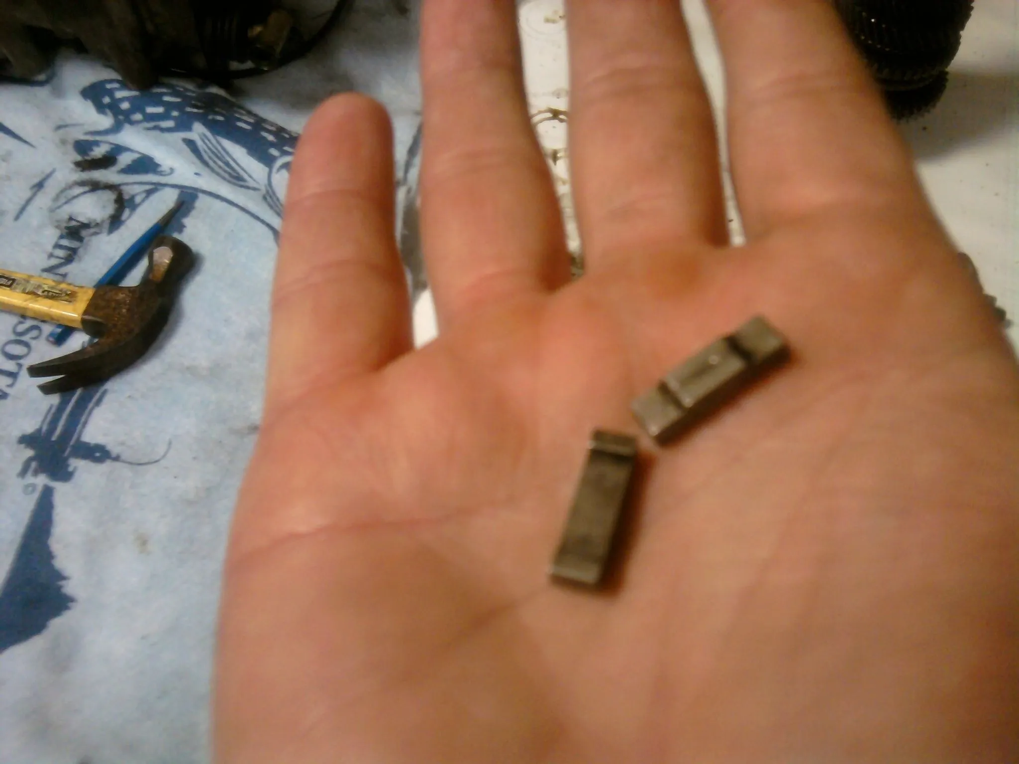

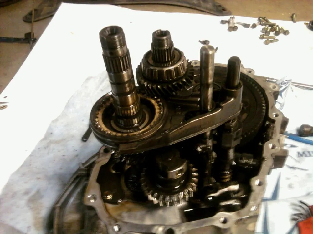

so two small things fell off when i pulled off 4th gear
what are the small rectangular things that look like woodruff keys?
when i took the shift fork off, these fell out of something. i know where everything else goes, just not sure about these

ordered a new shift fork and supplementary tranny manual. cost around $70 for both. anyone know what those two peices are above?
Yeah those are 2 of three of the retainer keys installed in the synchro hub assembly. They're a b**** to get back in.
