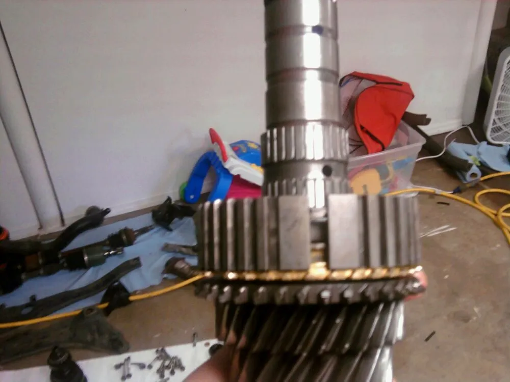

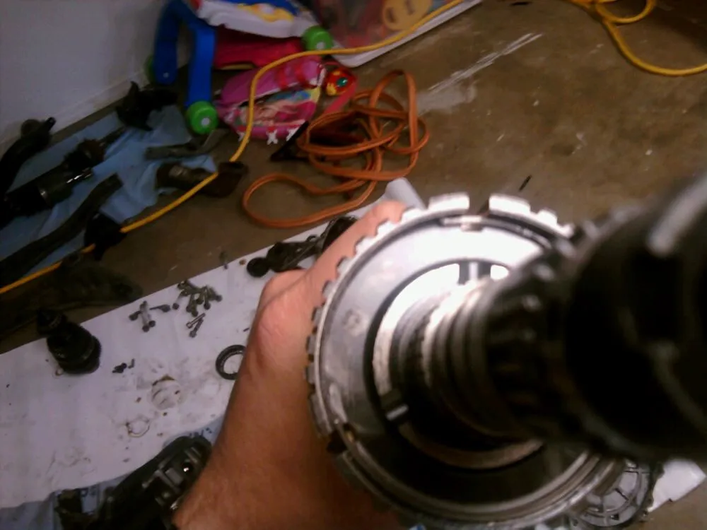

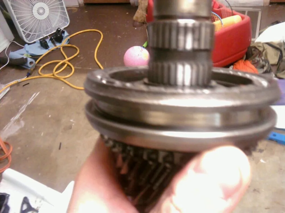

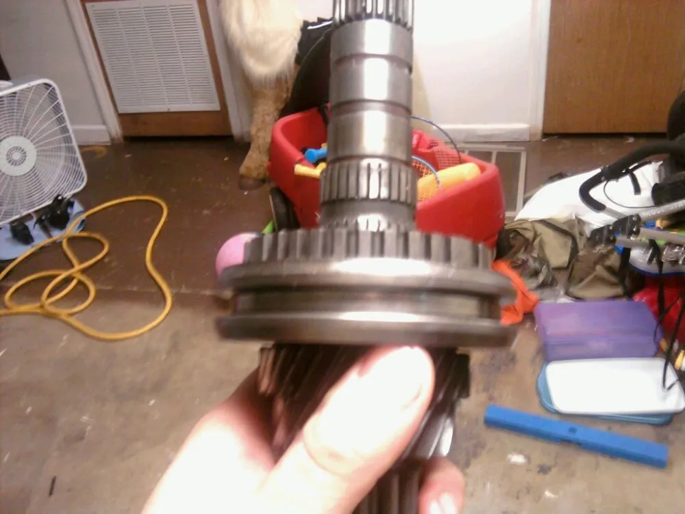

found the retaining clips......i took some pix just need to upload them onto my computer.

Ok, you need to lay them out on a clean sheet of paper. ALL of the larts, keys, retainers, synchros, outer-race, everything. I will be able to tell you then.

i already have the tranny back in the car and i used protigy's how-to and using what i remember. wasnt as hard as i thought really. not scared of doing it anymore. just really wish i had that supplement manual from mazda.
ok....mission accomplished. The car is now up and running. I have no major issues other than just taking time to break in the clutch properly.
Thanks for all that positive contributions in helping me get this thing on the road.
Awesome. Glad it worked out. And glad you got that synchro assembly back together!
