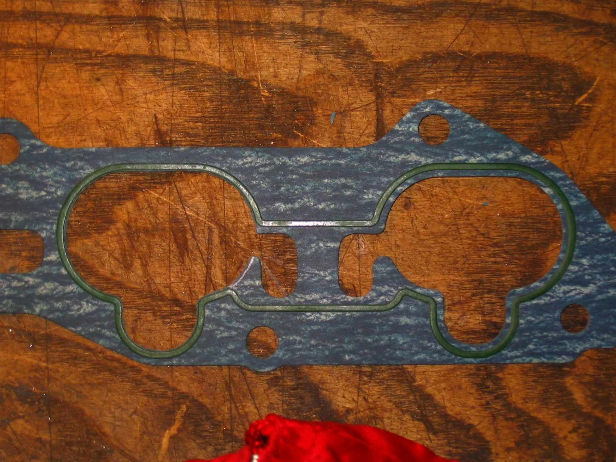

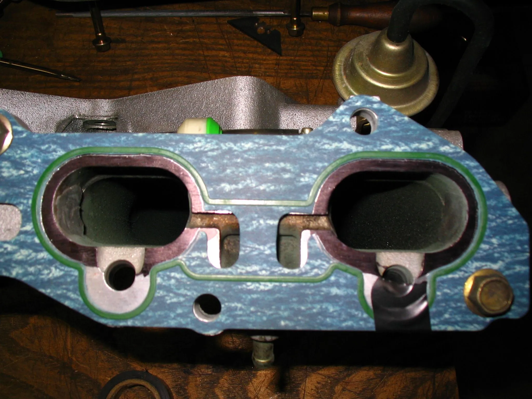

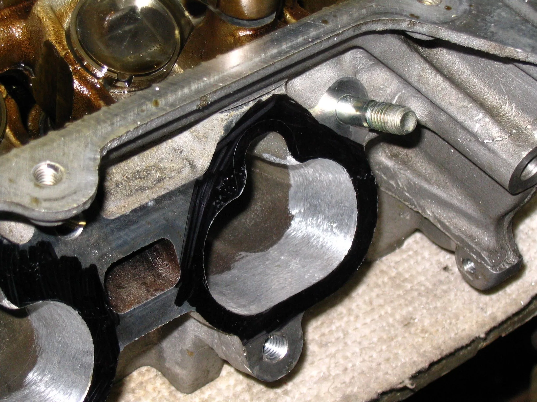

In FSP the intake manifolds are unlimited so I knocked off all the weird casting flaws and polished as much as I could reach. The head can be modified within an inch from the gasket surface like you said. I actually ported the gasket slightly bigger and then matched the manifold and head to that spec. Everything should still be within the rules. I started a thread for it somewhere, but I haven't updated it. I'll post the link when I get all the pictures in there.

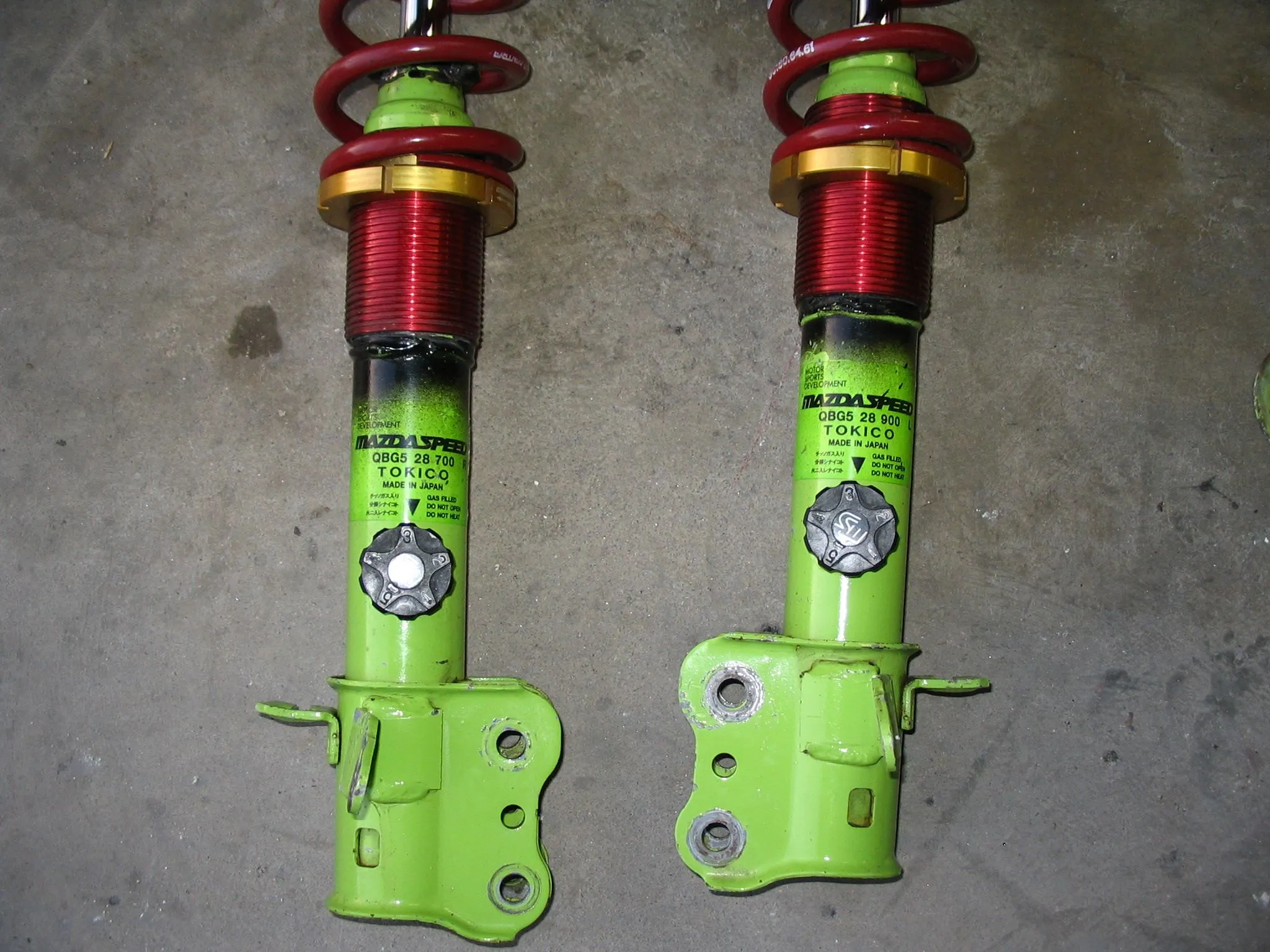

The struts I got were the JDM Mazdaspeed Adjustable struts. They are the green ones that Corksport used to sell, but they are discontinued now. I got word from Tripoint that the people who tune their shocks can revalve mine for whatever I want to do for $200 in case I get into some crazy springrates. my rear springs are already making my MSP struts cry. Anything that upsets the car mid corner gets the rear end to start bouncing instead of just sliding. Hopefully these new struts will be a little better on the dampening. I don't need much. It's just not right enough now to be annoying.

here are a few pics. The first is the head that shows I didn't go over an inch into it. The second picture shows how much larger my port job is than stock and the last picture just shows how I trimed the gasket to make the openings bigger.

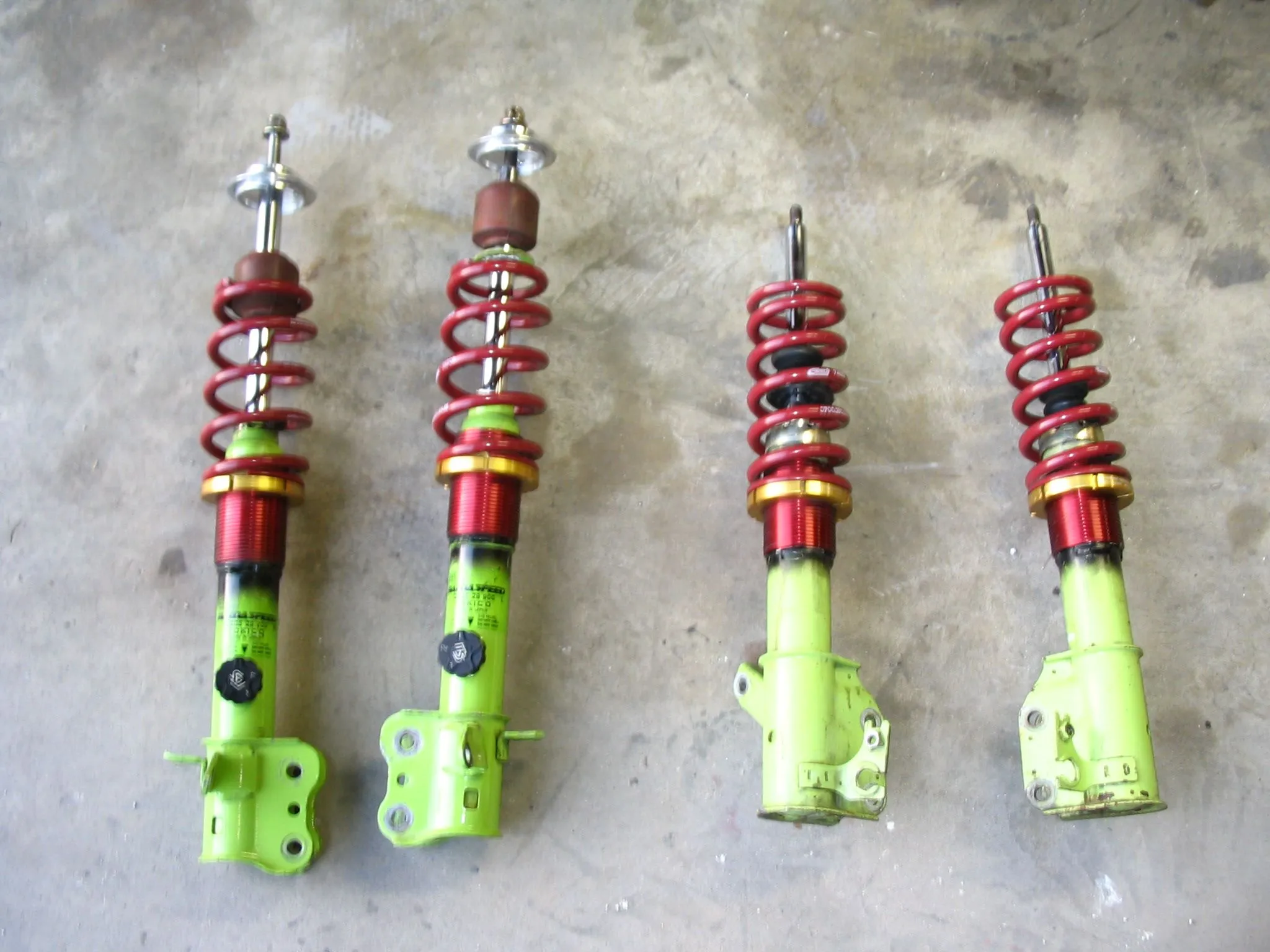

Oh man. I'm having a hard time not just driving my car around non-stop now. I got the struts in today. Absolutely fantastic. These things are amazing. I've got the fronts set on 2 and the rears on 5. The rears handle the 450# springs with ease. I'll still be upping the springrate on the front as I still feel that the car dives too much under braking and turning, but they only have 300# up front right now and I'm planning on going with a 375# front spring. I'm still working with the ride height to keep the car off the bumpstops, but I should have that finalized early next week. The car handles brilliantly with the daily driver all season tires. I cant wait to mount up the Victoracers and take her for a spin.
