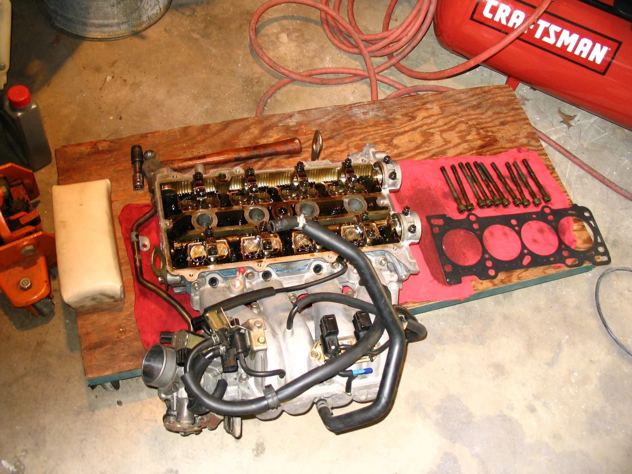

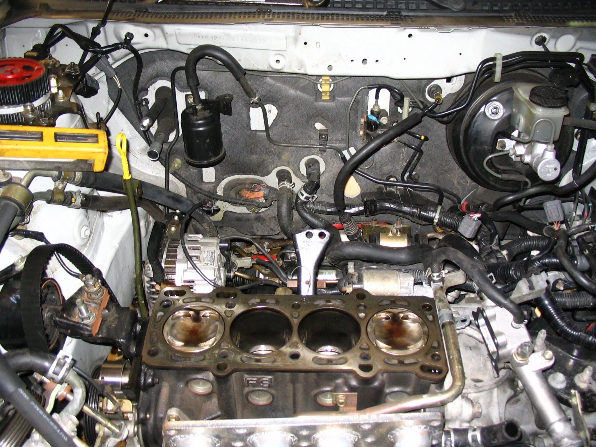

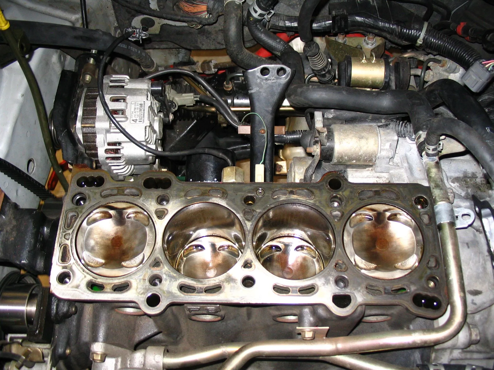

Taking a break from buttoning everything back up. Thought I would post a few meaningless pictures. The pistons were really carboned up so I cleaned them. They are so pretty now it sucks to have to hide them.

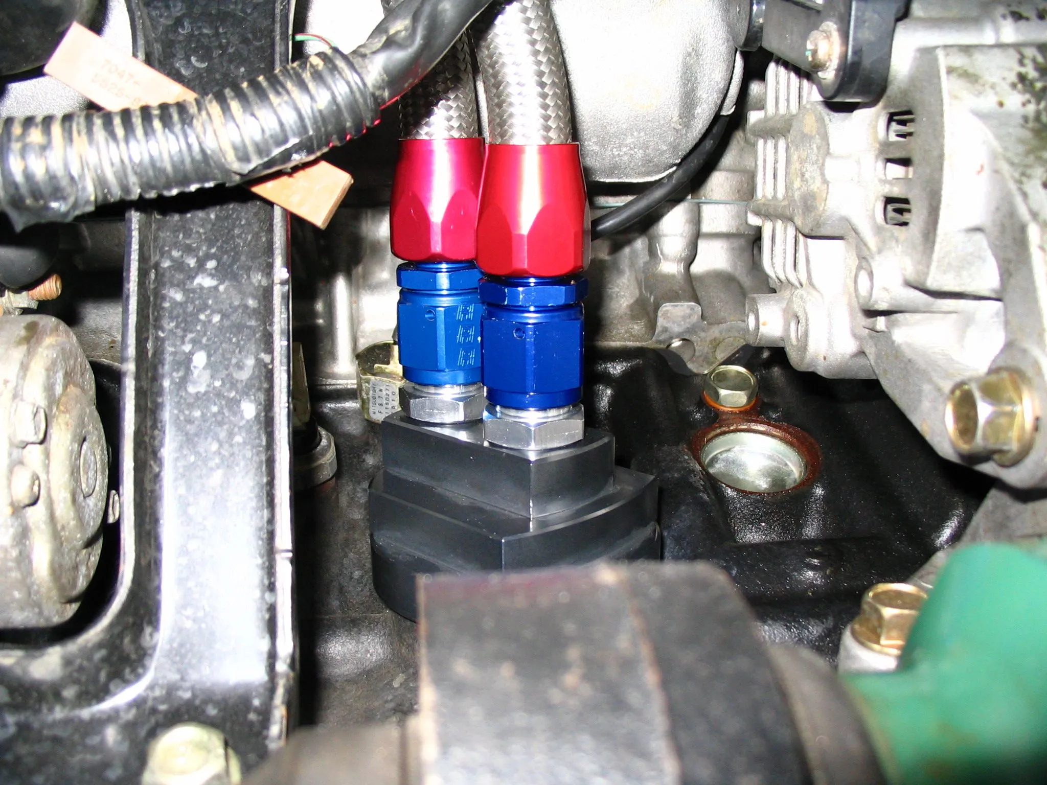

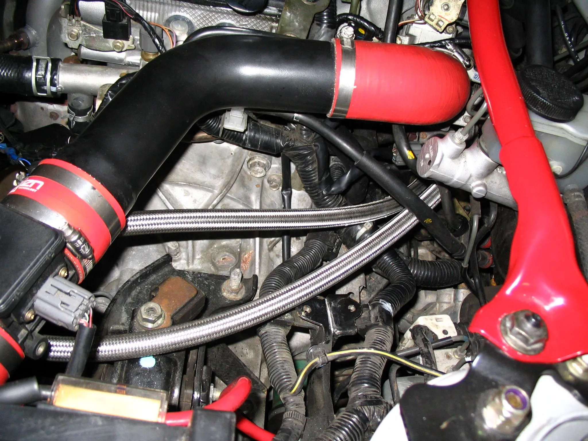

Sorry I haven't posted in a few days. I've been fighting with an oil leak and a mysterious CEL that I couldn't find the cause of. Finally had the code pulled (P0106). The CEL came from me messing up the routing on one of my vacuum lines. The one that goes from the bottom of the manifold near the alternator to the sensor that sits behind the cruise control. I had that messed up and it threw the CEL which I thought was a misfire due to fouled plugs...wrong. So then I thought it was the EGR valve in the TB sticking...wrong. Finally noticed that the sensor was missing it's vacuum line. The oil leak came from my oil filter relocation install. Suprisingly enough it never leaked from any of the line fittings. Only on the oil filter mount where the 2 plugs are for an oil pressure sender. I can't get one of them to fully seal even with a good bit of teflon tape and some seal all. I'll be pulling it back out on Friday to RTV the s*** out of it. It only leaks under high pressure...it won't leak while it's idling so I didn't notice it until after I got a good distance away from the house. Here is pictures of the final install that.
I also just got word that my package came in from Mr. Potter and I'm excited to say that the Protege should be sporting adjustable struts by this weekend.
