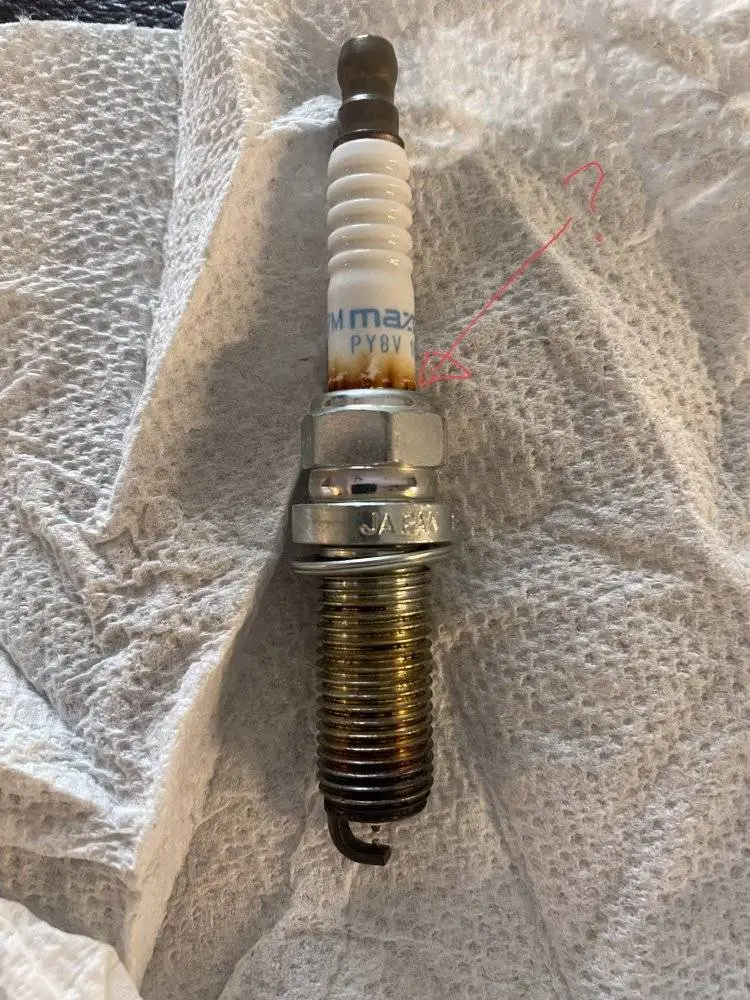

Just changed the plugs, 35k miles. Are the burn marks normal? All 4 plugs were the same.
Looked closely under a magnifier, didn’t see any cracks, just the discoloration.
It’s been a while since I have changed any plugs, however I don’t recall seeing this before.
Thanks.
looked closely under a magnifier, didn’t see any cracks, just the discoloration.
thanks.

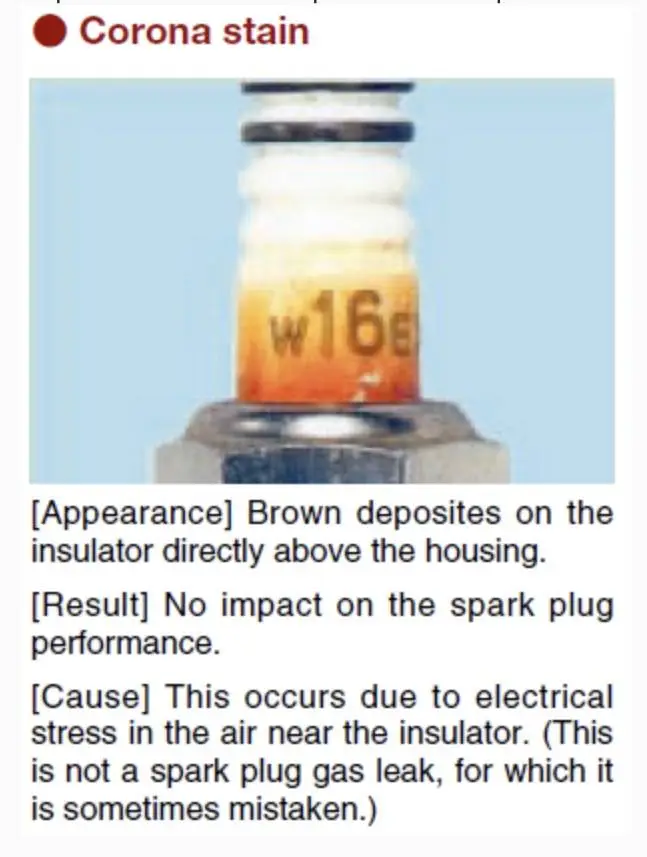

Corona stain???
The only part that matters is the gap and the nose of the insulator that's inside the combustion chamber. You didn't show that.

Anyway all mine looked that way too when I changed them, its normal.
