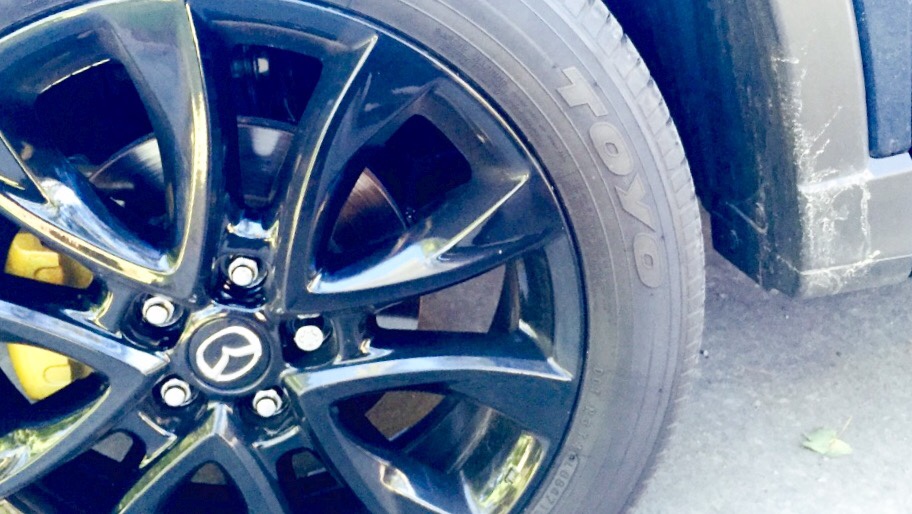

Just thought I'd show some pics of my stock wheels with spacers to make it more flush to the fender. I think 20mm on the front & 25mm on the back are just about right with the stock tires. The pics look like their in a little but the rims are really pretty flush (3rd one is best).
I got them on Ebay for $88.
http://www.ebay.com/itm/171845308831?_trksid=p2057872.m2749.l2649&ssPageName=STRK:MEBIDX:IT
I want to lower the car more than put new rims and tires on a brand new car so this will do for a while.

*Wow, that's too bad. Use to see V Projects for sale all the time on Ebay, hopefully they come back in stock. I bought them in October, great quality spacers at third or fourth of the cost of H&R lol.* The stock wheels fit nice and snug onto each spacer center ring. There is no detriment in stock ride quality when driving on either highways or local roads which was a relief to me. I was worried there might be vibrations or something. I torqued the spacer bolts to 100 ft lb and checking after 400 miles and the bolts didn't budge at all.* I got 25mm and 20mm for the back and front respectively. I recommend putting on some anti-seize onto the back of the spacers so, years down the road, it should still be easy to remove them off the hub.
The lugs did move slightly on the the torque wrench (yes, I'm talking about the spacer lugs and wheels), so I suggest being "anal", or proper, when it comes to lugnut torque on spacers and wheels. It's the only thing holding the vehicle to the ground [emoji106]
