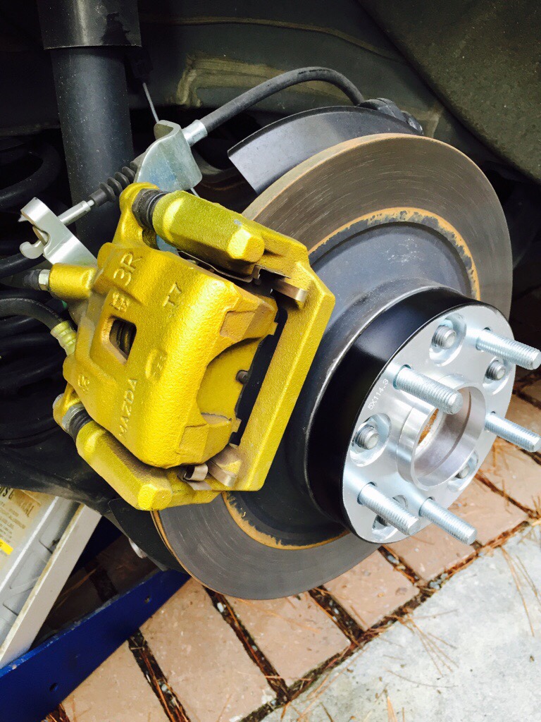

There is actually a kit on ebay that includes 2 20mm and 2 25mm spacers for those that want that. I bought some different ones from another member on here but they are silver. What are your guys thoughts and painting them black? Should I just paint the outside edge and leave the mating surfaces alone or do you think it would be ok to paint the whole top side and edges? with the dark wheels of the 2016 I don't want a silver band behind the wheel. I should have waited for the V-projects to go back on sale. Oh well, live and learn.
Post #11 and 14 shows I did what you asked. I would not recommend any paint on the mating surfaces. It only took about 30 minutes of prep and paint. Still no issues as of today, so I wouldn't worry about your purchase.
What did you use to paint them? Just rattle can Caliper or high heat paint? I've got a few cans of Engine enamel laying around that I was thinking of using. and did you prime before hand or just use the paint?
