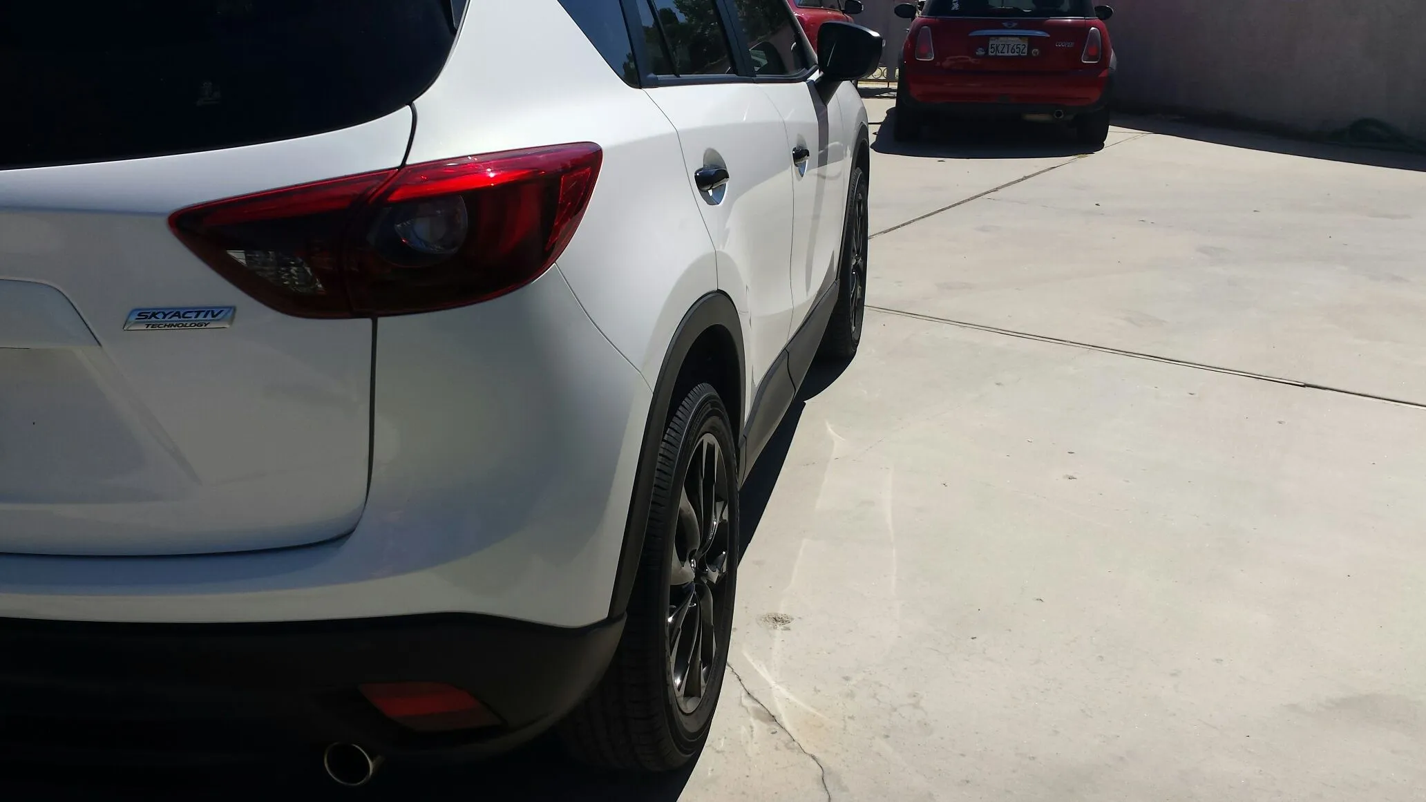

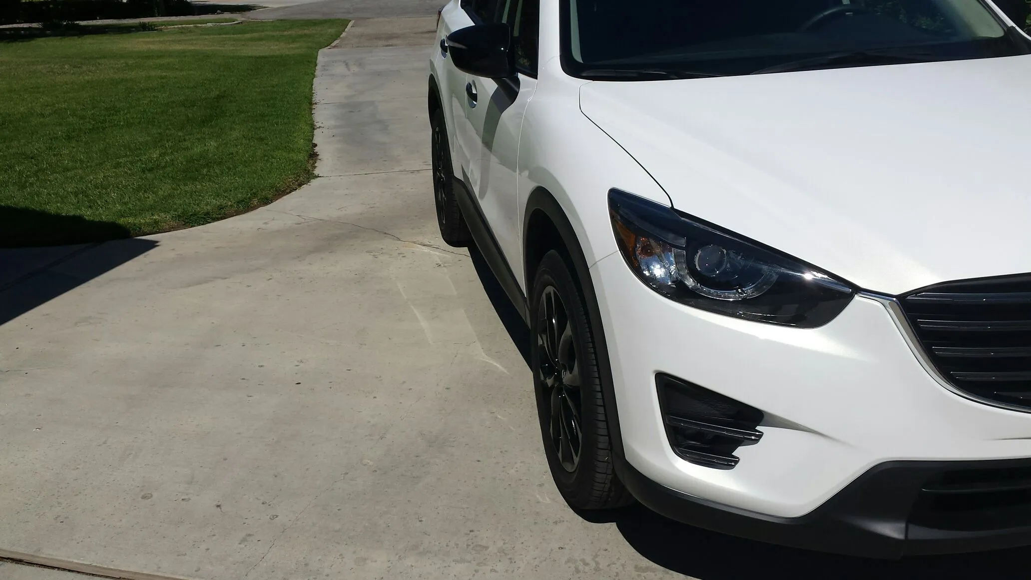

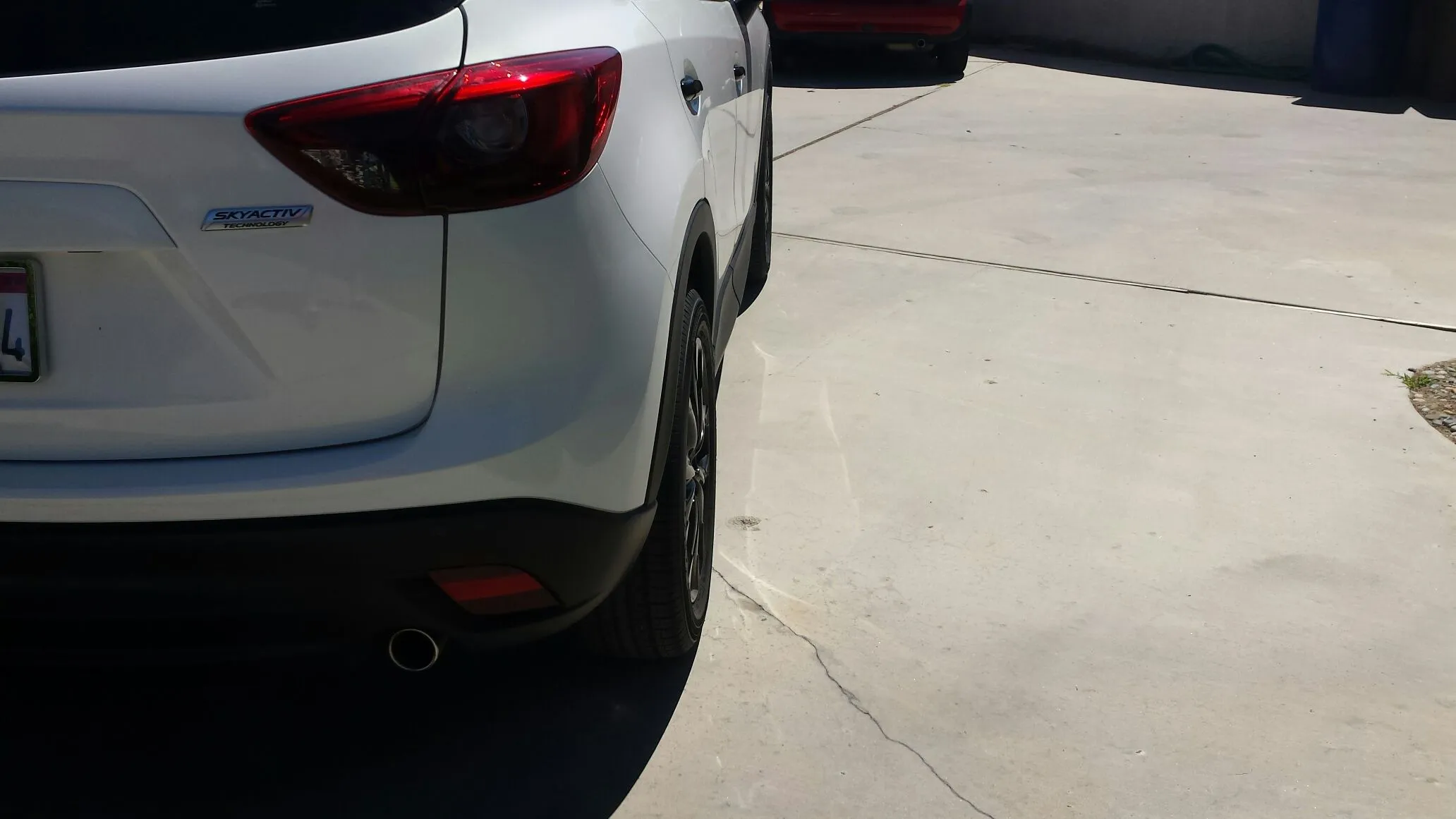

Just thought I'd show some pics of my stock wheels with spacers to make it more flush to the fender. I think 20mm on the front & 25mm on the back are just about right with the stock tires. The pics look like their in a little but the rims are really pretty flush (3rd one is best).
I got them on Ebay for $88.
http://rover.ebay.com/rover/1/711-5...2&toolid=10001&campid=&icep_item=171845308831
I want to lower the car more than put new rims and tires on a brand new car so this will do for a while.

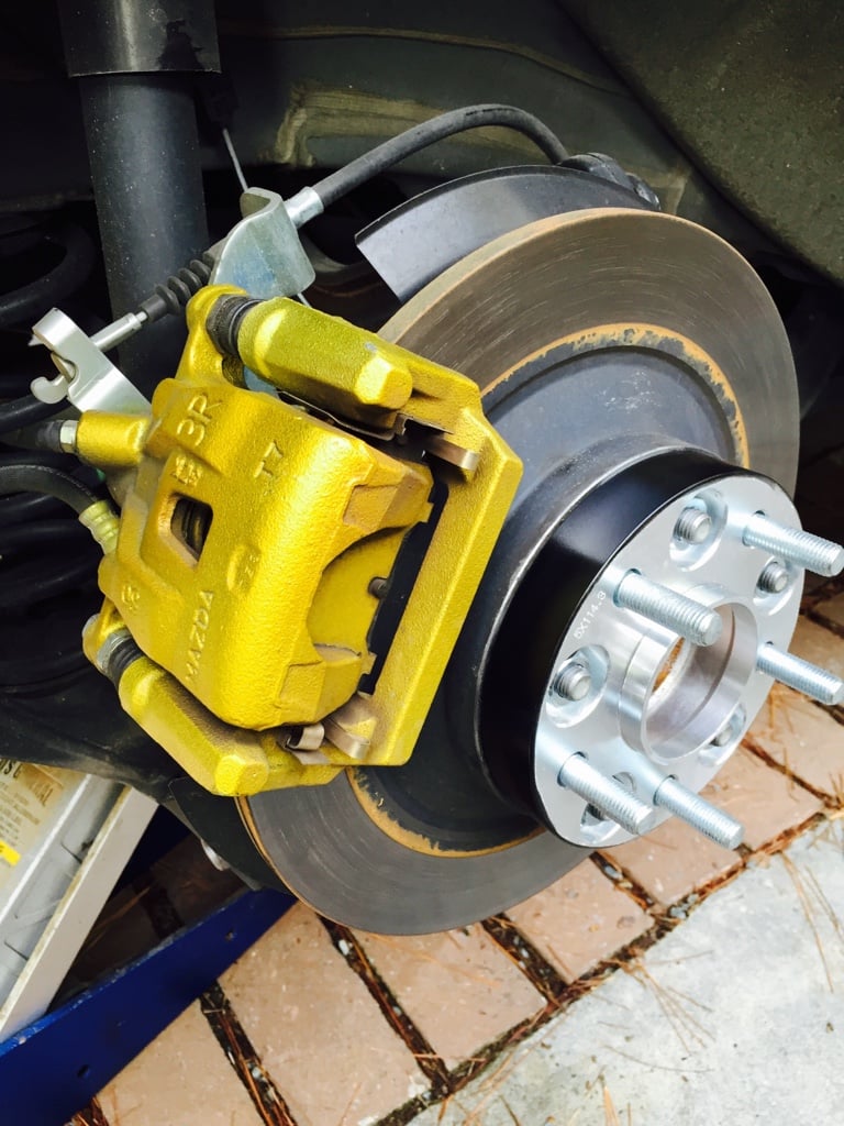

No problems, straight bolt on. Don't forget to torque them.. I've seen 80-108 recommendations. I did 90ft lbs and rechecked, seems good.

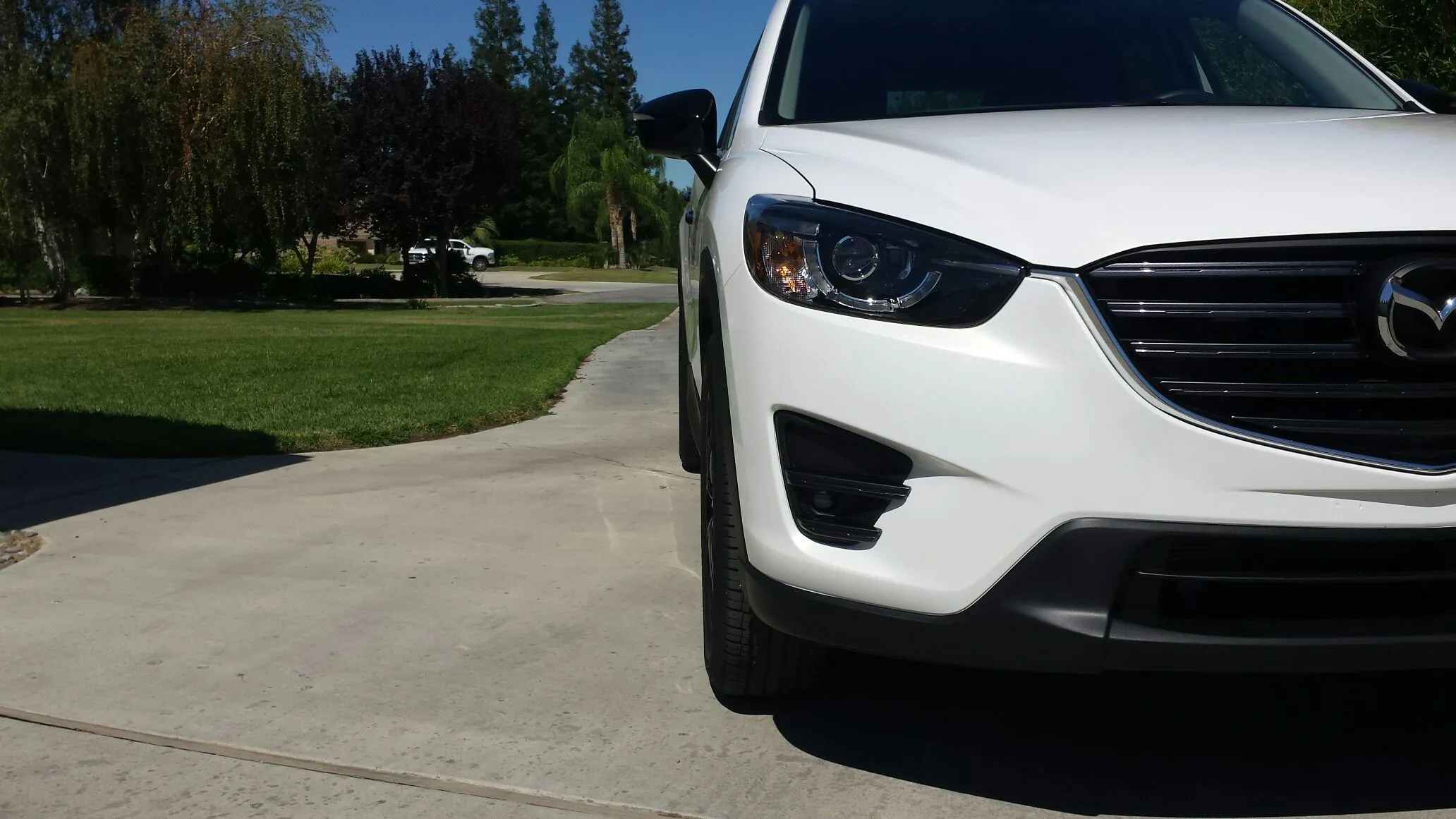

I received my (2) 20mm aluminum front, and (2) 25mm spacers for the rear. They are the type has it's own studs built in. It may be hard to tell from the pics, but it totally changes how the CX-5 stands, and they're very flush to the wheel wells. It's almost like my CX-5 swallowed a... errr, a certain blue pill like in the Fiat 500XL commercial!
I test drove it to about 75mph and it feels no different than stock with no vibrations. Then I retorqued the lugs to specs. Shout out to Mondo for his thread and suggestion!

Just a point for those who are anal - If you're worried about re-torquing, you really need to take off the wheel and re-torque the spacer (assuming its body is machined aluminum as most of them are) and then come back and re-torque the wheel again.
The lugs did move slightly on the the torque wrench (yes, I'm talking about the spacer lugs and wheels), so I suggest being "anal", or proper, when it comes to lugnut torque on spacers and wheels. It's the only thing holding the vehicle to the ground [emoji106]

Re torquing spacers are just like re torquing wheels. Which, basically means every time an aluminum wheel comes off the car, it should be torqued to specs, then re torqued after about 50 miles. Assuming your lug nuts, mounting surface, hub, etc. are in good, clean, mechanical condition, that's it.
One of the reasons for re torquing is due to different metals contracting and expanding together along with different loads on the area. Re torquing ensures all surfaces and applied loads "settles" in the affected area (hub). Here's a quick Google search explaining it-www.kaltire.com/why-re-torque-the-importance-of-retorquing/

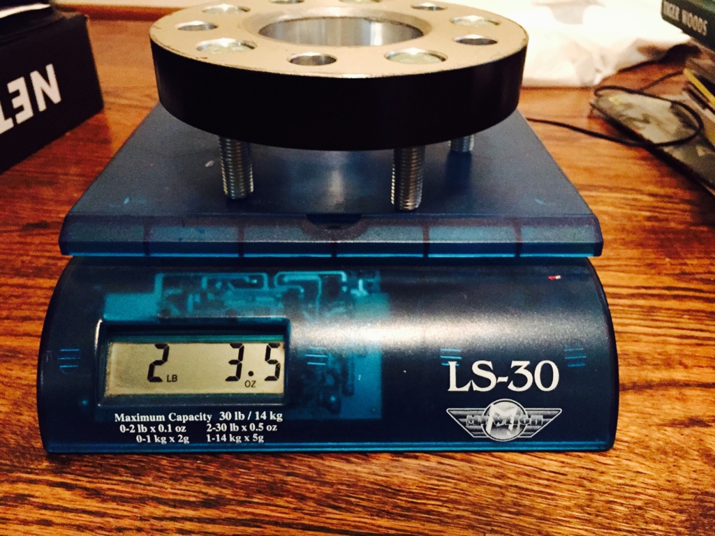

How much do these weigh? Is the added rotational mass worth it?
The extra rotational mass is pretty negligible, since it's concentrated at the hub. It's unsprung weight, sure... but it doesn't have much effect on the wheel's moment of inertia about the axle.
I have installed 20mm spacers to front and 25mm to the rear and this set up is perfect for the OEM 19s
The wheels are just flush with the guards.
The V-project spacers weight in at 25mm 1.925kg for two front spacers and 2.106 for the two 25mm rears.
I used kitchen scale to weight these. Basically total weight of a little over 4kg.
The quality of the spacers are good and the studs are also good quality as well. I have gone through a lot of spacers with my Miata.
I will get some photos up as well when I get a chance.
