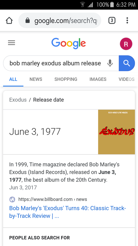

Bob Marley's Exodus, which is the number one album of the 20th century and the first album I ever owned that I wore out.
I played it thousands of times.
Apparently, the deep rhythmic bass tones of raegae music mimics the mothers heartbeat.

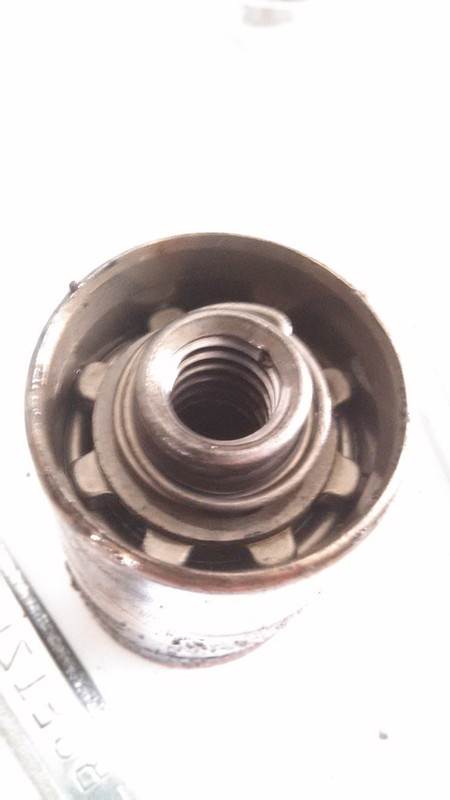

Sweet I remembered how to do that lol, the girlfriend got an 03 pathfinder for her "new" daily, super nice rig. Cracked tailight and the ugly hood were on the new car, swapped those over to yeller. Got some tokicos and rb springs from my buddy mark with the yellow mp3 (lucky bastard doesnt have a kid and got BC's, JEALOUS!!!) Unfortunately the front are blown as I could compress the shock by hand and one didn't even bother trying to push back out. I couldn't get the rears apart, the nut on top is siezed on both and rotating the whole shock shaft, so that's a no go. Are the Blue HP tokicos really discontinued? I see street unit and a couple other places still have them on their catalogs. I emailed street unit for now, I might have to pull yellers setup for now to get me from A to B. Those shocks on the new car are DONE. Well ima try to get some sleep, we'll see if I get a chance to do my brakes this weekend........and what car ima put them on Hahaaaa 😭
