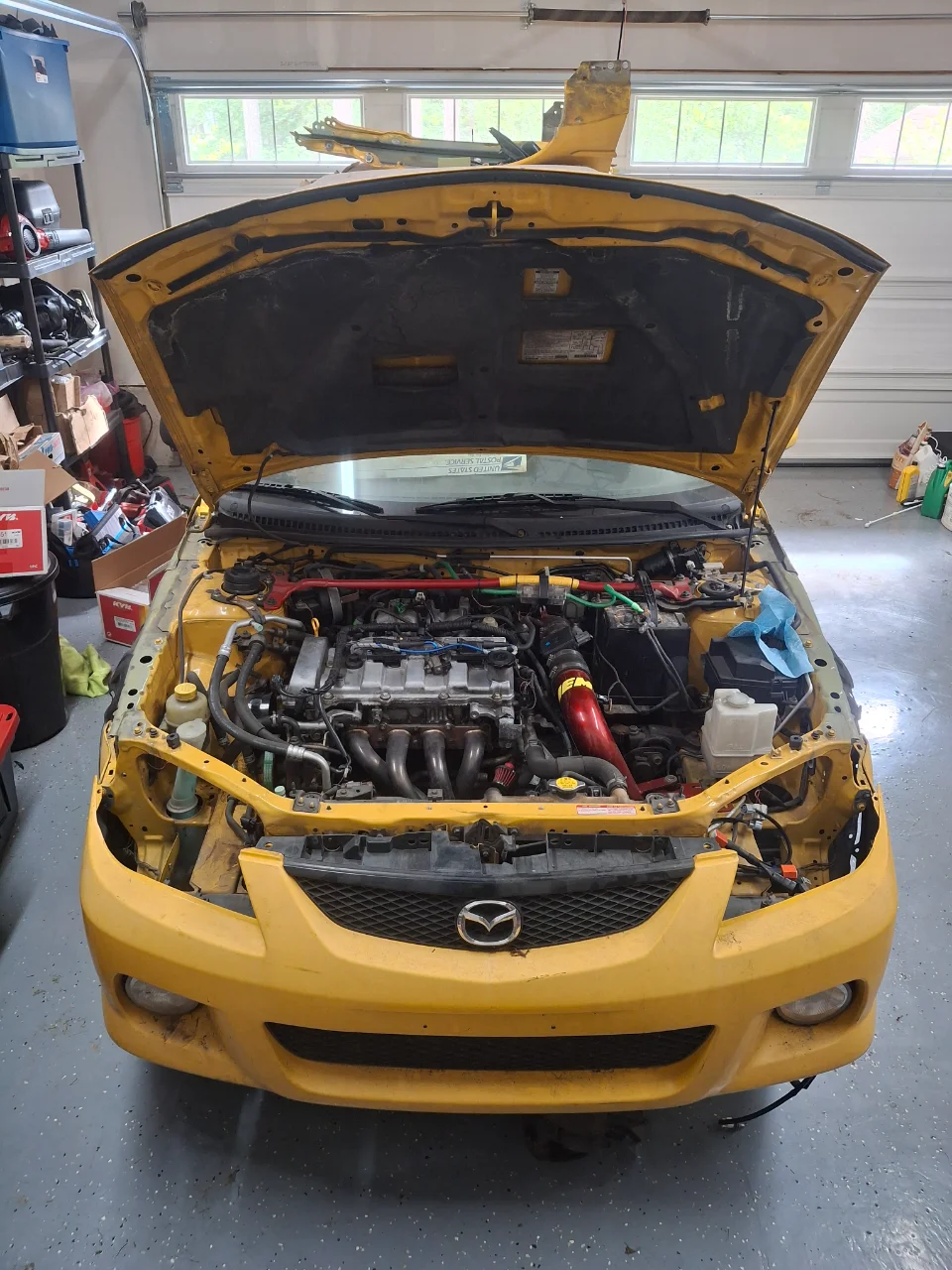

Well guys it's been quite a while since I was active here. Been through a lot in the past 5 years, moved twice, had a kid, switched careers and got dumped by the babysmama for a deadbeat 😂 I ended up getting rid of the 02 p5 unfortunately, snagged a yellow 03 with the sunroof but no roof rack. 234k with bad valve seals (found out about 300 miles in haha) the car sat for a good number of years with little to no work done to it. While it was down I got a beater msp for cheap and played around with turbo stuff for a bit. After blowing the diff I swaped a junkyard open diff trans in and shortly sold it to my buddy. He recently rear ended a van and now I'm on track to buy it back. Taking the engine out and putting it in the wagon so I can finally get back in a p5 and enjoy the car. Current build plan is mp3 ecu, oem intake with vtcs delete, aem short ram intake, mystery 4-2-1 long tube header off a ford probe or mx6, megan racing cat back with msp muffler, fsze Intake cam (needs some tlc), exedy stage 2 clutch, fidanza lightweight flywheel, awr engine mounts (mystery durometer) moog greasable endlinks, msp front sway bar, progress rear swaybar (21.5mm??) Megan racing trailing arms and lateral links, mx6 rear strut tower brace, drilled n slotted rotors, braided steel brake lines, mystery short shifter, sparco shift knob, sparco pedal set, sedan headlight swap with Matthew's plug n play adapter, jdm tails (still too poor but one day) msp racing hart wheels and eventually I'm going to add my reinforced msp diff to my non abs transmission (waaaay down the road more than likely. Whew that was a lot, I'll try to keep posts succinct from here on out and see if I can keep some some regular progress going. Pics soon to come! (She ain't pretty..... yet)

As she sits now

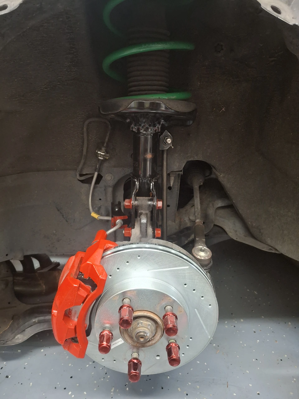

Got the front end cleaned up and put back together, rear end next. Might try my hand at rewelding some bad welds on my headers.
