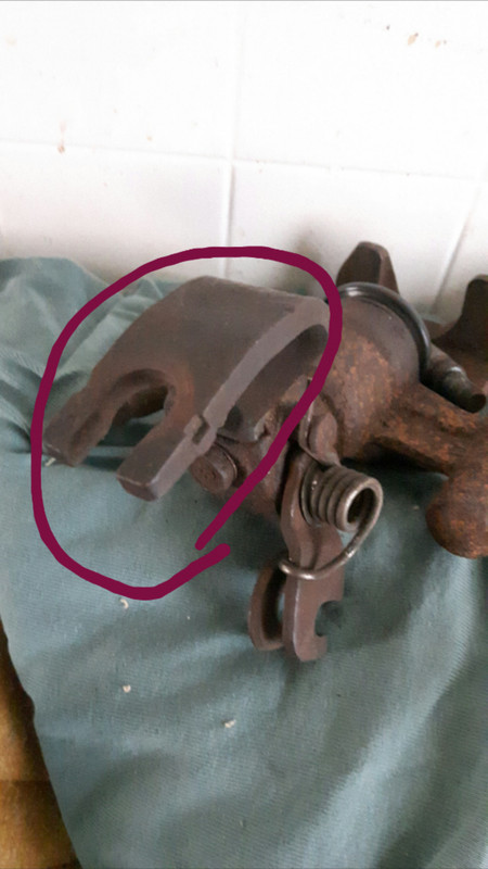

I believe it's this part that's missing from the 626 calipers.
That mounting bracket needs to be properly oriented and have the proper distance to the attachment point.
There is quite a bit of pressure on the bracket and I wouldn't trust a bunch of zip ties to hold my car.
