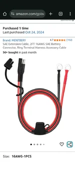

Most of chargers come with ring connectors (in addition to the black/red jaws/clamps) that you can connect to the battery terminals and just leave them there. That way you can connect and disconnect the charger without popping the hood.

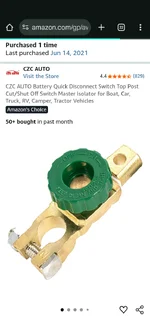

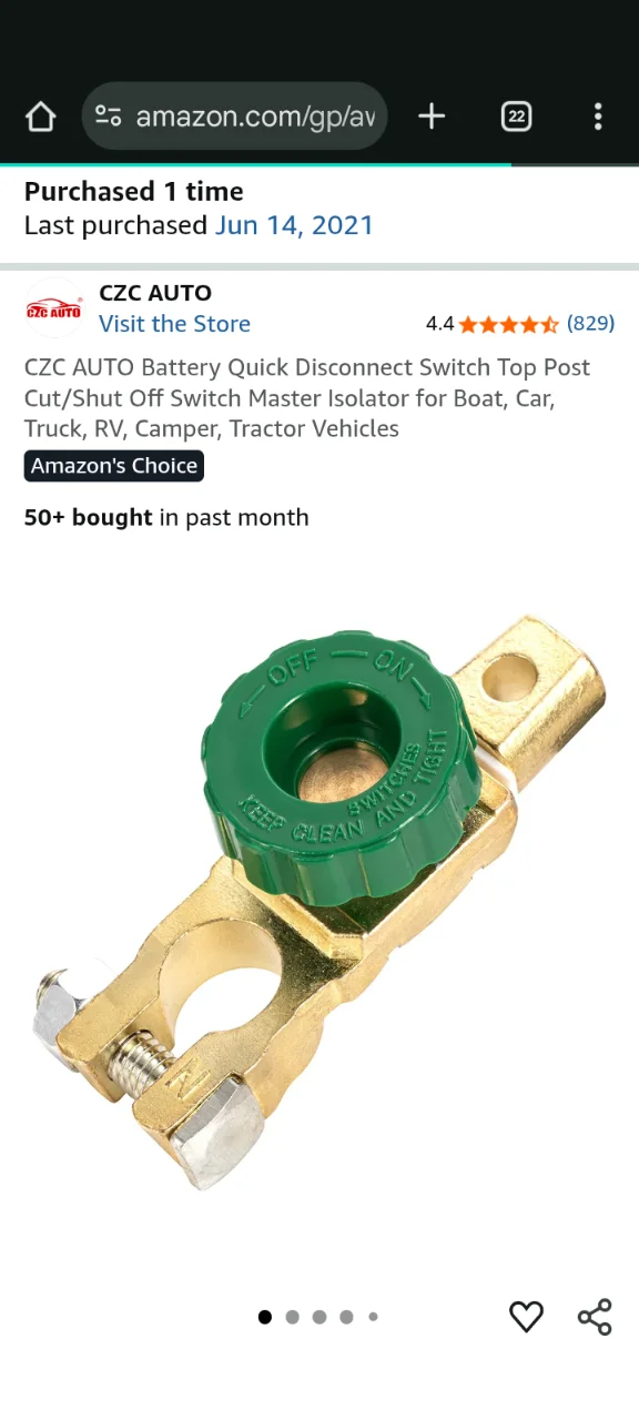

By ring connectors I mean something like this. I also use the quick-disconnect (green) on the car that I am working on. It's easier to twist off the green knob than taking the whole terminal connector off.

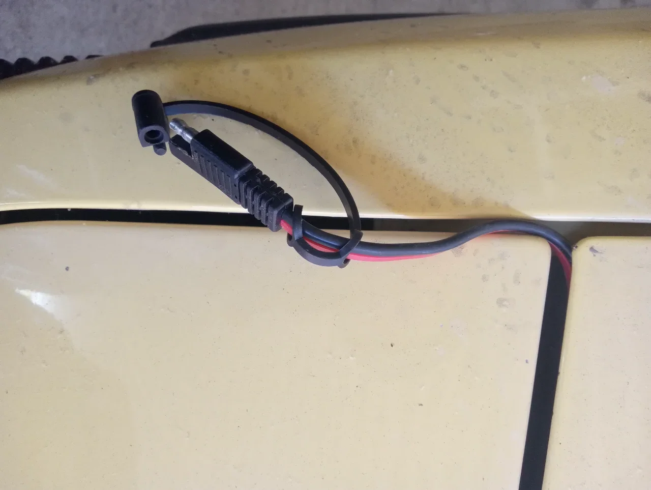

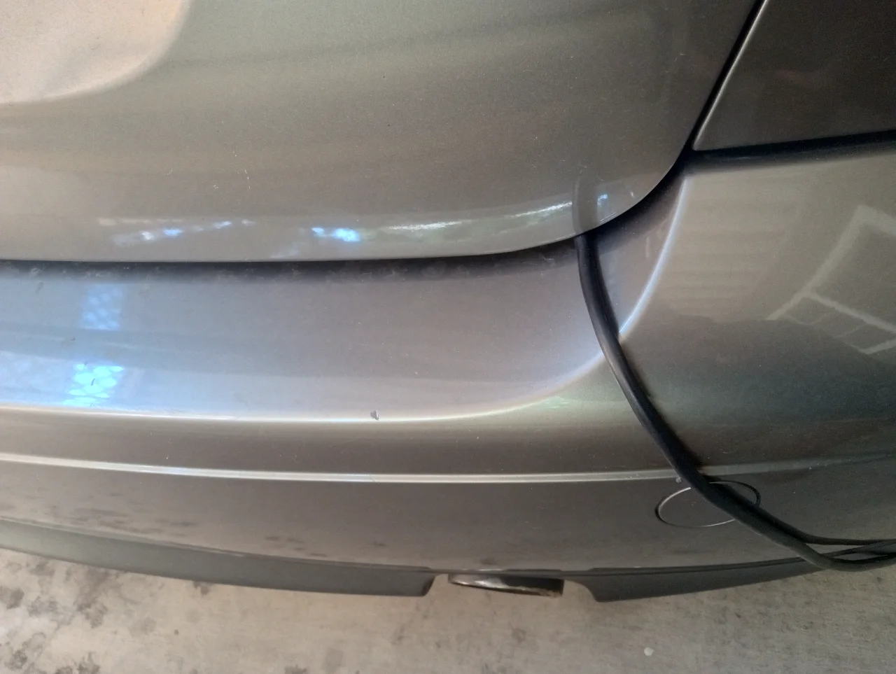

For the CX-3, I route the charger-connector wire from a gap in the plastic trim piece and let the end sit next to the base of the wiper arm. For the R56, the battery sits right in front of the cabin air filter port so I push down the filter a bit to route the wire into the cabin.
