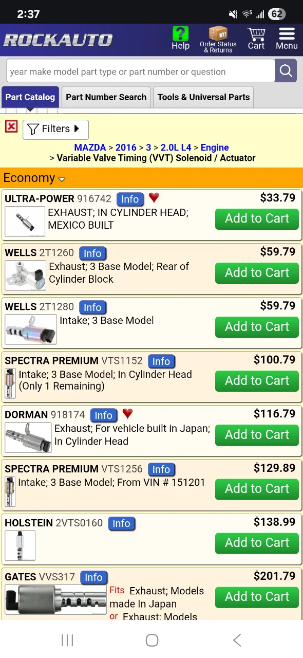

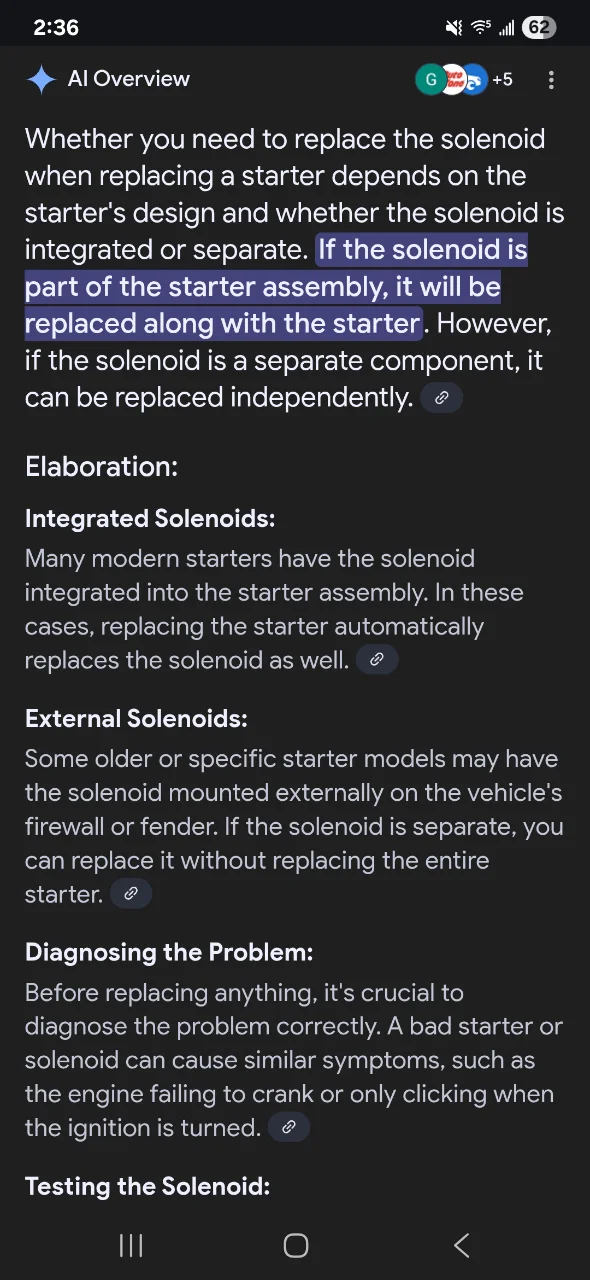

If I were to replace the starter motor, what other component(s) should I also consider replacing? I'm assuming the solenoid comes with the starter motor.
The starter motor is considered as an "electrical" component per Rockauto category. The type of solenoid Rockauto sells though is considered as an "engine" component (see pic below). Is this the solenoid that is for the starter motor or not?

There's a solenoid in the starter, it's not separate.
