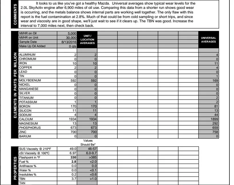

The factory-fill UOA of a 2015 Mazda 3i Sport from here indicates the same thing - molybdenum content is very high at 608 and factory-fill is probably Mazda Oil with moly.My sample just got in.
So it looks like the factory fill is probably Mazda Oil with Moly. TBN shows that I could have stretched it out a lot longer. So for those with brand new CX-5's, stretching out the OCI to 7.5K miles should be no problem. I am going to shoot for 8K mi OCI and will report back.

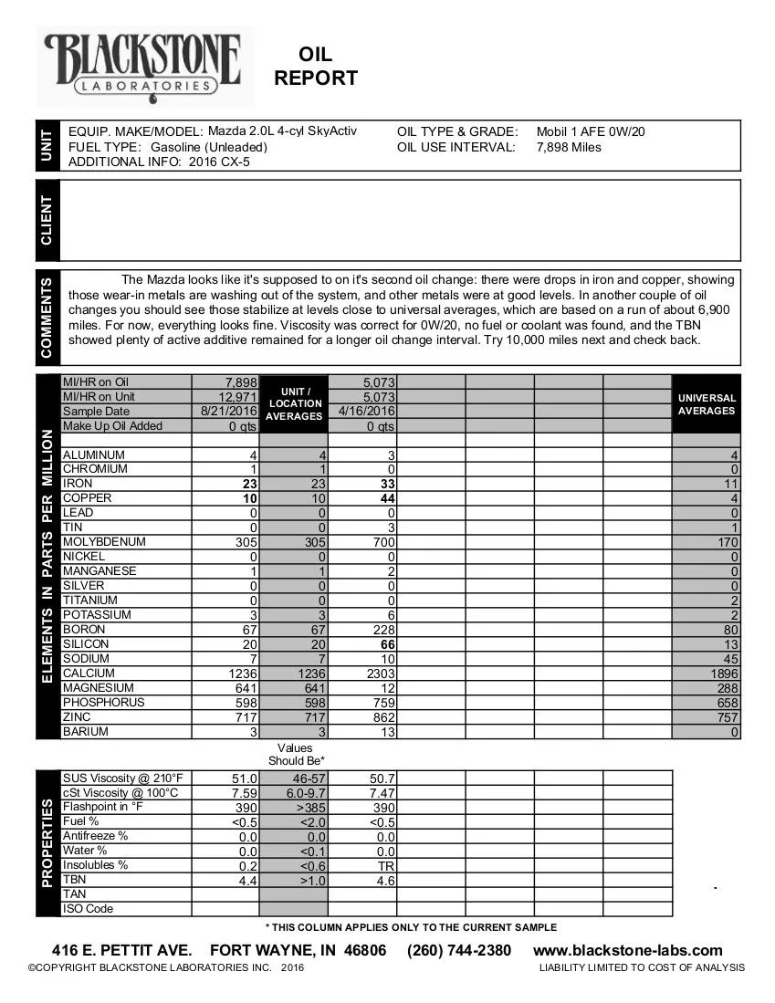

Here is Ed's oil report. I am posting it for him.
Did the oil change over the weekend for the CX-5. Used 0w20 Penzzoil Platinum available at WM at $23 for 5 quarts. Good to see the lab report indicate a 8k mile recommendation. I wonder why there's no TBN reading on the report though.
