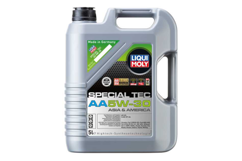

The UoA says 1 for Moly. LiquidMoly per the manufacturer claims it contains MoS2, hence the name. A reading of 1 is practically non existent.
Nothing says it contains moly:
Modern premium-class fuel-efficient engine oil, which especially has been developed for the year-round use in Asian and American vehicles. The combination of unconventional base oils using synthetic technology together with the latest additive technology guarantees a motor oil that provides exceptional protection against wear, reduces oil and fuel consumption and keeps the engine clean while ensuring fast oil penetration of the engine.
I stand corrected! I should’ve looked for the specific product used.

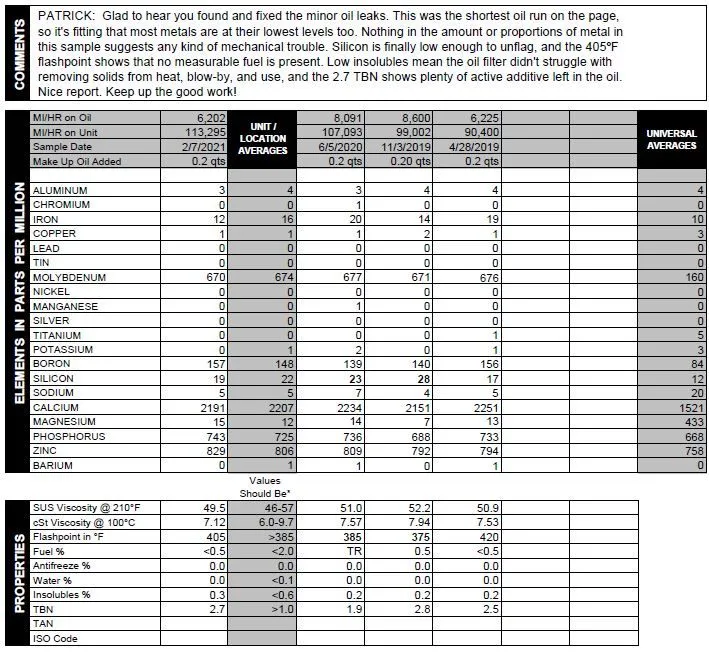

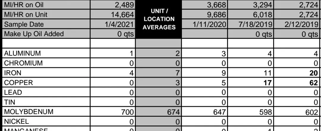

Here's my latest. After I did all the work with the valve cover and OCV gaskets, plus the transmission drain/fill and re-sealing the pan, I was about 1/2 quart low and we were about to go on a road trip. So I decided to go ahead and change the oil at ~6,200 miles. I did find the OCV itself leaking above the valve cover, so I need to replace that. But hopefully I have at least reduced some of the oil loss I was seeing. Still looking good so far at ~113,000 miles.
I bet you’re using Mazda moly oil, aren’t you? (y)

The test was done long time ago. I can only guess they either bumped up a bit the moly or there is slight variation in batches.
On my past 4x different tests Moly is from 590 to 700 :) Notice that I dont even drive that much between oil changes. Go figure.
Nevertheless the oils with so much Moly (600+) that I know are the Mazda oem and Toyota oem 0w20.

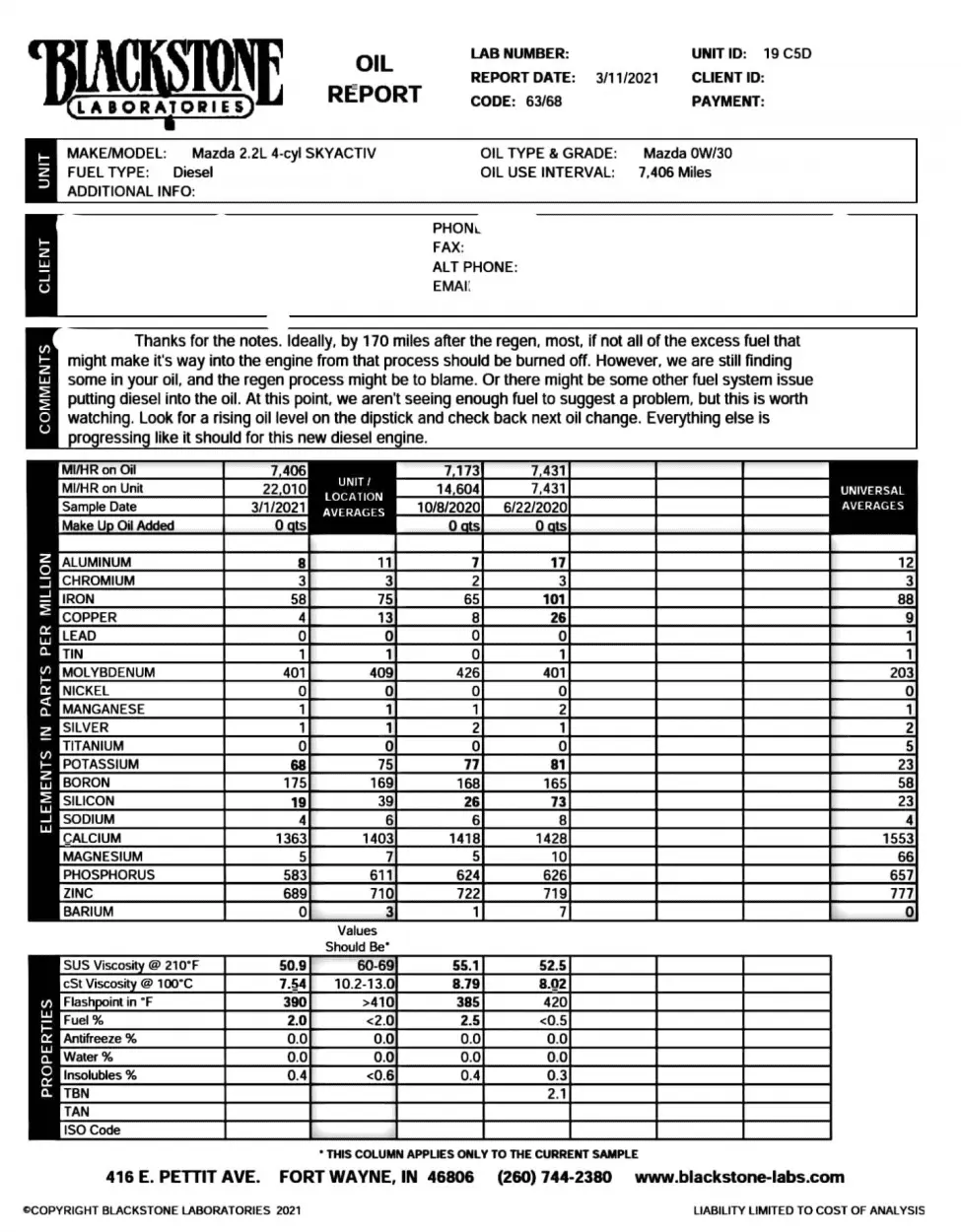

My latest 2.2 diesel uoa. 22.5k mile service. Viscosity low again, 2% fuel, no oil level increase though.
Next service (30k mi) is the last of the free 2yr / 30k service. I'll be changing oil at 5k mi and see how the viscosity looks after the next service.

You had some silver in the oil? I wonder what part of the diesel engine is made out of silver.
Bearings usually have a coating layer. The diesel components are usually quite different than the petrol ones.
I still think based on the uoas so far that this engine needs more frequent oil changes. 5000 miles or less.
It needs more than 2% for diesel in oil so that it shows on the dipstick.
The TBN is good @ 7.5k but I don't like that the viscosity is low. I agree this will be better off with 5k mile intervals.
Odd as it sounds, silver is used in some high-performance engine bearings. I don’t know if Mazda does this or not, but that would be once source of metallic silver. Subaru owners see the same thing.

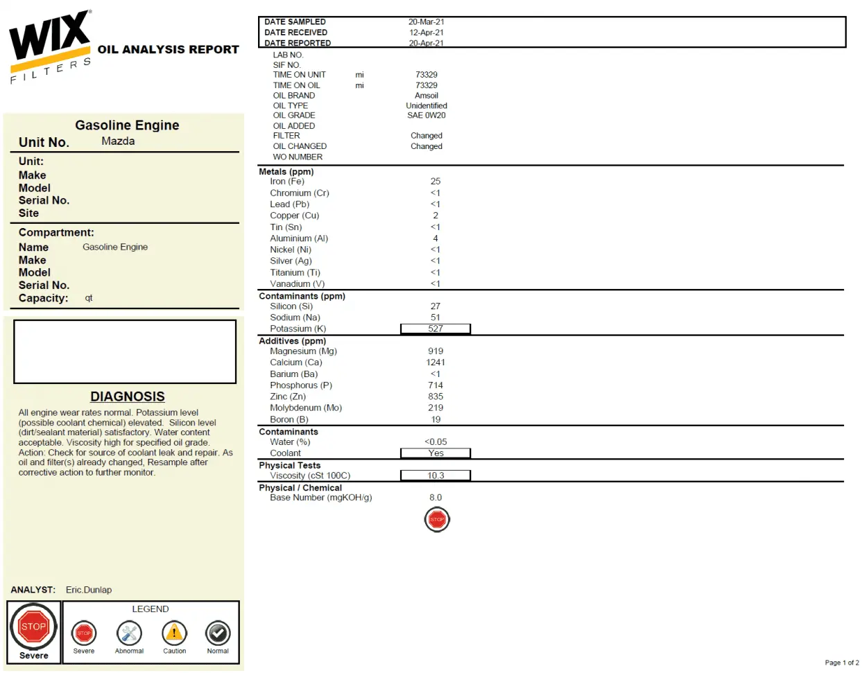

I did my oil analysis at 73K and apparently there's a coolant leak. I brought my vehicle to a mechanic 2 months ago and he did a pressure test but did not find any sources of a leak so I am not sure. I did put some UV dye in the coolant reservoir to see if the funny smell coming from my heater was due to a heater core leak but there wasn't anything noticeable.
There was another report few months back for coolant in the oil and a separate forum thread but no replies after February on the subject.
The general advice was to first do 2nd test at a different lab. Small quantity of oil sample can be taken out through the dipstick tube. i.e from the new oil at present without the need to change it again.
