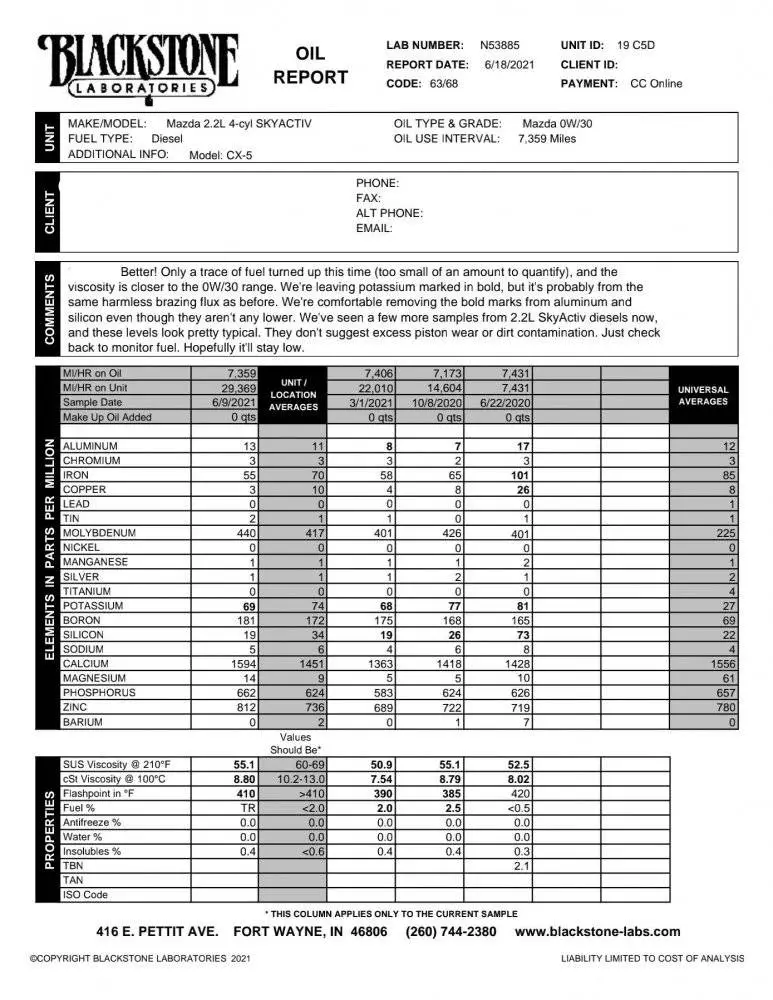

Last of the included "30k miles of free service" on our 2019 North American diesel. I'll be doing service myself from here on out.
Still continues to run fantastic. I love it. Great efficiency and power.
Latest UOA. There does seem to be a correlation between how many miles after a regen cycle and when the oil sample is collected for analysis on how much fuel shows up. Needs some time to burn off the fuel that gets in the oil. I know the two previous samples were not long after regen's and this latest one was hundreds of miles after a regen ...

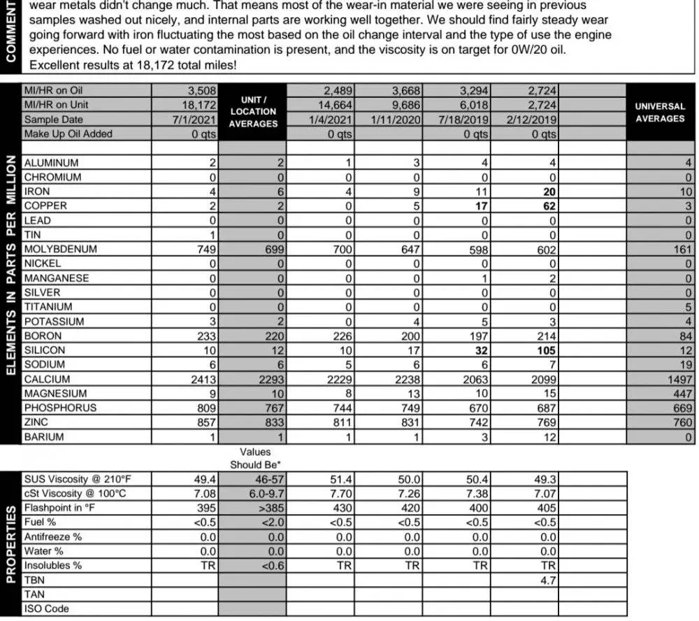

OK, that makes sense. I'll just send the most recent and go from there. Its from when they redid my pan in November. So not sure its all my oil. I had one jug (last one) of 0w20 that I gave them when they did the job. Figured winter was the best time to get rid of the last of the 0w20. Will be putting in my last jug of 5w30 PP in my upcoming change.

Nothing new in the report. Normal as usual except the viscosity and flashpoint are a tiny bit lower than before. Most likely due to the extreme heat Phoenix had in the past months.

Why do you think this is the case? Normal operating temp for engine oil is in the 230 to 250°F range. Would ambient temps ~20° higher there than in my area (110's vs. 90's here) make that much difference in oil life? I doubt that air temps would really change engine oil operating temperature all that much. I know on my Miata where I monitor coolant temp with an OBD2 dongle and phone app, coolant temps stay in the low 190's in the dead of winter, and upper 190's in the heat of summer. Less than 10 deg. difference with a 70 deg. ambient air difference between seasons. So the heat inside the engine stays nearly constant all the time.
I guess we would have to see the UOA from that oil used in Arizona heat for ~5K miles to know for sure. I've used Mazda Moly 0w-20 oil for as much as 8K miles on one fill, and Blackstone even recommended that I could go 10K miles based on the viscosity readings. But I haven't pushed it that far. I've just been changing it after 6K to 8K miles.

I had to do a double-take on your oil change intervals. Are you really changing your oil every 2500-3500 miles?! That seems kinda excessive on a vehicle that calls for 7500 mi oil changes.
There is no problem using the full synthetic Mazda moly oil for 5000, 7500, or probably even 10k miles
