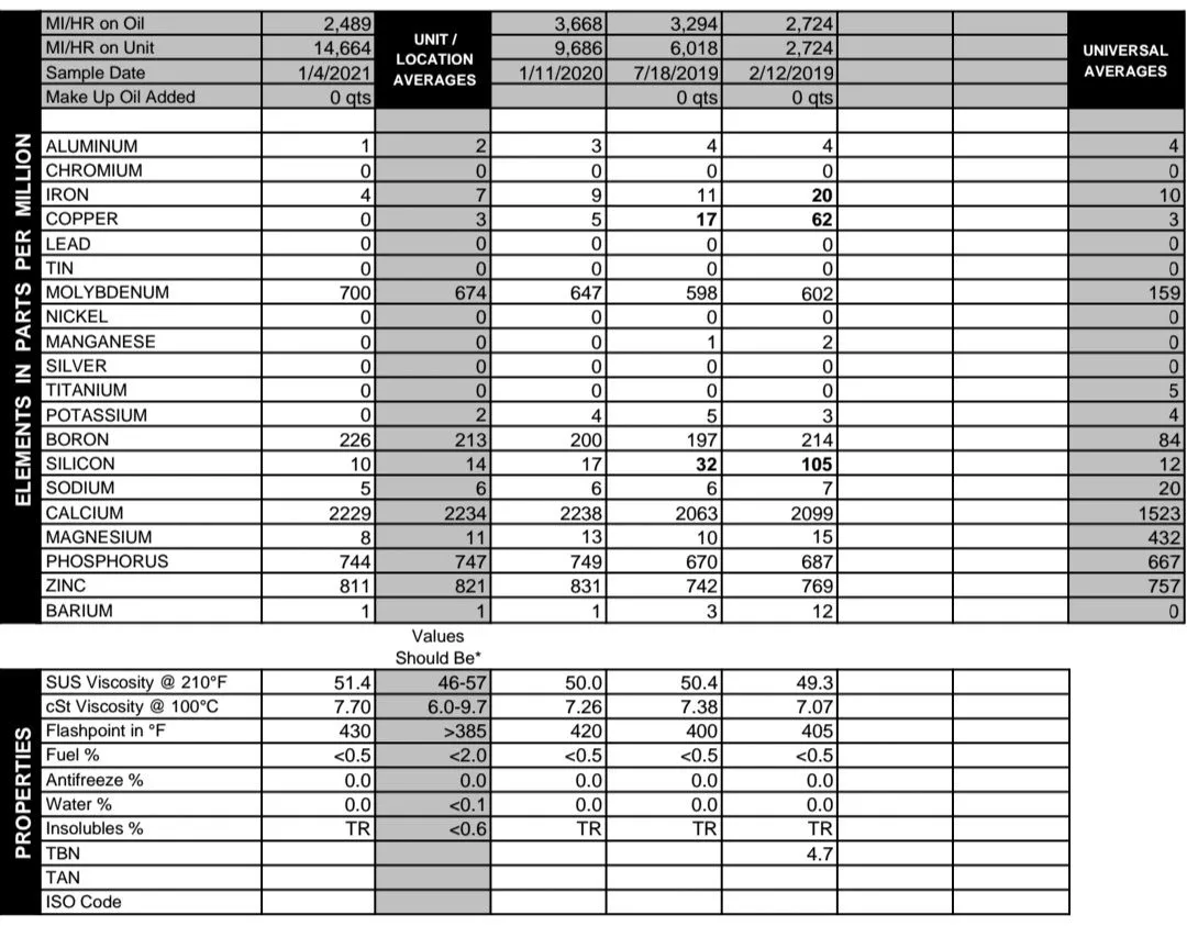

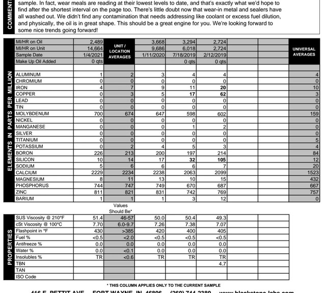

Latest analysis from my 2.5 Non turbo CX5. Not much driving past 6 mo. Mazda Moly 0w20 as usual and oem oil filter.

Not much in the comments section. Its pretty standard. The oil can go lot more.

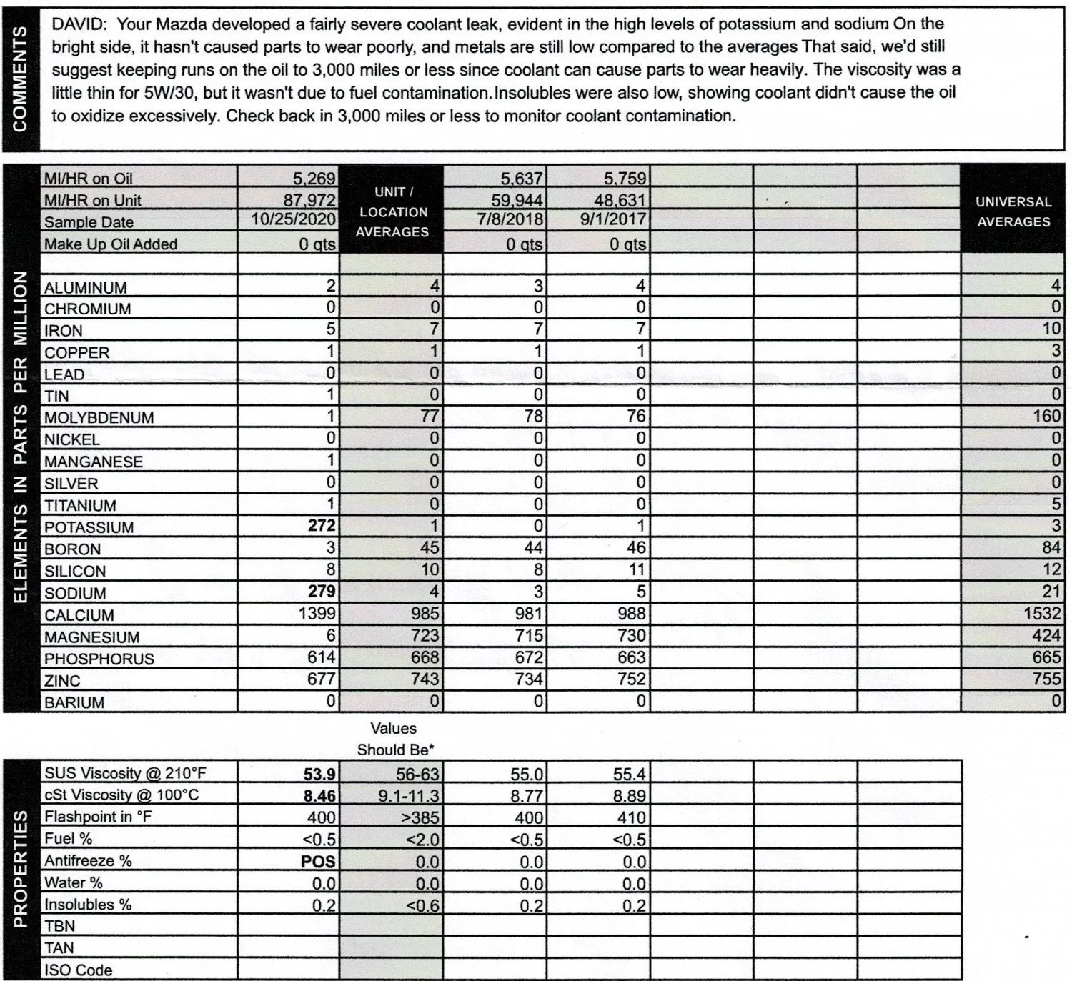

I think Blackstone might be in error. I see that no metals are wearing, your aluminum copper and iron are wearing well. If you had antifreeze in the oil I don't think the metal wear would be so good. Have your car tested for peace of mind.

I wonder whats the oil.Visco is low for only 5k miles.
It seems different oil vs previous UOAs.
Re: coolant - If it was me, I would probably drive a bit then suck some of the new oil with syringe or small pump from the dipstick and send it for 2nd uoa by Polaris to compare.

I did "clean catch" the oil as it left the car. The oil is LiquiMoly SpecialTec AA 5w30. Sharp eye, cz5gt - the oil is different, I was using Mobil1 5w30 previously. I think coolant would account for the thin viscosity, but my current sample (waiting for results) will make that more clear (2600 miles; half the previous interval). I'm also planning to ask them about the "near-zero" results for Molybdenum, Boron, and Magnesium.

you can check amsoil UOA order page, they use polaris labs but rebrand offer through amsoil. Last time I checked it was a bit cheaper from amsoil.
Polaris also offer something called coolant test but you have to check with them if it may help as a test in your case. Never done coolant tests so not sure what it measures.

It’s very strange indeed that the content of molybdenum is almost non-existent from LiquiMoly SpecialTec AA 5w30. It’s 600 ~ 700 from Mazda moly 0W-20 oil.
Its bizarre. Either the oil isn’t made as advertised, or (fingers crossed) a sample was accidentally swapped at Blackstone. This may be a result from somebody else’s sample.
2013 Mazda CX-5 Sport FWD Auto
LiquidMoly is their brand name only. There is nothing on the labeling that says it is a high moly oil
The UoA says 1 for Moly. LiquidMoly per the manufacturer claims it contains MoS2, hence the name. A reading of 1 is practically non existent.

I think not all type of that oil have Moly.
My opinion, for the price of that oil vs Mazda oem, I would stick with Mazda oem.
