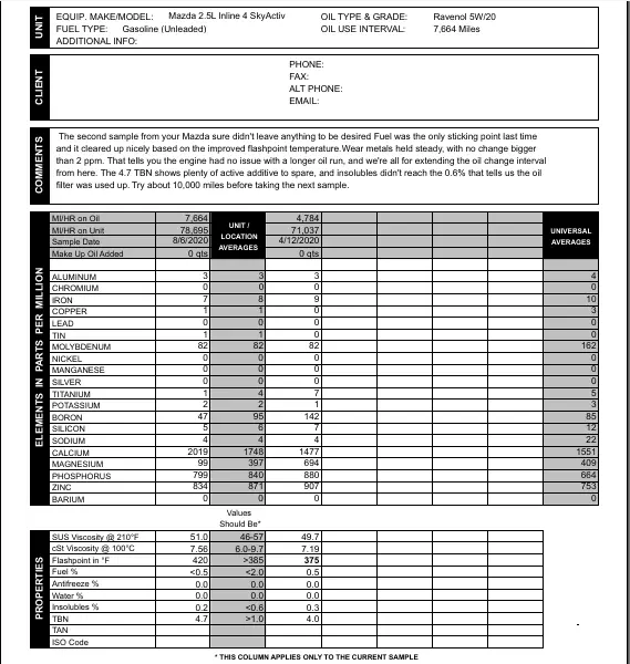

They stated that: "The only thing that stands out is a bit of fuel dilution." Why would they recommend pushing the oil further when it has fuel in the oil?
They state in their FAQ that fuel dilution can show if the engine isn't fully up to operating temp when the sample is taken.
As promised, just received the oil report from Blackstone this afternoon.
Came out great for 7664 mi, I usually don't go much more than this on my vehicles.
A little interesting in the way the comments were written, this time I ran the car for 45 min then left it sit for half hour or so to cool then changed oil, probably why fuel dilution disappeared this time.
Oil used was Ravenol 5w20 SFE.
Yes, running the car for a good long time (on the road, not idling) certainly will reduce fuel dilution readings. You're probably below maybe 2.5% this time, and TBN remains high.

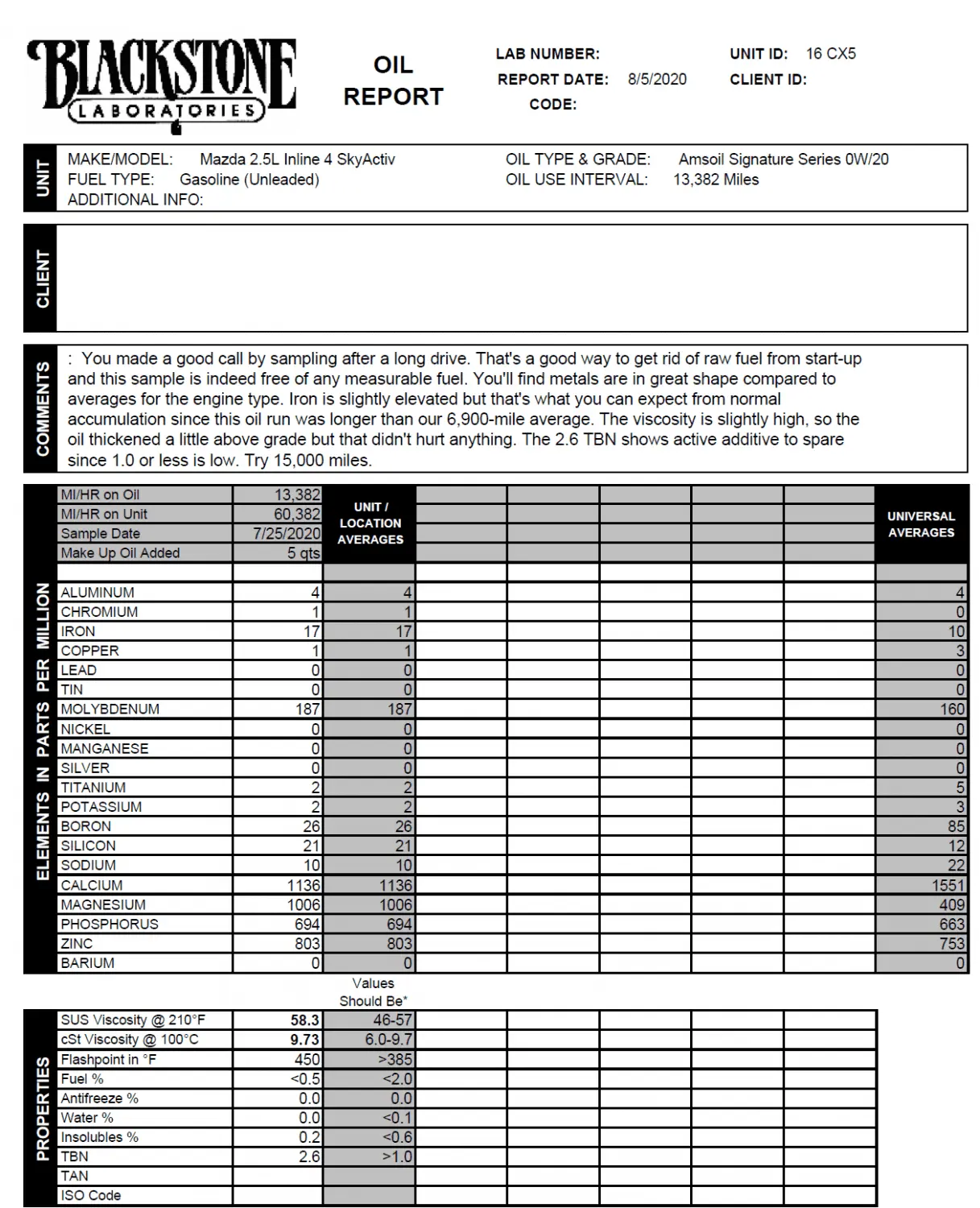

Hey Guys,
Here is my oil analysis from my 16.5 CX-5 with 63k miles currently. I also posted this on BITOG
I'm hoping to run the Mobil M1-108A till it's approximately 18-19k miles before doing another analysis to see how the AMSOIL Signature 0W-20 is performing. Also, to clarify, I did not add any make up oil, I simply misread the question as "How much oil did you add into the engine after the change?"

Has anybody done a UOA using amsoil 0w-20? I use amsoil in my wife's wrangler and my Shelby gt500. I just bought a 2017 cx5 and debating what to put in after break in miles are completed.
Hi, I know you posted this about 3 years prior but I actually went through and found your comment regarding AMSOIL 0W-20 and I just posted my analysis of the Signature Series 0W-20. Not sure if you're using it already, but take a look if it helps.

Try with a Mazda Oem filter for comparison next time. I think the metal parts should be a bit lower. Its interesting that the visco went up. 13k miles is a lot :) I would shorten the period to 10k if it was me.

I'll probably do that after the M1-108A since I'm curious to see if this engine can even go that far. The filter is rated for 20k/1 year but the oil itself is up to 25k/1 year. Anything that makes it so that I have to do less oil changes is fine by me with the least amount of compromise.
I seriously doubt 20,000+ miles can be done without seing the metal elements count going up and tbn going low enough.
I guess the viscosity is going up by design then if they claim 25.000 miles. To compensate but that doesn't mean that wear and some sludge isnt happening inside the engine.
If it was me, I would stick with 10-12k miles and oem filter on that oil and that engine.
btw, I am guessing also that you drive in cooler climate/area.

So did you run 13,382 miles within 12 months for this UOA? Should mileage and time used be whichever comes first on OCI and oil / oil filter ratings?
I understand people changing oil much less frequently in Europe and 13,382 miles OCI is a norm for their oil change. But here in the US most people may not want to do this, not to mention 15,000 miles suggested by Blackstone Lab or your next plan to 18,000 ~ 19,000 miles. We drive our CX-5 a lot less, so 12 months has become our normal OCI, which is about 5,000 ~ 6,500 miles.

I'll probably do another oil analysis with Polaris next time since they are more thorough in their analysis and they also include oxidation. It's probably not worth it to use AMSOIL SS 0W-20 if I'm just going to be doing 10-12k OCI's because it's very expensive. If I were to be doing 10-12k OCIs, I would rather just stick with Mobil 1 and get them cheap. I'm from the east coast so it's fall/winter/spring/summer over here.

I did my last oil change October 2019 and this test was done during July 2020 so it's barely a year yet but yes, it's well within the recommended OCI interval and below the recommended time/mileage interval. Personally, I don't know how accurate the manufacturers recommendation of the time/mileage interval is because I think it depends on various factors and the only way to find out is through an oil analysis. I used BlackStone because it was one of the most heavily recommended but as for my second oil change, I think I'll be using a better alternative like Polaris. The reason why I did 13.3k and not 15k is because I never ran an extended OCI before and I don't know what kind of stuff is going on inside the engine so I decided to err on the side of caution and have some leeway. I'm from the east coast and we have 4 seasons over here (Fall/Winter/Spring/Summer).
I've always just wanted to do extended OCIs for fun and also because I would have to get under the car a lot less and deal with the mess of oil changes. It's fun at first but it gets old quick, especially if it's snowing outside or I just want to do other things and not worry about when my next oil change is coming up soon. I know there's alternatives to make oil changes a bit easier (e.g. Fumoto, Stahlbus, EZ Valves) but then again, I would still need to drop the filter and replace it and IMO it kind of negates the reason to have a valve in the first place unless the filter is located inside the engine compartment like some vehicles.
