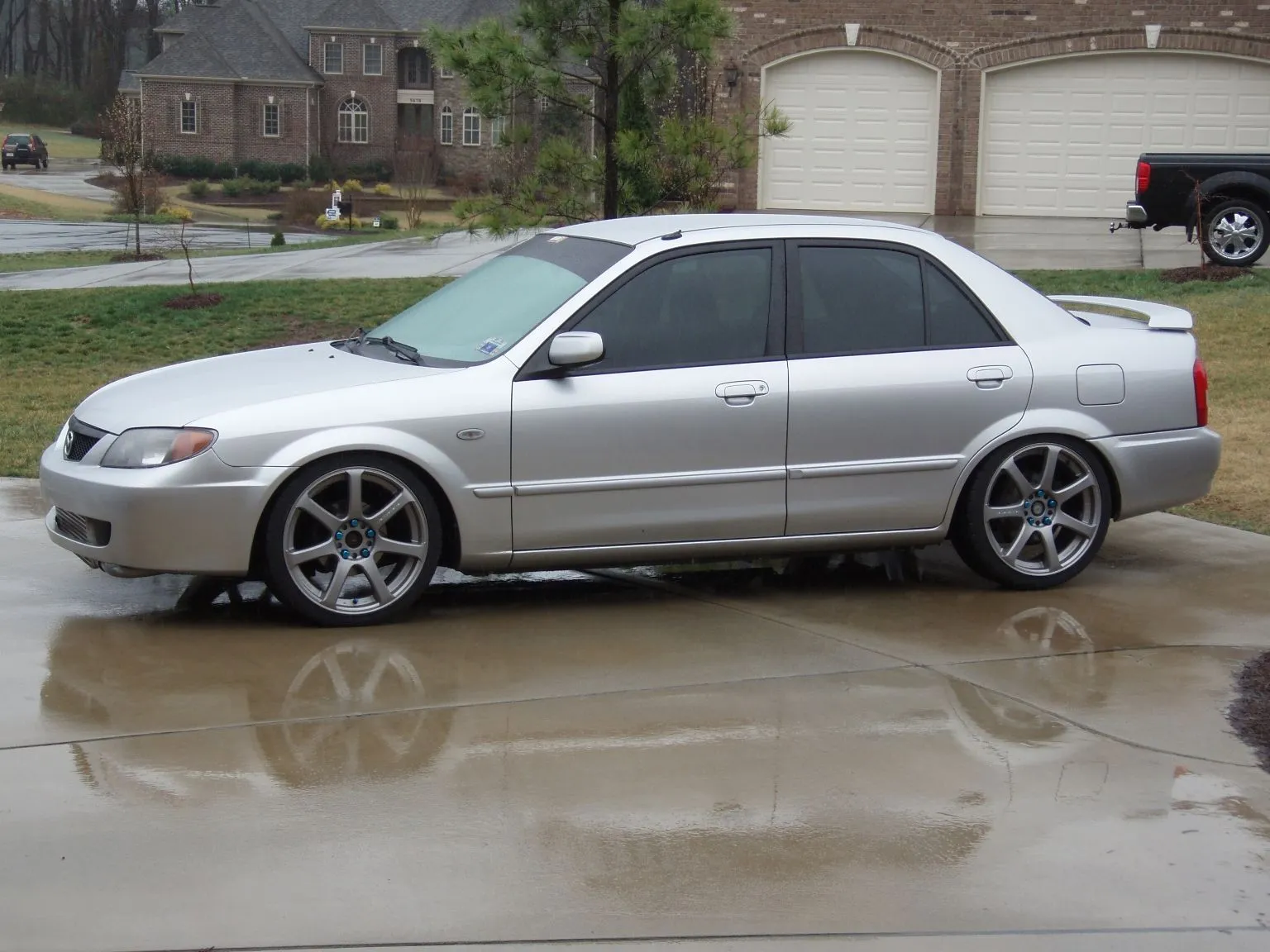

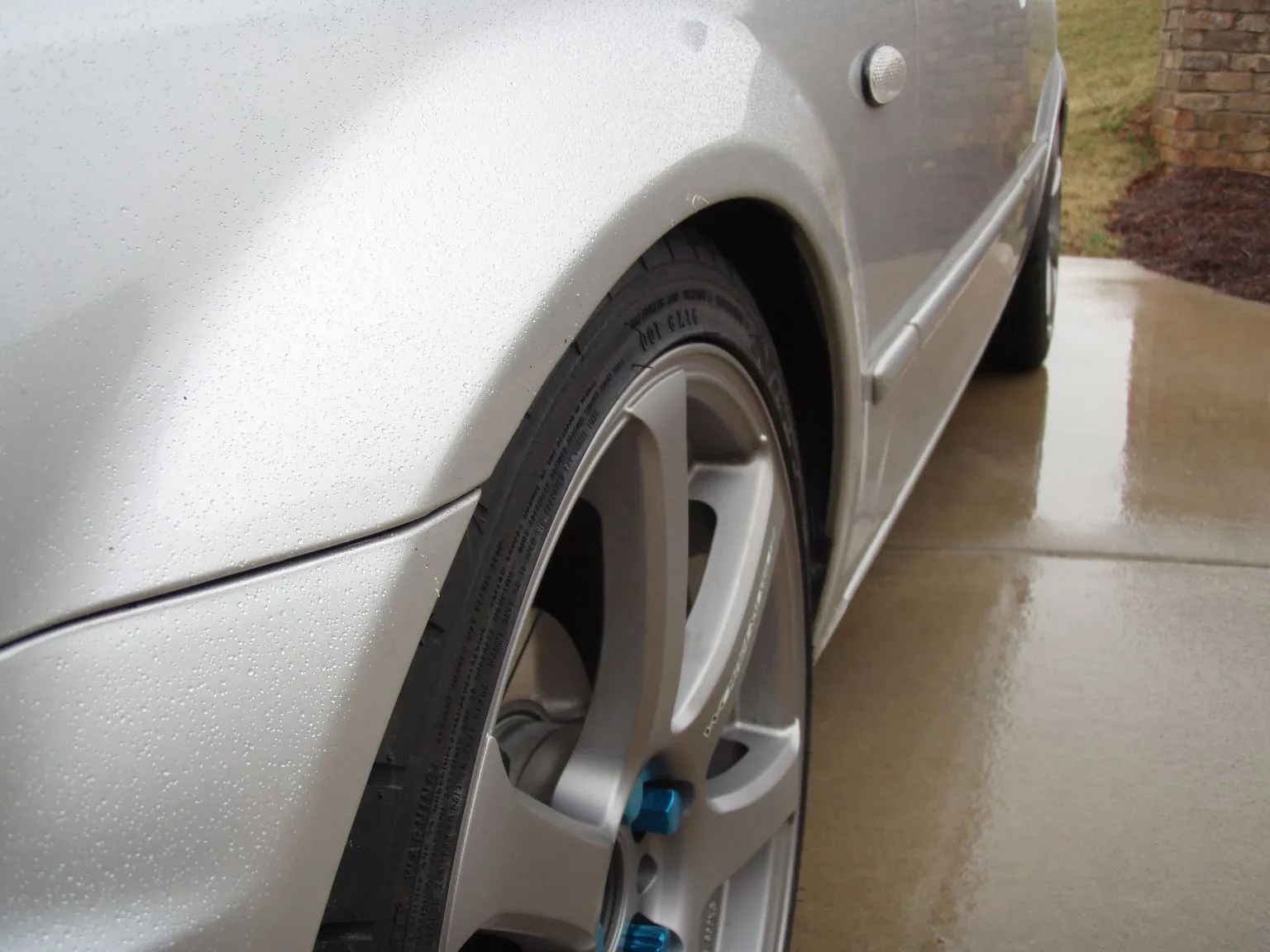

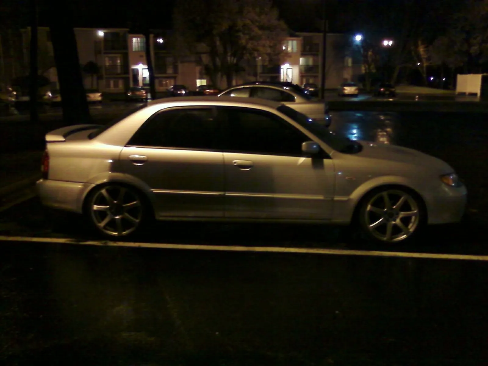

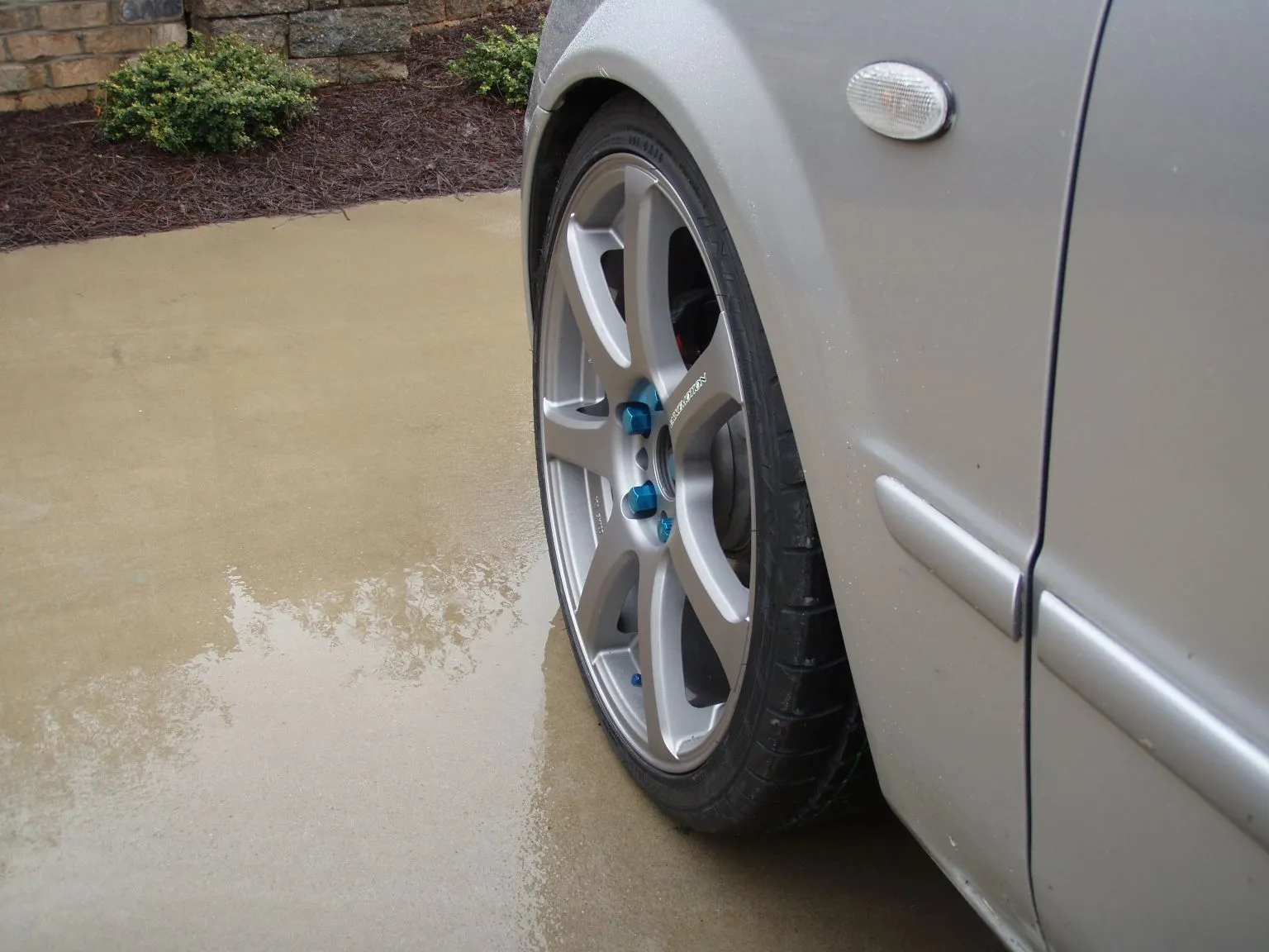

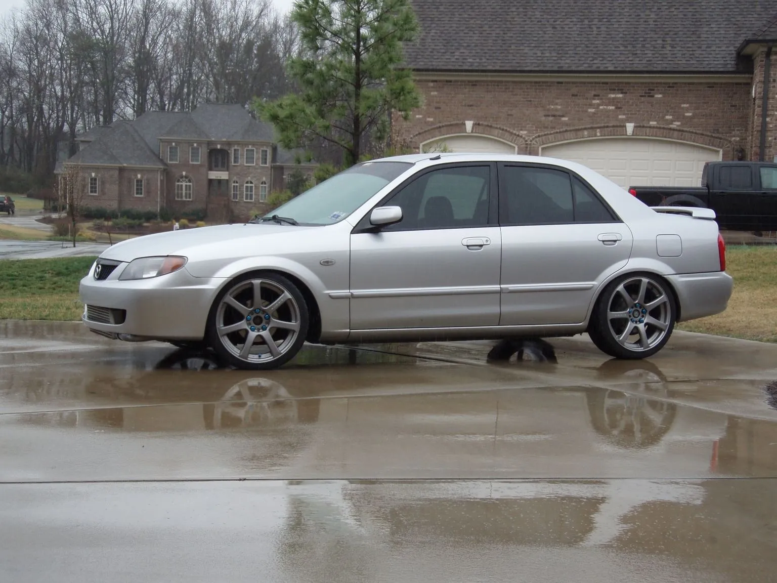

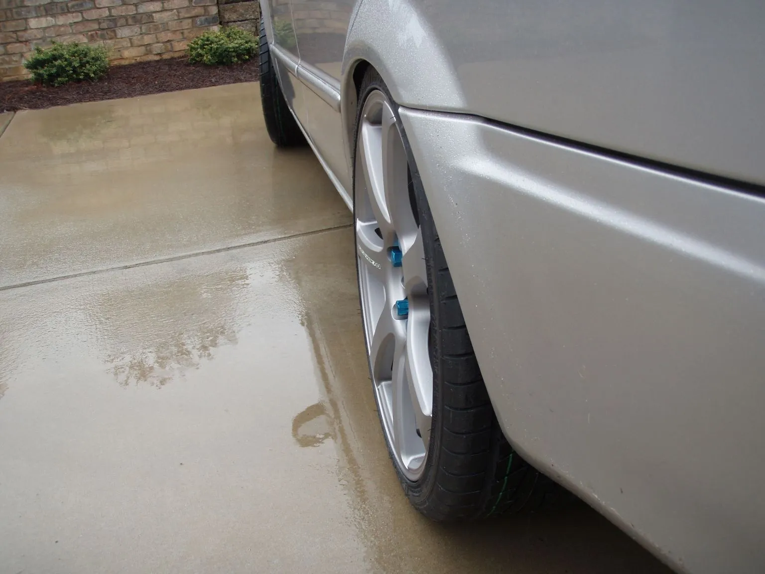

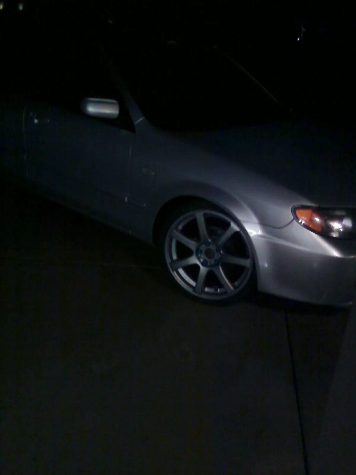

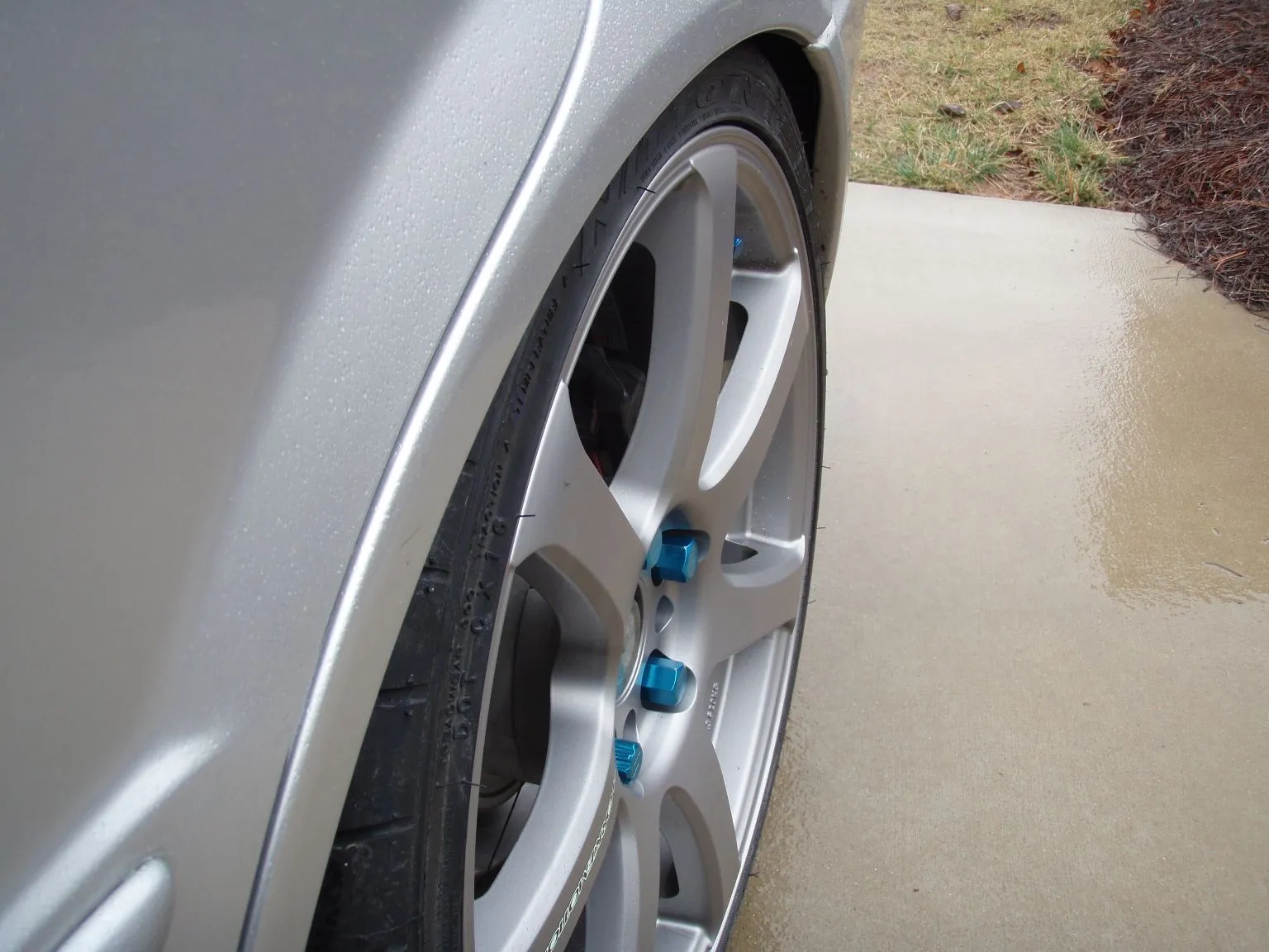

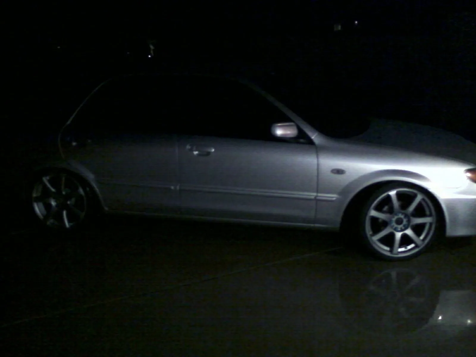

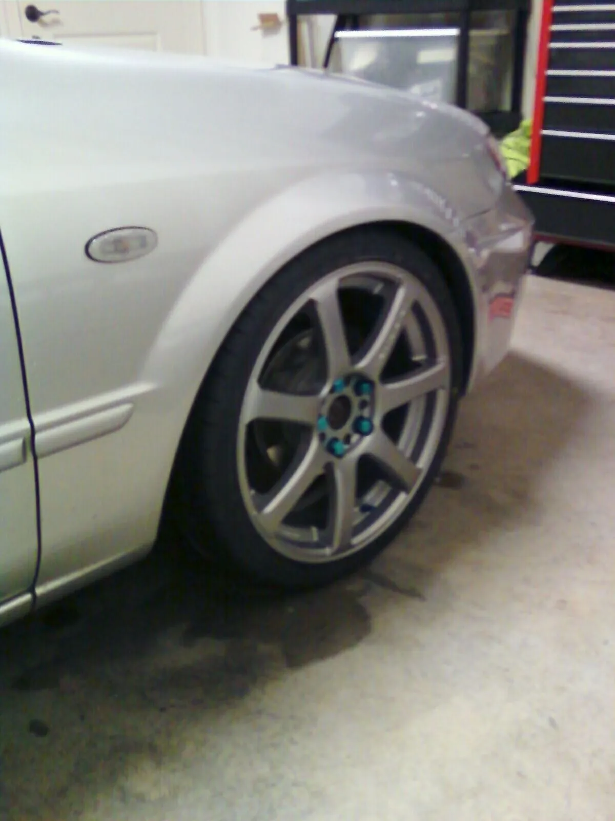

aight so i finally got around to installing my wheels. Work Emotion XT-7 18x7.5 +48 with Nitto NT555 extreme 225/35R18.
I had doubts about putting the 225's on there if they would rub or not but i said might as well try. and they JUST fit. took it for a few mile drive and i didn't experiance any rub.
on all 4 wheels i can just barely squeeze half my finger tip between the tire and my BC racing coilovers spring perch going from both the top of the wheel and the bottom of the wheel.
Fenders: on the fronts, it looks like i could have gotten away with a +45 or even a +42 to make it look a little better and give room between the coilovers. but that might would have rubbed slightly with the wheel turned.
on the rears, the fenders are extremely close, again i can get only half my fingertip between them. but it looks like they JUST clear them. so I'd say the combo i have on the rear is the max you can go without roilling the fenders.
once these tires are shot i'll have to see what other tires fit as well.
heres some bad cell phone pics. i'll get some tomorrow with my camera
