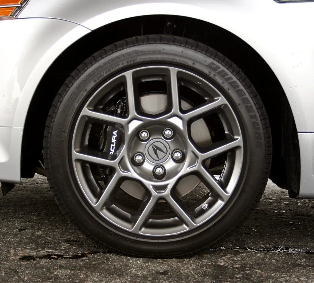

Anyway wheels are 17x8 with a +45 offset and I am at stock height. Also what size tire would be best...if they will fit.
Yeah, they won't. I tried it already. You'd need about a 38mm offset depending on your shocks, you'll need to trim out the fenders, and you can at best do a 225 in the back and a 235 in the front and it all has to be "perfect" and run relatively agressive negative camber to get them to tuck in. So no go.
Well I am at stock height but would more than likely drop it eventually to get rid of the 4x4 stance.
I know quite a few other members are rolling on 16x8 FD's and 18x8 RX-8 wheels but don't think I have seen anyone on 17x8's. A 215/45/17 has been suggested for tire size and would fender rolling help?
You'd need an extra 1/2"+/- of fender on a P5 for this offset!
Damn, damn and damn.....thanks guys for the help. I knew they wouldn't fit but just had to satisfy that little voice inside of me. lol
It does suck though because these would have looked very nice on my A3E.

Recipe calls for 215/40/17 with a +45 or higher offset....how about 215/45 with a +55 offset????
