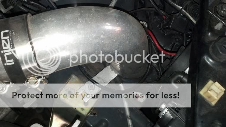

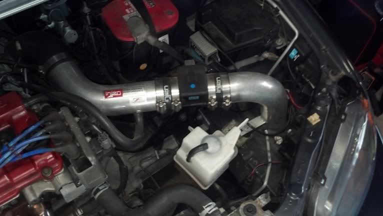

Instead of running a breather tube from his intake to the Valve Cover, he put a filter on the VC and put a nipple over the intake breather hole
Nope at one point I switched from the p5 to a cobalt SS my dad kept the p5 and when he added the intake he did it that way lol..
Got an injen intake for it. I'll be running it the regular with that one and not the filter ok the head
Waiting for it to get here
