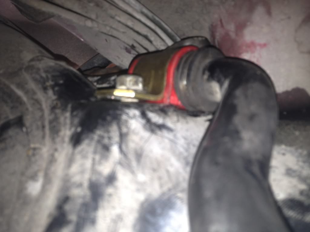

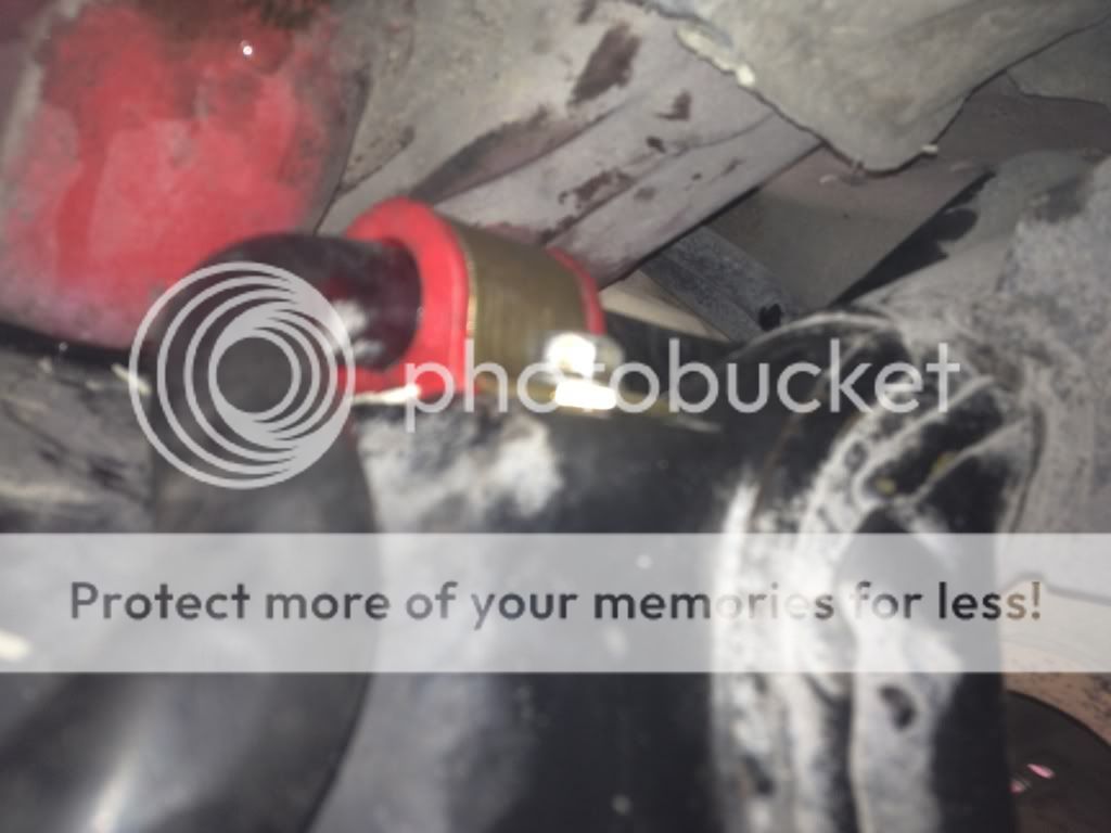

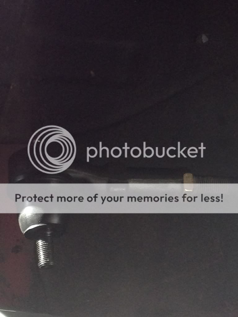

never posted these from the other week
had to change all control arms and tie rods and swap bar bushings
