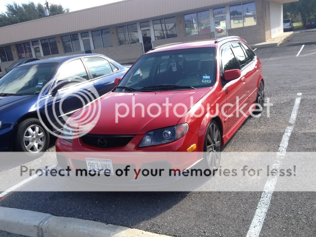

Last pic with msp lip and retrofits all sold. New look coming soon
