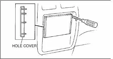

2. Remove the hole covers by inserting a small
tape-wrapped screwdriver into the slot and
carefully pry them off without scratching the
center panel. Pry up and pull off the hole covers
carefully to prevent the posts from breaking off.

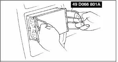

3. With the beveled parts of the SST facing inward,
insert them into the unit.
Note
Two sets of the SSTs are necessary to
remove the audio unit.
4. Pull the SST outward and forward to slide out the
unit.
5. Disconnect the connectors and antenna jack.

I need to remove a stock unit from a 2002 Protege5. Are the steps the same? also, I am a newbie and don't know what an SST is. What does that mean and where can I get one (actually four, i guess) thanks!
go to walmart, they have the removal tool pretty cheap. i think it was $4 or something, and yes the steps are the same. carefull when you pop the sides off tho, i have a couple of small dents in my vinyl now from prying with the screwdriver. i'd suggest maybe something to put between the screwdriver and your dash... like a nice thick, clean rag or anything to give it some padding.
For some reason the flanges that you push out with the tools were bent on my stock radio. To get mine out I had to remove the glovebox and a kick panel to attack them with a huge flathead screwdriver.
I guess I did it the hard way. I disconnected the A/C controls, and pulled the entire bezel out, with radio and A/C knobs still attached, then, from behind the bezel, I just squeezed the sides of the radio with my fingers, and pushed it out. No marks.
You'll probably have to remove it anyways to put in an aftermarket single-din kit.
Help... P5 radio will not come out!!!
Have 4 keys, passenger side keys go in maybe 1/2" and stop, and easy comes loose. Drivers side keys both upper and lower don't stop. Its like there are no tabs... Now what? $800 to best buy!?? NOT!! Help! Thanks
Update. If some jackass used a pick as a pry bar to get out your radio... Like my PO did, pull the cover from the lower steering column, and reach up and push the metal tabs and have a buddy pull on the radio... What a pain
I had the same problem. Geek Squad (at Best Buy) installed my new unit for $50 which was well worth it. I had all the necessary pieces (harness, kit, etc)
