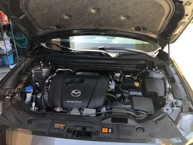

Due to the high ratings, I ordered up a set of Redline hood struts. They come well packaged with decent, but sometimes confusing instructions. It took me about 15 minutes to install. As I tried to mount the passenger strut, I noticed it was too long to engage the mounting ball on the hood. I foolishly tried to hand compress the strut to shorten it. The strut did not budge. I tried the other strut. It did not budge. I then realized I needed to ditch the prop rod, then lift the hood higher, to line up the strut and the mount. Bingo! It popped right on.

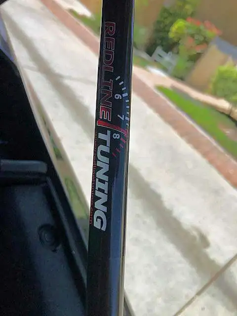

I then attempted to close the hood. It would not budge. The driver side strut even bowed a little with the pressure. It took several tries, before the strut rod finally moved up into the strut. The struts are shipped fully extended. I think this caused pressure at the end of the extension, that bound up the inside seals a bit. Once freed, the struts moved as designed.
The hood now lifts very easily. Closing now, is a bit more work. The hood now opens higher than the prop rod position. There is also significant up force to hold the hood open. My wife had a bit of difficulty reaching the hood and pulling it down to close it. Right now it is too easy to open, and harder than necessary to close.
I think the struts would have had better balanced performance with a bit less pressure. Maybe time will fix that.
Hopefully this will help anyone considering this mod.
