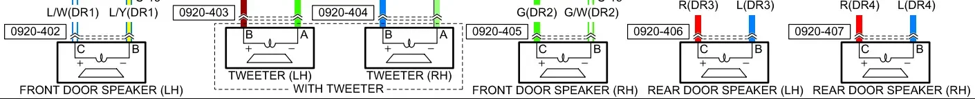

I think I missed it somewhere in this thread, but could someone recap which wires are positive and which are negative on all the speakers?
It would be most appreciated.

Not quite sure if your pos/neg question is about the factory speakers, but if so, see the attached for the wire colors to the pos and neg terminals.
Thanks, RedBaron.
You rock, bud!
That's exactly what I needed to see.
