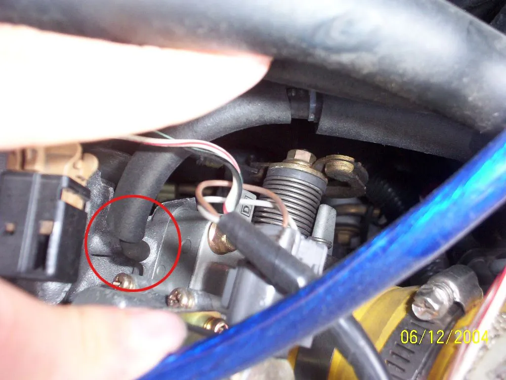

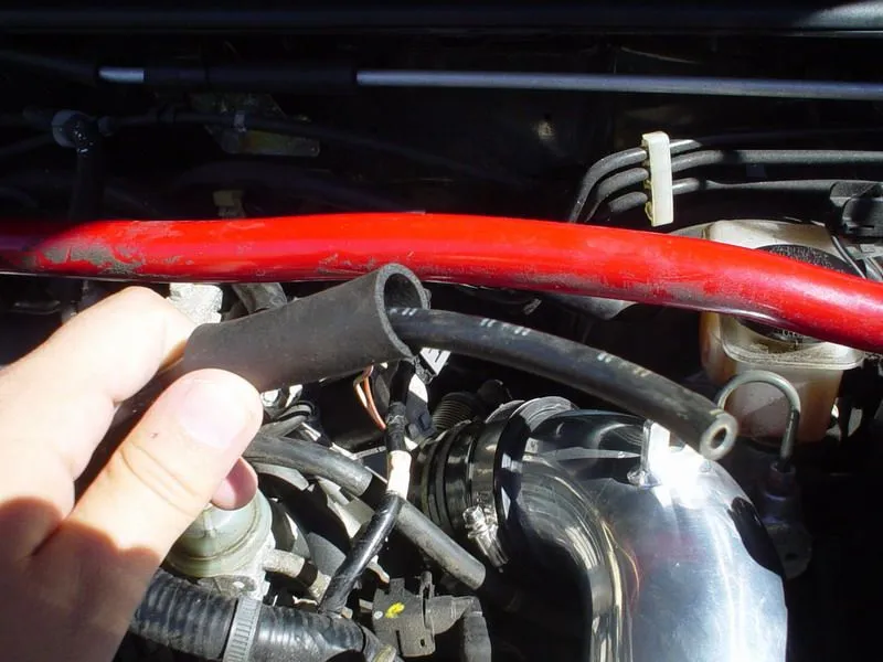

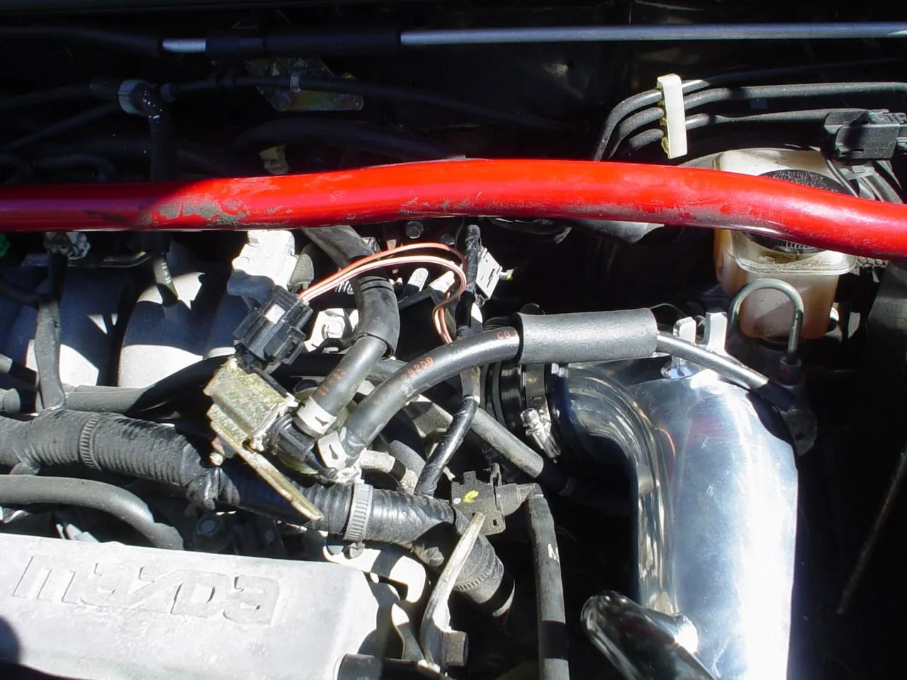

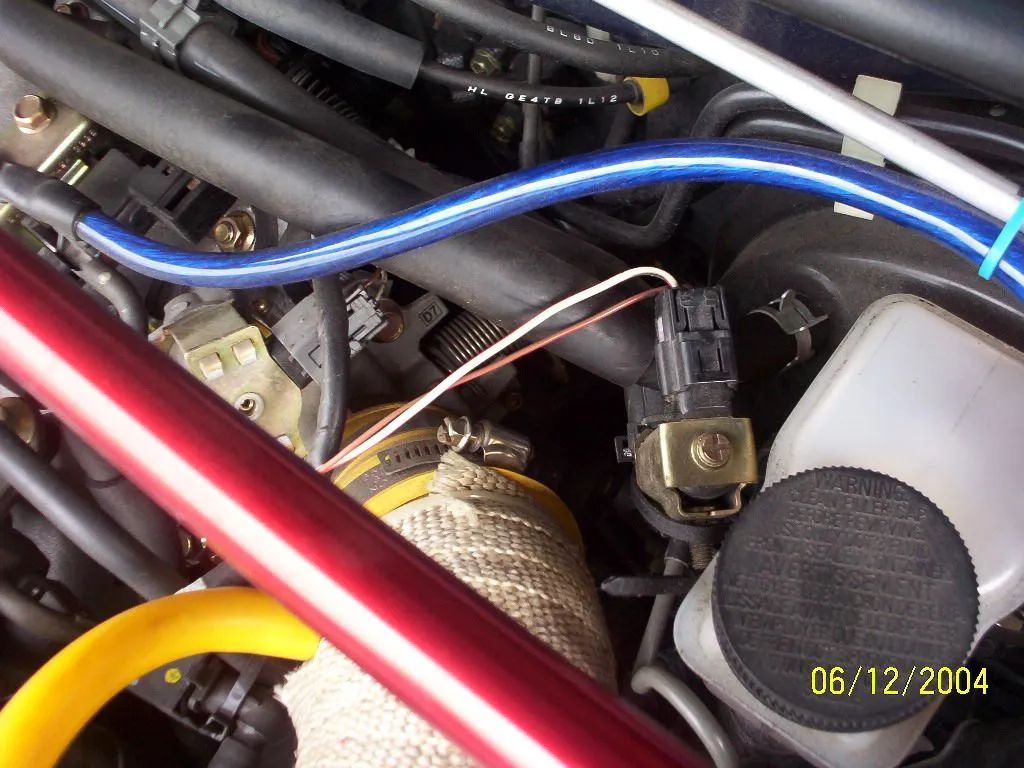

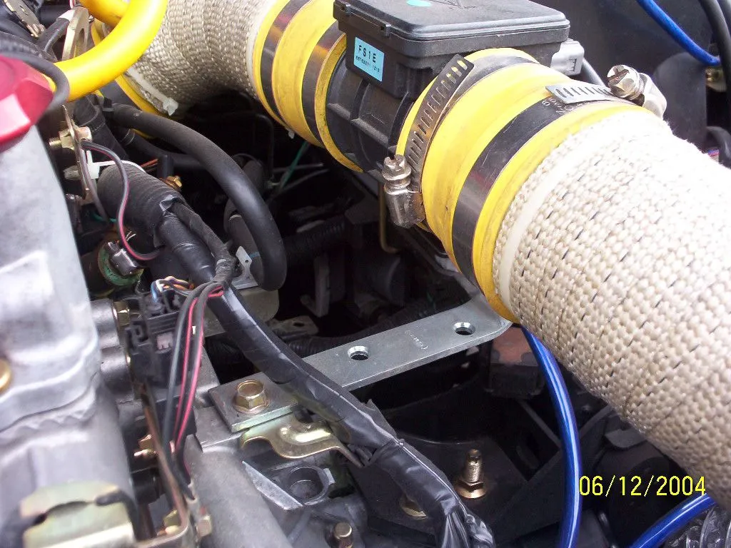

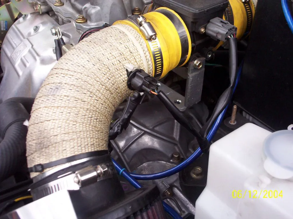

here;s a few pix..
pic4. home depot bracket to hold the intake
pic3. location where i strapped tied that thingy so it would go knocking around
pic2. the lose hose where it's suppose to go.. @ least i think it's that hose..
pic1. where i bolted the bracket to the engine..
hope this helps..

thx... i have nno printer where i am so i drew these... will let you know if they work.... i appreciate the pics.... alot very detailed!!!!

Thanks a ton for those pics. I was having a problem that just developed about a yr after having that intake. The hose that was "just hanging there" that connects to the throttle body, well I had that hose just sitting there not connected to anything. I kept throwing CELs once in a while, but I'd just reset the ECU and it'd come back. Well, lately it was idling bad and then it would "hiccup" like it was about to die and then revved up. I looked at the TB after coming accross those pics and heard a hissing sound and hooked that hose up to it and wallah! The car runs great again and no CEL! These pics need to be on the HOW TO section really bad. Anyone that gets a Ractive intake or the like needs to see these pics. Ractive can't make directions for crap!

this may sound like a dumb question, but why do u wrap the pipe with that stuff? is it so that it doesn scratch? ive seen it done on headers and i always wondered why? thanks.
those are heat wraps, so it doesnt heat up the tubes, and i also have 2 duct tubes connected to the filter for colder fresher air :)
ractive SRI alone is worst the the stock air box, but w/ what i did, it felt smoother..
as for SRI not fitting well, i bought mine 2nd hand, and it fit perfectly, but the person i bought it from, he had problem installing it, the first tube didnt fit @ all.. so i think it depends how your car is when it was built...
