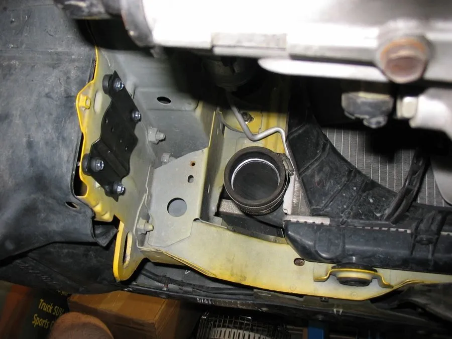

Here is a shot of the pump mounting bracket and the mounting location on the driver side under the car.
