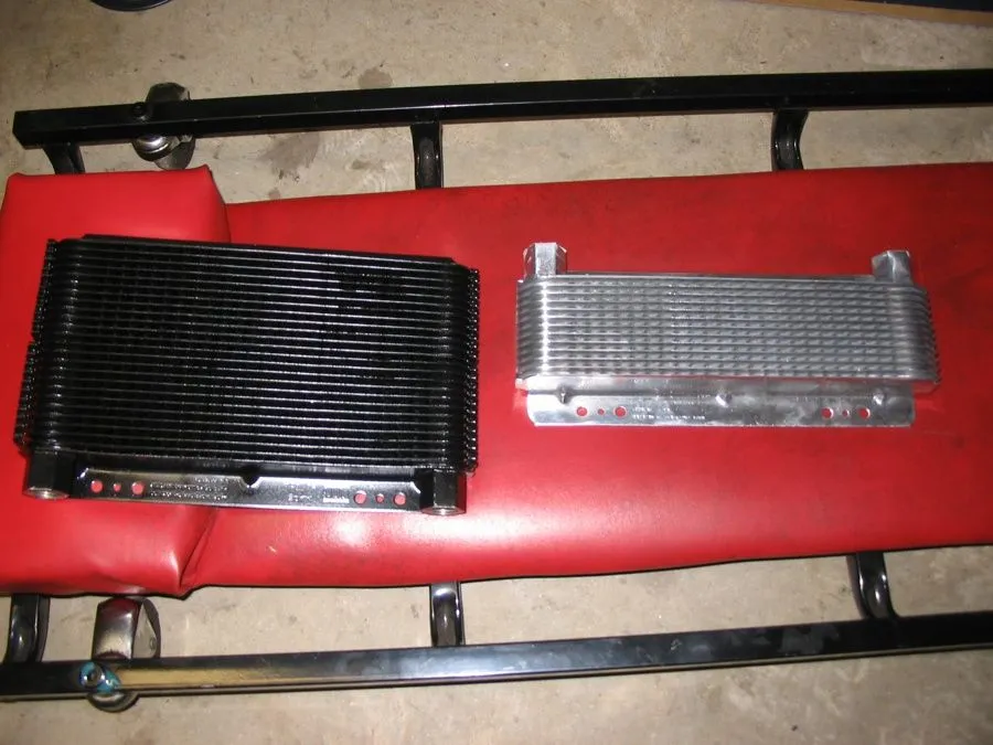

Been swamped as usual... but got the "standard" cooler in... was somewhat difficult on my car because my intercooler comes all the way up to the top of the bumper support.. and that causes this cooler to rest right on top of it.. which made mounting difficult... but here is a comparison of the two cooler sizes... I should get temp data tomorrow if not yet tonight.

daedalus said:
holy big oil cooler batman.
I think the question of whether or not the "standard" kit is worth it and if it will more than a little adequate should be answered right there ;) LOL. 24 passes on that cooler versus 12 on the little one.. the "deluxe" kit one has 36 passes... so it's taller... but same width/thickness.

Alrighty.. re-ran the tests tonight with the bigger cooler... the ambient was about 10 degrees cooler...
After warming the car up and beating on it, I reached a peak temp measured after the cooler of 120.6.
With the cooler on beating on the car appropriately, the temps continued to fall and at the end of the test they were at 106.
I then shut the cooler off and when to town on it again... and when turning the cooler back on reached a peak temp of 118.3.
Cooling the car down again I got the temps to about 100 degrees and still coasting down... so moral of the story is the bigger cooler whomps on the little cooler pretty well, and is more than effective.
keep in mind that because of where I can get a thermocouple in all the temps are measured AFTER the cooler, which is in large part why these temps all read a bit lower (the 10 degree ambient will help... but figure a 75% efficient cooler and that would in most cases only equate to about 5-7 degrees better cooling given even coolers being compared). So the cooler definitely is very effective.
Right up front where the other one was... I'll have to make a small bracket so you guys don't have to trim your front grill like I did... It'll be a little bit of a problem if your intercooler comes all the way up behind the bumper... mine ends up about 1/2" shy of even with the top of the bumper, and thus creates interference with the cooler and it had to be mounted high (I actually used the nut that holds the bracket for the AC condensor... that is what holds my cooler right now)... so yeah.. fits great and definitely does some serious heat dissipation!
