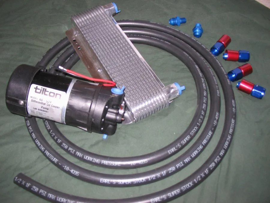

Here is a pic of the components in the prototype. The cooler and some of the fittings will likely change, but it's the general idea.
Thanks,
Steve

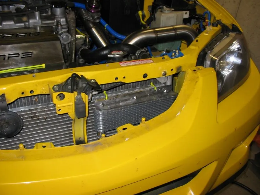

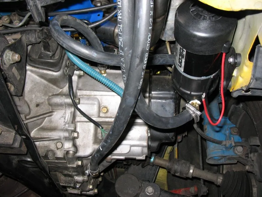

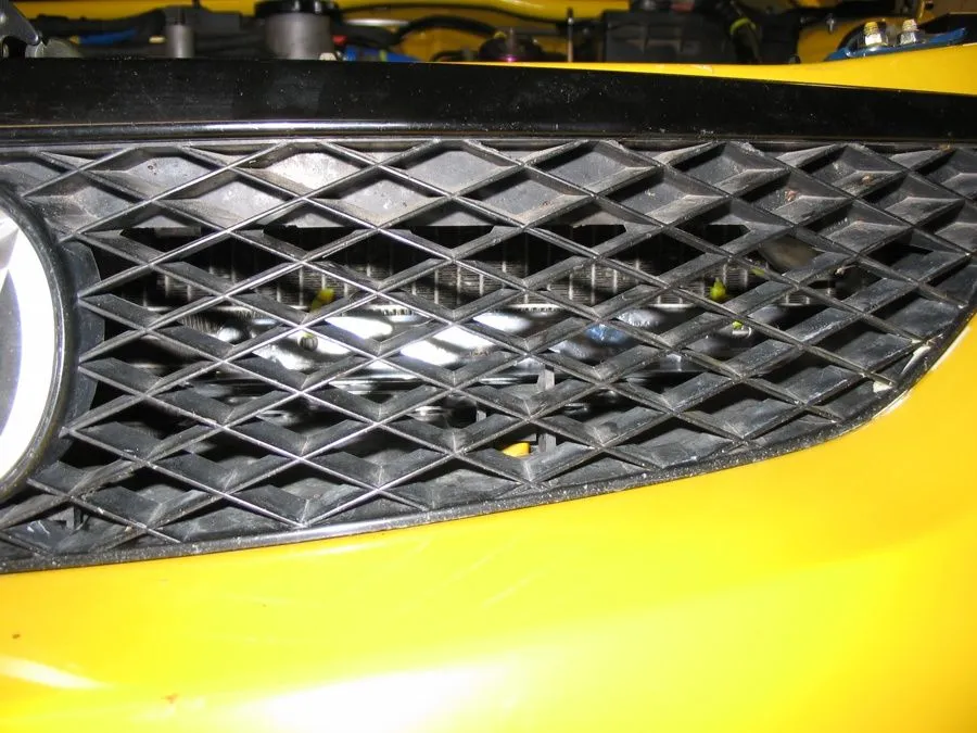

Here are pics of the prototype installation... a couple things to note... I haven't worked out brackets yet, but will have that ready for this when it's done. Also, we had tapped my transmission last time it was off the car... we have adapters though for going into the fill and drain plugs, so you won't have to tap or do anything to your trans to install this.
Nothing needs to be cut or modified at all to do this. The pump may need a shield for water reasons... overall it worked out very well. I'll be running tests this week on temperatures to get an idea as to whether or not this cooler used for the prototype is big enough or not. I'll also post data that I collect based on what the trans temps get to on their own in different situations as well as how much the cooler drops temps etc...
Thanks!
Steve
The blue tube you see in the first picture is the hose from the funnel for filling the trans up.. I was putting fluid in when I took the pictures... that's the color of redline lightweigh shockproof gear oil which is what I recommend for use in these transmissions.

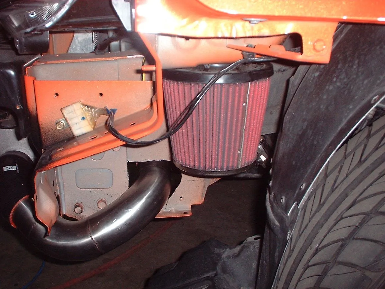

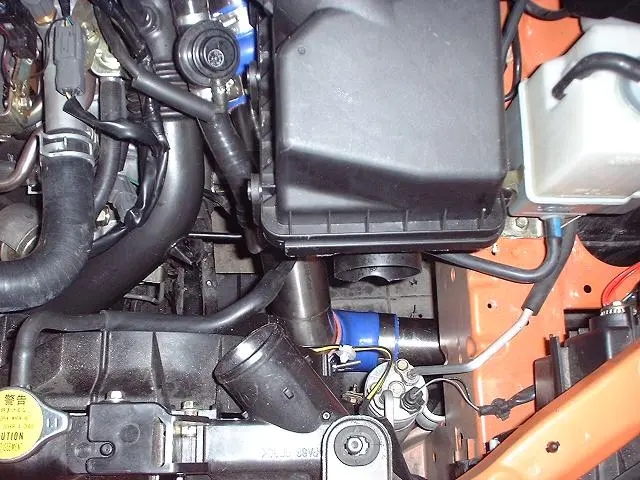

Looking good Steve! I wait for the final results. Also, can you comment on pump placement and possible intereference with the ION FMIC piping that comes through that driver side firewall?
I have searched and can't find pictures of that area right now.
Found the pictures...
that will require a different placement for ION owners... there should be enough space on the side of the frame rail or directly under it in the same. In the second picture you can seee roughly where I'mtalking, but it is half covered bywhat looks like the stock air box.
Are you going to send the splash sheild for the pump if you decide it needs that?
Yeah, I'll include it if it is needed. but I drove the car with the setup you saw in a good bit of rain yesterday and it didn't get wet at all as far as I could tell... so it looks like it may be ok other than if you drive through a huge ass puddle... but then if you simply don't run it (I have a switch on it...) then it should be fine too!
