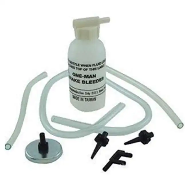

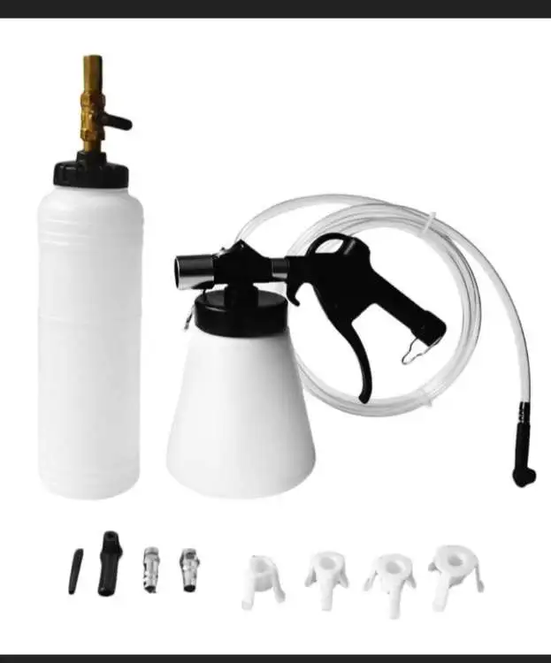

I'm almost positive that a brake bleed buddy won't work to bleed the clutch, unless you have a vacuum pump included with the kit.

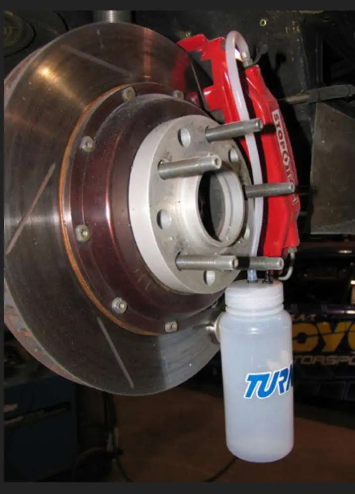

I'm pretty sure that if you just have a drain bottle like this,.. you are supposed to open the bleeder screw before you pump the pedal...
View attachment 310096 View attachment 310097
Try to find someone to help you bleed your clutch.
Offer them a beer or a Big Mac or something.
Their job is easy.
Pump the pedal 3 times, then push it and hold it in.
Then you loosen the bleeder screw and drain it into the bottle while checking for bubbles.
It should only take about 10 minutes.
Don't worry about the click for now.
It could just be bubbles popping or something.
