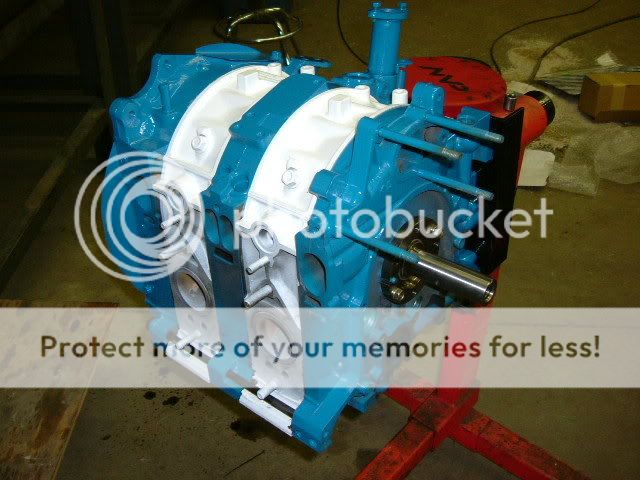

Heard from the engine builder today. Irons are done and are going to be cleaned up at the body shop (sand blasting) tomorrow, then painted. Side seals and counterweights should be there soon. Then there will be a day worth of assembly and some engine dyno work to break it in perhaps (may be easier than doing it on the track).

I actually just finished assembling the shortblock right now, just need to assemble the front stack and toss on the front cover and I'll be ready to head to the dyno with it.
Heres a teaser pic:
Matches the stickers. There must be at least 50 hp of stickers on the car!
