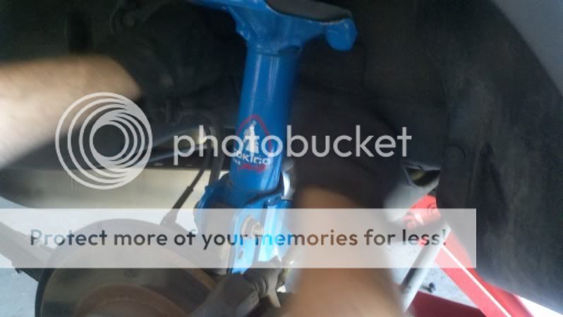

Tokico Blues and the Eibach Pro Kit springs installed. No complications, and we didn't even use a spring compressor. It rides sooooo nice! Body work done as well, just need the finishing coat. More picks to come...
cant wait to see the body work you did. you definatley deserve a pat on the back for that
