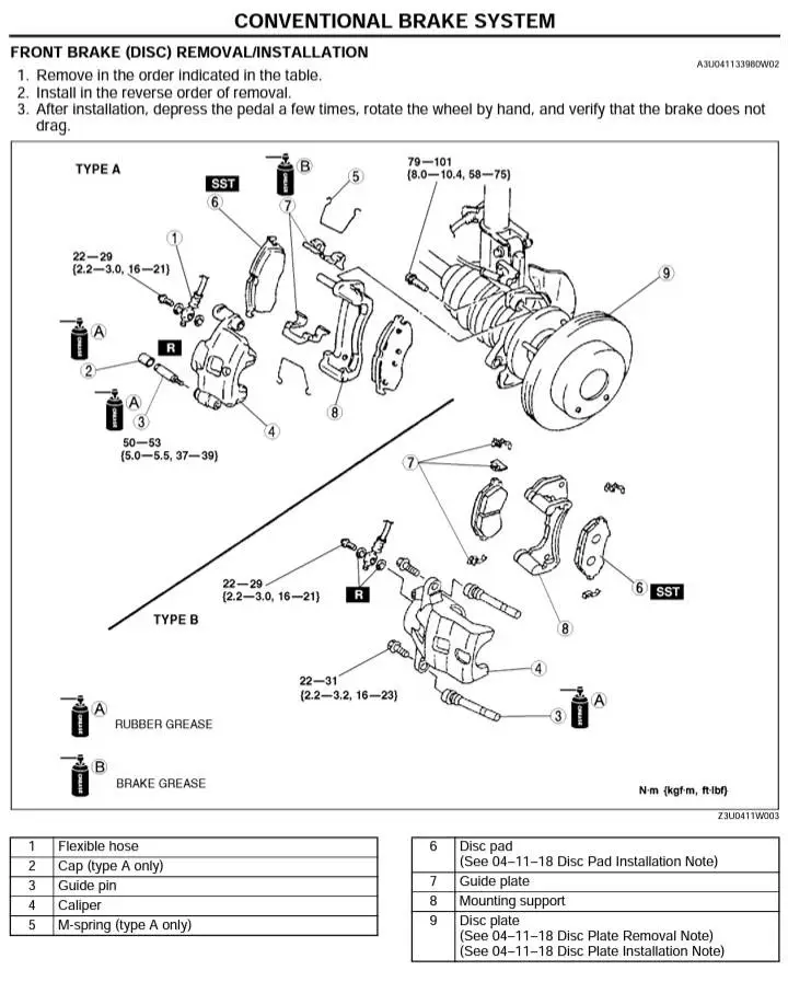

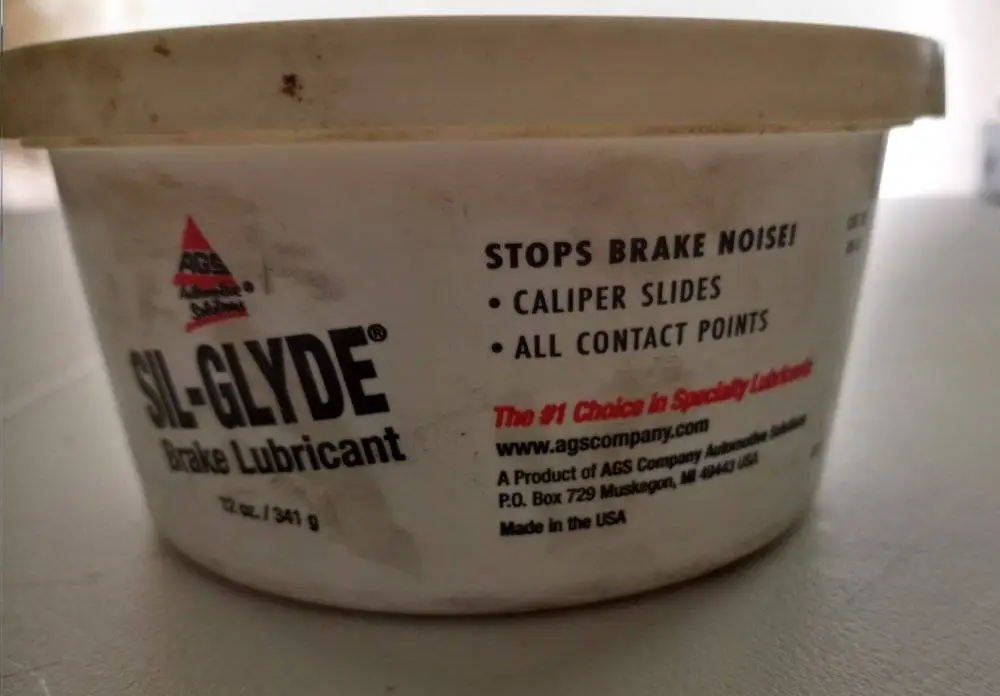

I'm guessing that your slider pins need to be greased.
I use SIL-GLYDE it's awesome stuff. (it's silicone grease)
You may have seized or binding caliper pistons, you could check under the dust boots to see if they look rusty.

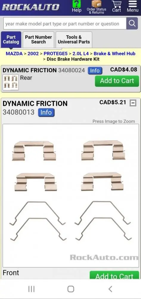

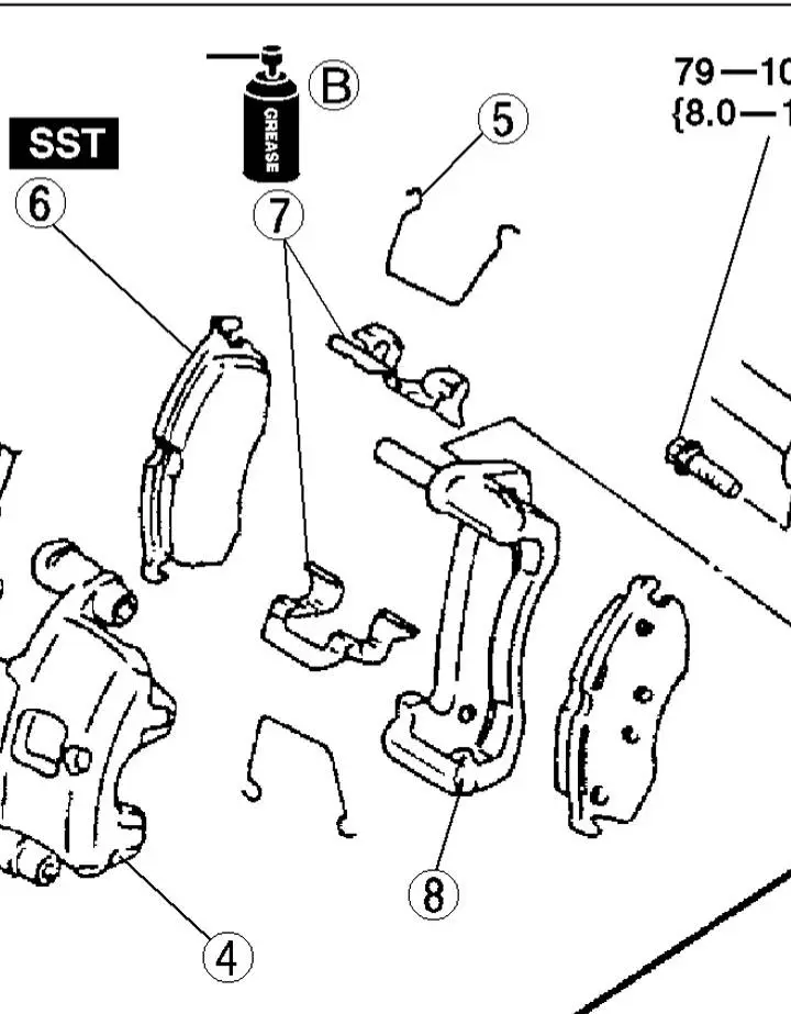

There is also brake pad springs that you may need to install if they aren't there.
The springs at the bottom of the picture help to back off the brake pads when you release the brakes, and the clips at the top of the picture, help the caliper slide with less friction and help prevent binding.
Make sure you grease all the spots that you're supposed to and make sure you use rubber grease. (like SIL-GLYDE)
You could even put a bit of rubber grease on the exposed part of the caliper pistons.
Our brakes are TYPE A.
