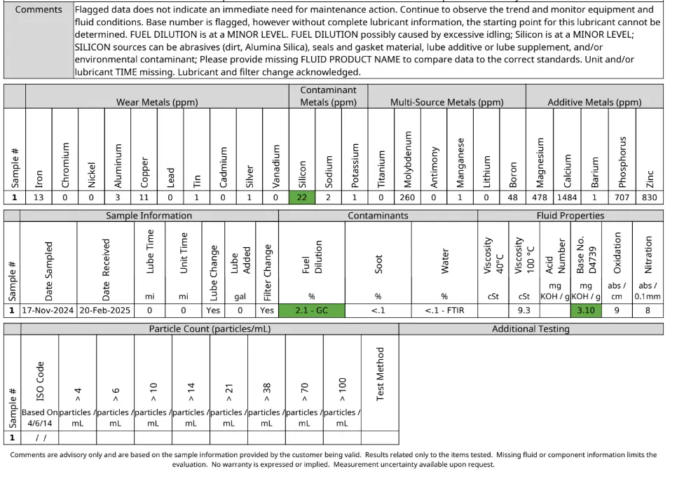

Here is my test results at 11,000 miles and 5,500 miles on synthetic oil.
Like others, over 2% fuel dilution in the sample. Interesting and to be watched the elevated silica in the sample. :unsure:
For a second oil change on new car the Sil is pretty normal. I wouldnt call it elevated.
Mine was higher on the 2nd uoa since new.
Fuel dil is something these engines are prone to. It even gets worse the older the car gets ".
Not much you can do beside drive and regular good oil changes.
Thankyou for confirming silica is normal. It must be from the casting process. I was curious if there was any copper or other metals from going WOT about 20 times during the tuning process. The tuner requires 2 WOT per log.
These cars are great for merging and passing combined with good FE. Not a hot rod, so not much of a thrill to go WOT. That is probably a good thing! 🤣
I'll test again at 20,000 miles.
Interesting results.
Remember, as they note in the reports, its the TRENDS over time that tell a more complete story rather than one test result.

But for right now, it tells me where my oil is at. The Viscosity drop to 20W doesn't seem to concern them, but it does me. I'll keep my OCIs at 5K.

It could be. The explanation I heard was assembly lube.

p.s when i had my timing chain cover and oil pan re-sealed by the dealer I got lots of Si after. I changed the oil shortly after as they did not.
I change oil at 500-800 on any new car and Sil is around 40-60. After 2-3 oil changes it drops to base levels 10-12.

If you want try the Amsoil Extended XL (next one after the OE ). Viscosity drop is because of the fuel unfortunately but that is not that much problem at 5k changes. The engine didnt mind..

Well that's a new one on me! Silica in the assembly lube....wow. I'm glad I had the oil sampled, it got me to get off my checkbook and buy a premium OEM air filter...

The Motor Oil Geek (Lake Speed Jr) describes the SILICON in early oil changes as due to the sealants used when the engine is built. Makes complete sense. His oil analysis shows it drops down quite fast over time and oil changes.
