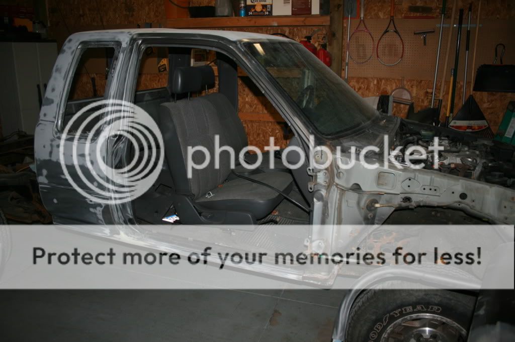

Cab sanded down, still waiting on the stupid glass guy to show up to take the windshield out

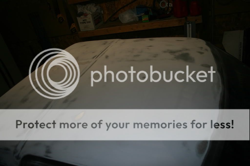

Roof of the cab stripped, ready for primer

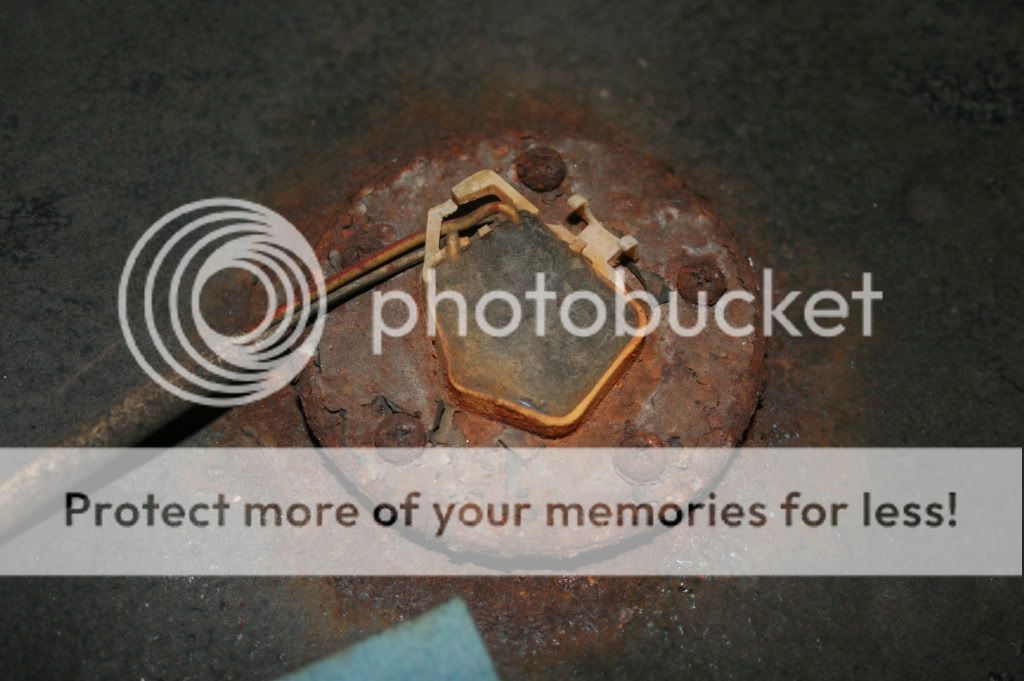

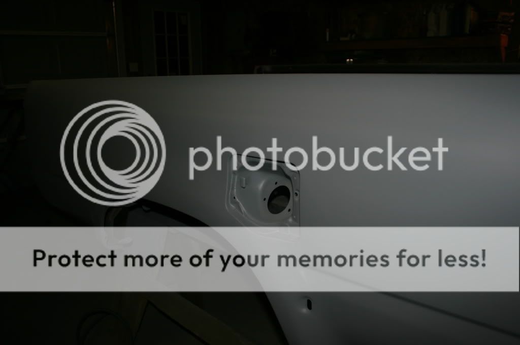

Awww yeah, looks brand new. These are the lids on the gas tank
It's the lower metal hardline that's leaking. I don't think we'll be able to get the screws out, and obviously the use of heat isn't really recommended. Might just have to get a whole new tank

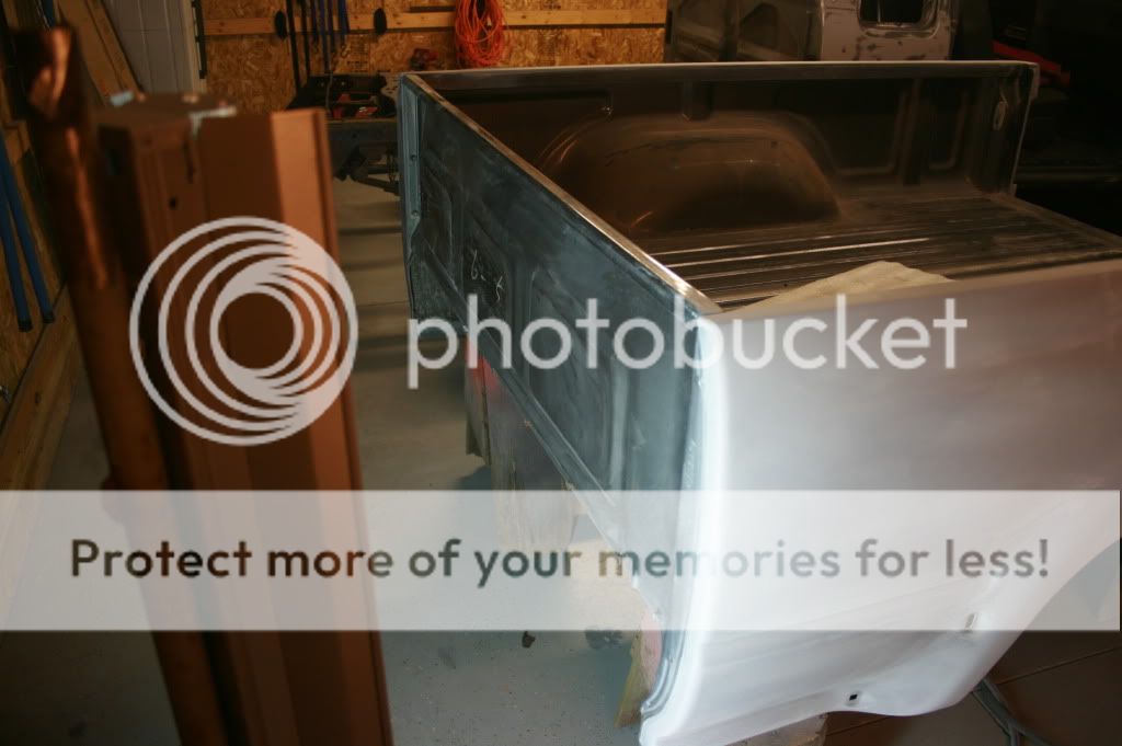

Bed shot in primer, getting ready to sand out the orange peel
s*** sucks, that's 113$ worth of supplies…

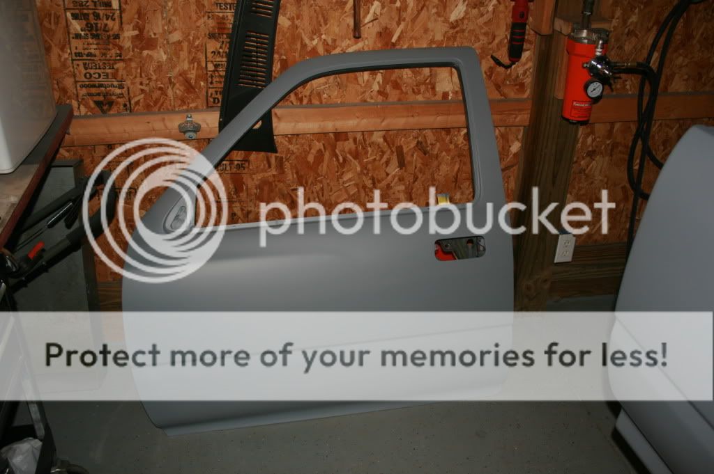

The paint looks awesome on the inside of the door where it was never exposed. I bet this truck looked awesome like 20 years ago…

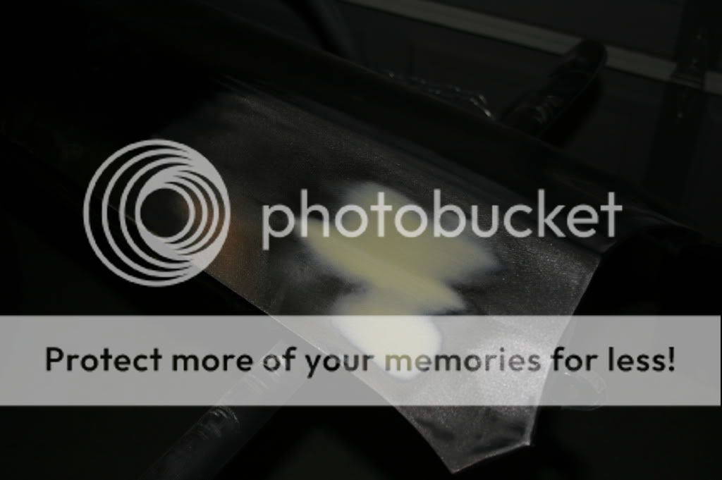

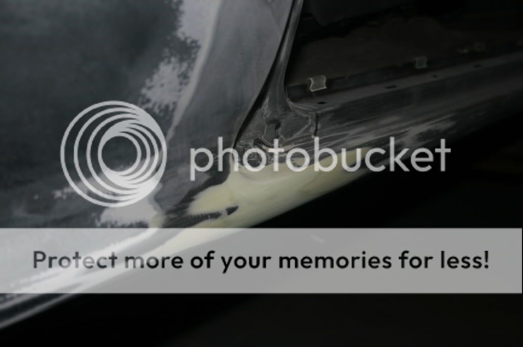

Part of the passenger side rocker Josh pulled out with the stud gun.

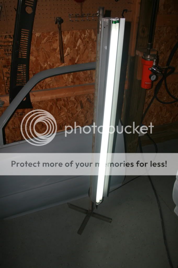

Sweet portable work light Josh made the other day, I think I'll definitely be copying the idea. It's perfect for a garage where the lighting isn't ideal, and should last a lot longer than those little work lights that seem to have about an hour of bulb life.
Hard to see the light it puts out, but maybe you can tell

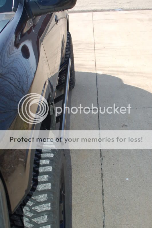

Here are some finished pics.
I had body damage to pound out, so afterwards I took a DA sander with 120grit and took the areas I was doing down to primer. My sliders/bumpers/plastic pieces I did with no prep. They took it well.
Nick took more/better pics of his than I did, plus shows better against his red than my black in photos.

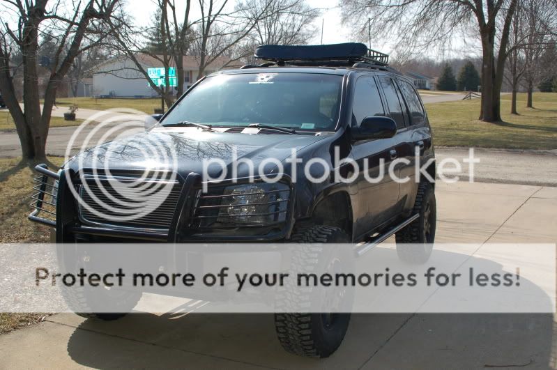

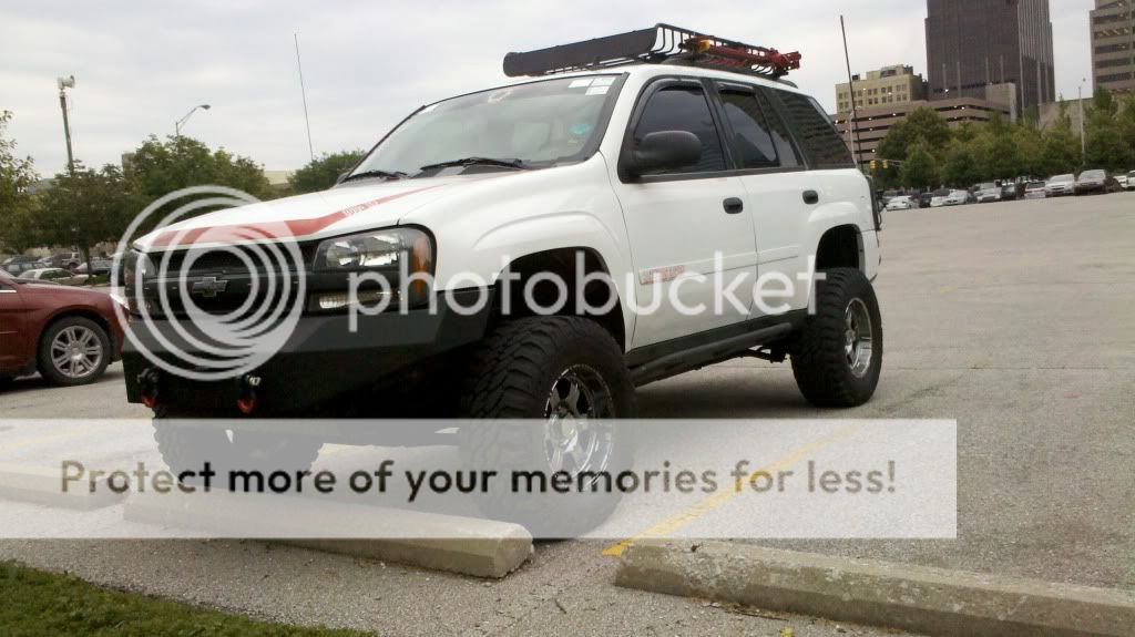

I usually don't like the EXT/XL versions, but this one is bad-freakin-ass!!

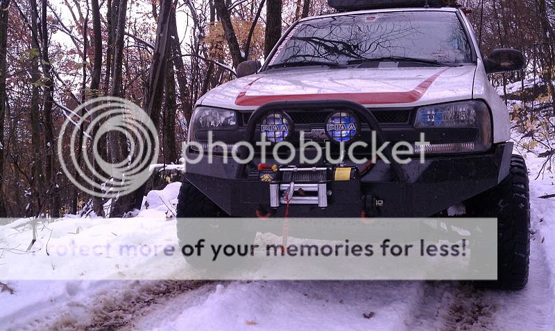

I wanna say this guy's spare tire holder is a hitch-mounted design. And, it flips down so he can open his hatch. Not sure if he custom made it, or if he found/bought it that way. I could try and get more info if you're interested...
Heck yeah, man. If you can get a bit more info about that hitch mounted tire carrier, I'd be more than happy to check it out for sure! Those baller ARB bumpers are crazy expensive. I was only looking at the ones for Land Cruisers on the rear (site didn't have my pickup as an application), but they were like 2600$ for the dual tire carrier and the ladder to the roof... Crazy. I've been trying to talk myself out of getting an M100 or M416 1/4 jeep trailer for off road exploration and camping... It's always something! :D
