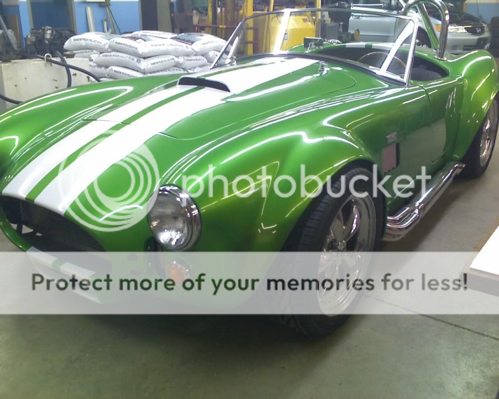

I forgot I took this pic at the guy's shop where I got the bushing machined. It's a Factory Five Racing Cobra kit car, with a Ford Racing crate motor. He said the motor alone was 10-11k, and is good for 452chp. He said to duplicate the car that he'd built there, it would take about 50k, because everything on it was new. It had 13" Vette brakes on the front, a giant rear sway bar, it was really all decked out. He started it up, and it was really a force to be reckoned with. I don't even like muscle, but it was very cool.

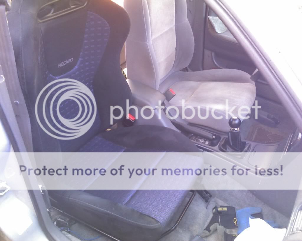

Ended up getting Evan's seats, huh?
And that's a nice Cobra replica! I always get irritated whenever I see one, because the VERY FIRST sentence out of everyone's mouths is always "Oh...I bet it's not a real Cobra." Like....so effing WHAT?! It's still a nicer/faster car than they'd probably ever own!
Just test fitting them, it's not final yet. I'm going to have to mod the brackets a bit to fit. The fronts bolt right in, but the rears are totally different. I'm mad I forgot my camera to take good pics.

A guy I work with built a FFR car. Got a ride in it one day at lunch. Fun cars for sure. Superior suspension designs compared to the originals too.
As far as I'm aware, the original donor platform for the FFR's is the Fox box Stang, so the original suspension on the Cobras much be straight up awful, lol.

Donor platform, yes. but, there's 3 different suspension options for the 4th gen FFR Roadster. There's a 4 link, a 3 link, and IRS rear options. The 3 link is what they use in the NASA spec series with a larger panhard bar. Fronts use coilovers. On street tires, the cars are good for 1.0 G's on a skid pad. So... still better than almost any Mustang will put down.

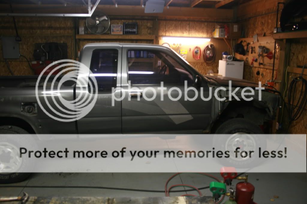

Dropped the Yota off at Josh's a few days ago.

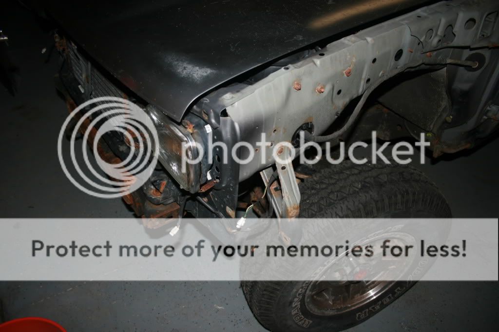

The frame in the front that looks like the lower rad support (I don't think it actually is) is really really far gone. It's the worst spot on the whole truck. I think I'm just going to get some new 2" square tubing and cut that old shiii out and weld some new in. Just gotta wait for my stupid .045 mig gun liner to come in, Airgas has really been taking their sweet time getting it to me... (unamused)
Josh's baller garage

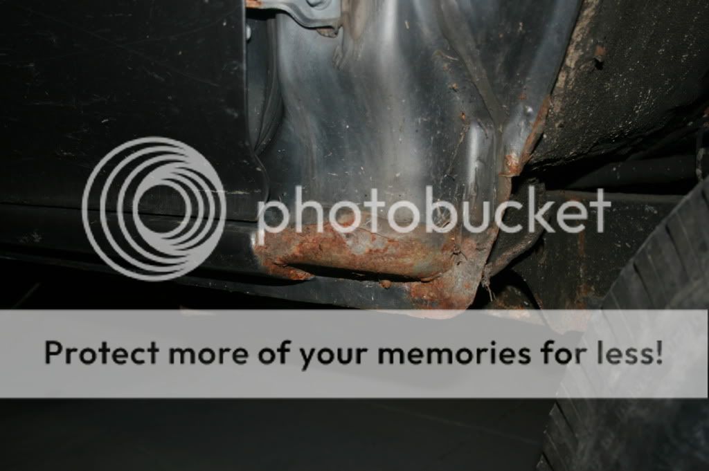

This was hiding under the front fender. It's still pretty solid, so he's just going to clean it up and then sand blast it.

Damn, my garage looks dark as hell. lol
And hot DAMN Wes, that torpedo heater works flippin AWESOME! I turned it on, went back out there 10 mins later, and it was totally comfortable in there! Metal temp was still a little cold, but I can work with it. It just smells like Kerosene out there now. lol
Got the Acetylene today too, so I'm gonna get the rest of the bed bolts out, and then get the side glass' out.
